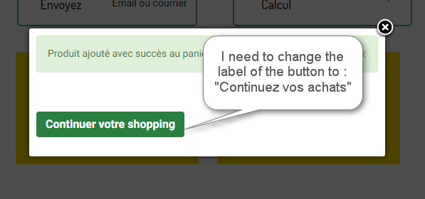

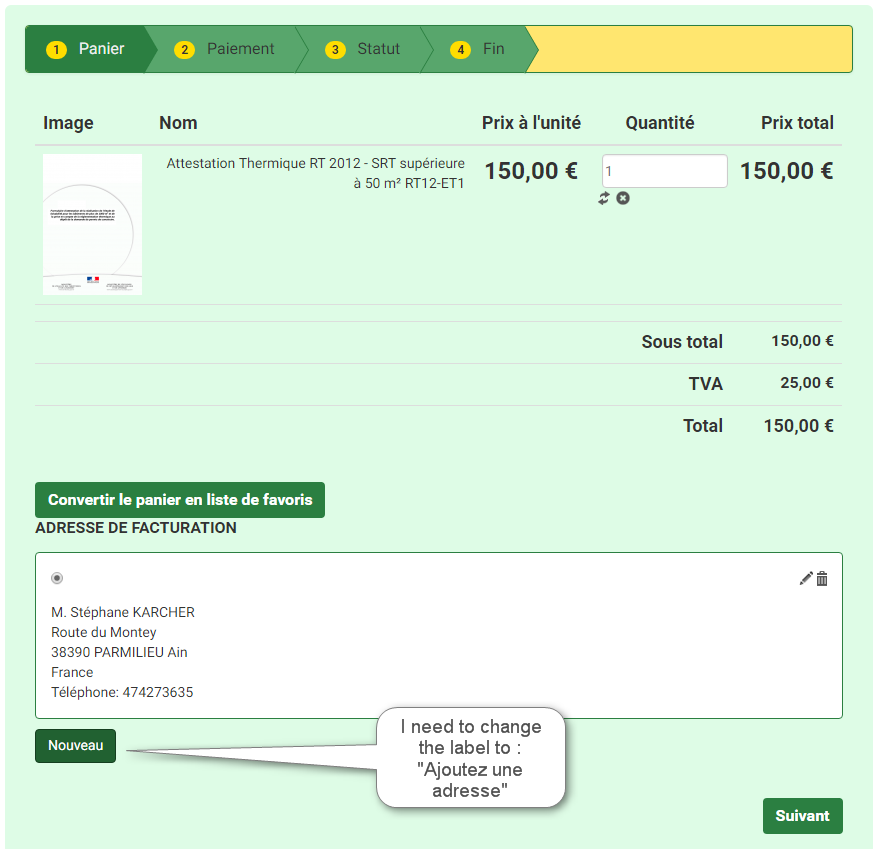

I need to modify two button labels :
1.- Add new address
2.- continue shopping
What files do I need to modify ?
Thanks in advance for your help and advise,
Best regards,
Stéphane

1. As this is a generic text, and you don't want to change the "new" text everywhere in HikaShop, you'll have to edit the file "address_select" via the menu Display>Views and replace the code:
<?php echo JText::_('HIKA_NEW'); ?>
by your text.
2. This is an easy one as you can use the standard translation override system of HikaShop to change that text, like any other text in the HikaShop interface:
  • Posts: 88
9 years 10 months ago #255050
I have tried your solution in replacing the php string by my own text having then :
<a href="....>Nouvelle adresse</a>
"Nouvelle adresse" replacing the php variable, but it does not work.:(
The whole address block disappears...:( when I save the changes the edit windows is totally empty... normal ?
When I reset it to the original, it works again but with the "nouveau" button..
What am I doing wrong ?
thanks for your help and advise
Last edit: 9 years 10 months ago by Jerome. Reason: removing credentials
  • Posts: 86216
  • Thank you received: 14222
9 years 10 months ago #255088
Then you likely have a problem with your hosting server blocking the saving of the view override as a false positive for security reason.
You could instead do the view override through the Joomla template manager:
docs.joomla.org/J3.x:How_to_use_the_Temp...r#Customisation_View
The following user(s) said Thank You: steph3838
  • Posts: 88
9 years 10 months ago #255221
nicolas wrote: Hi,
Nicolas you were right !
A Siteground protection plugin was the faulty one : jHackguard
Just disabled it and all is fine !
Thanks a lot !
