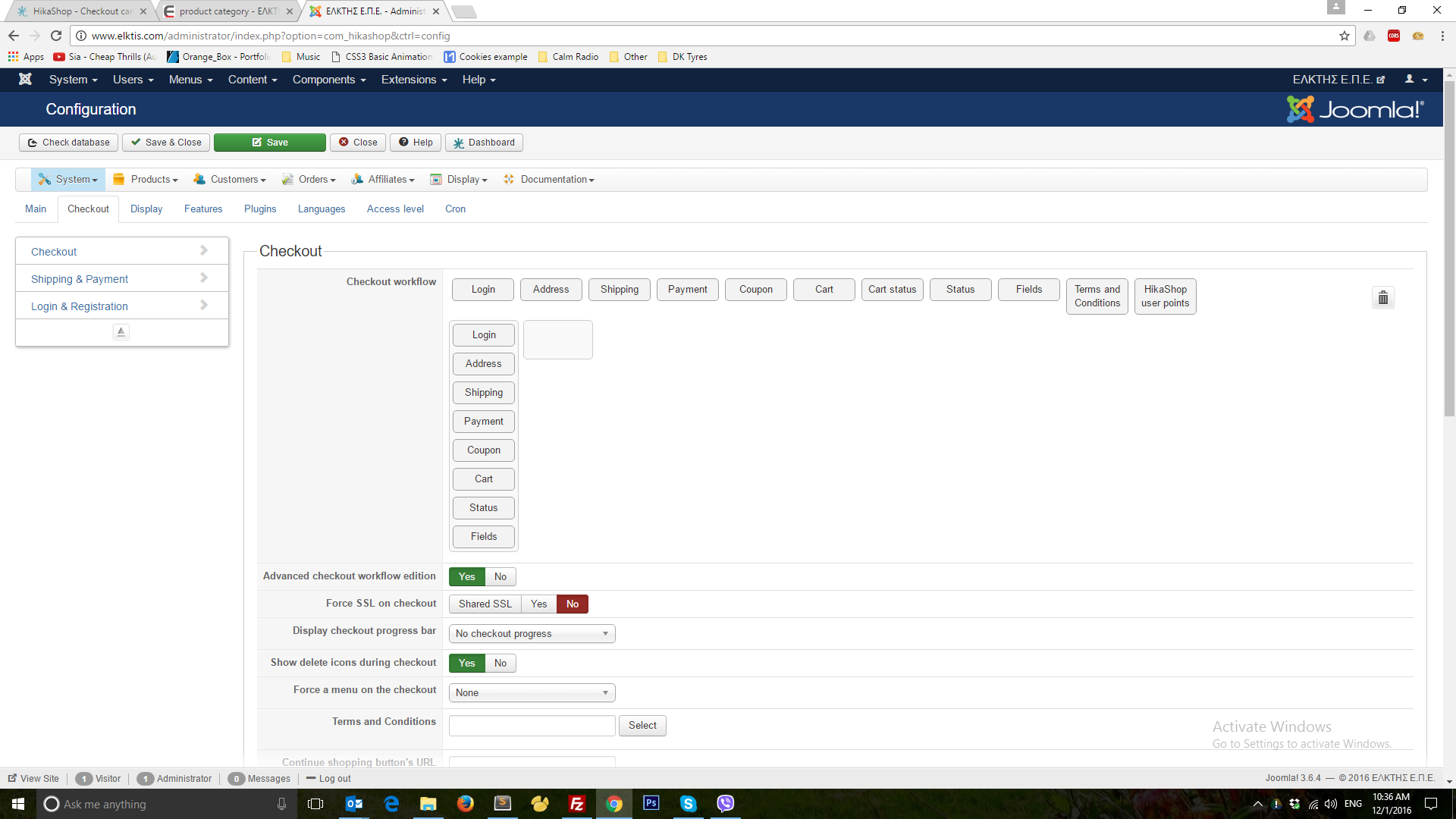

Yes, I realize that I didn't provide link. Here it is: www.elktis.com/en/shop
Also, there is screenshot of checkout settings, as you requested.

Your screenshot only provide some of the settings of that tab. You could provide a screenshot of the rest of the settings ?

I am sending you requested usernames and pass in confidental area. I guess you don't need screenshots of entire checkout settings, since you can see that part now.

So the problem is with your shipping methods. If you don't want any shipping, then remove the "shipping" view from the "checkout workflow" setting of the HikaShop configuration.
