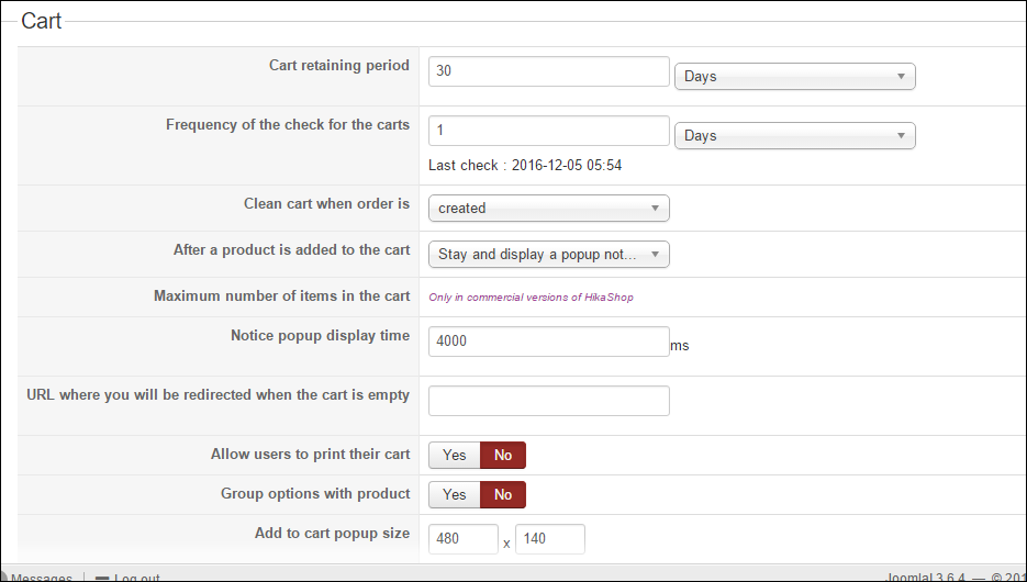

How come my Add to Cart notification is not showing after i click the Add to Cart button?
I already made sure that the setting in the Cart - "After a product is added to the cart " is set to Stay and display a popup notice.

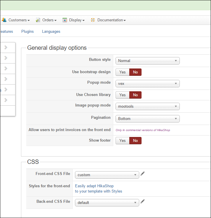

9 years 9 months ago #257070
Hi Mohamed!
I tried to change the Popup mode from mootols to vex, to inherit, to bootstrap but the notification is still not popping up.
