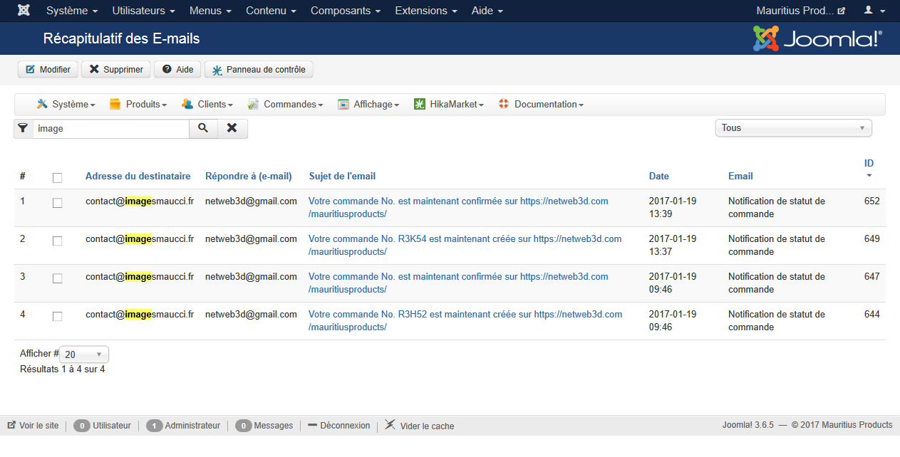

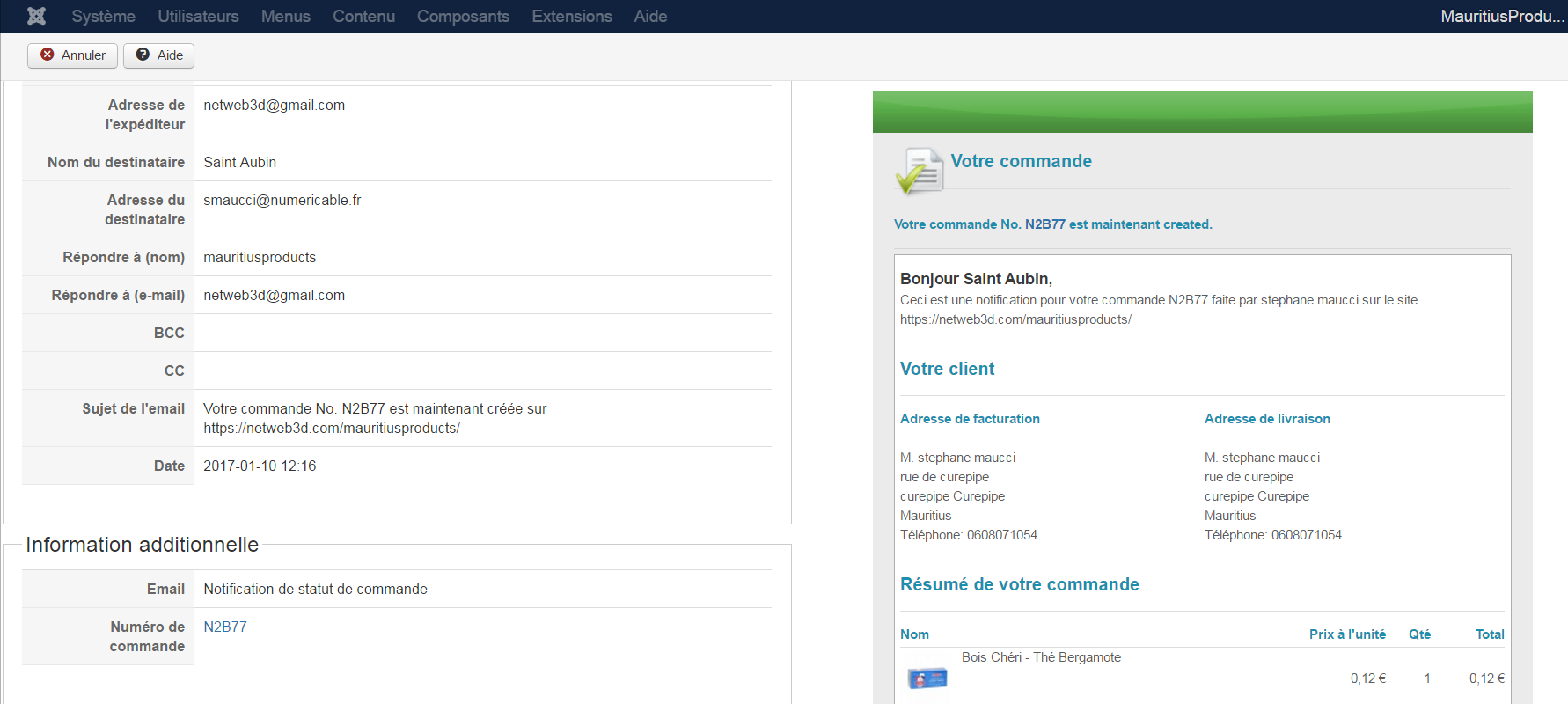

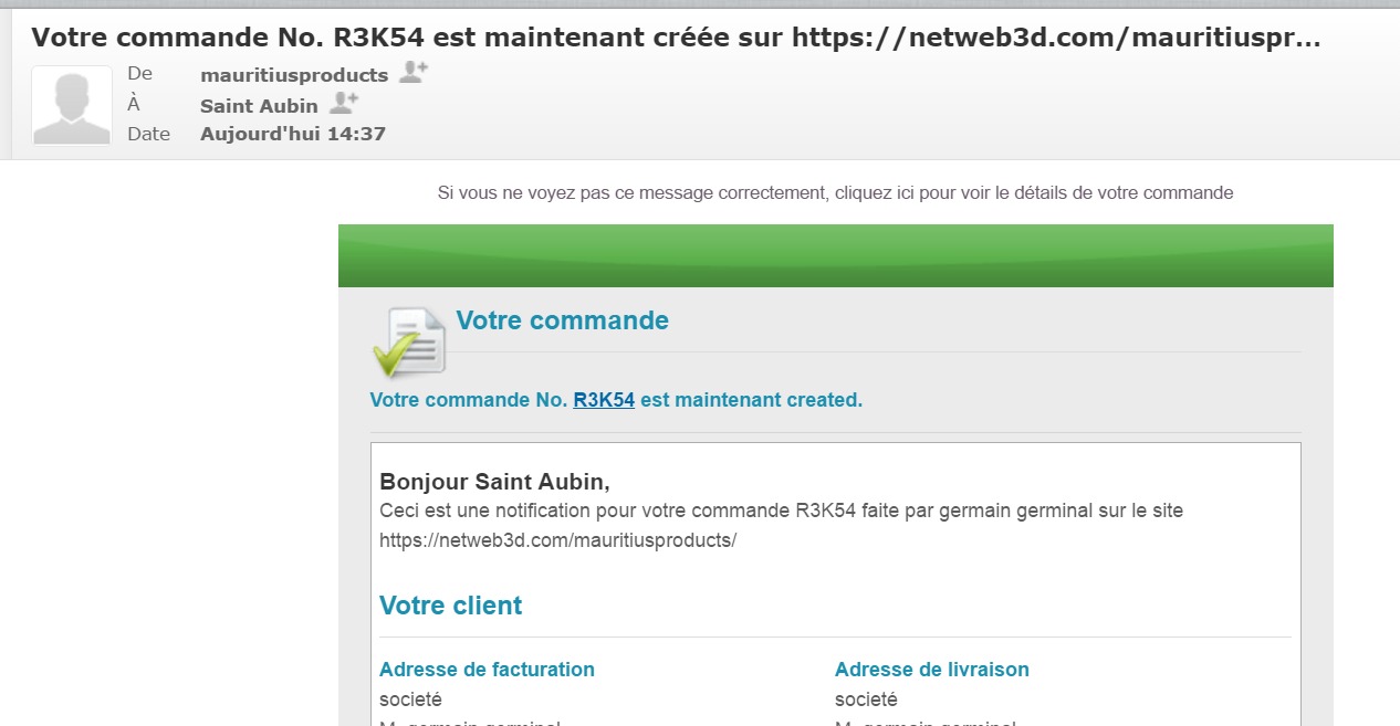

About the notification emails, I have a strange issue with the emails send towards vendor : a mix of french and english words, and order number not displayed (see attached files).
Can you see what is the problem, please ?

It seems that I was not rather clear about the problem : the issues are on emails towards vendor.
In this case, the vendor is ST Aubin, and his email is This email address is being protected from spambots. You need JavaScript enabled to view it. (see attached files).
The problem remains in your tests.

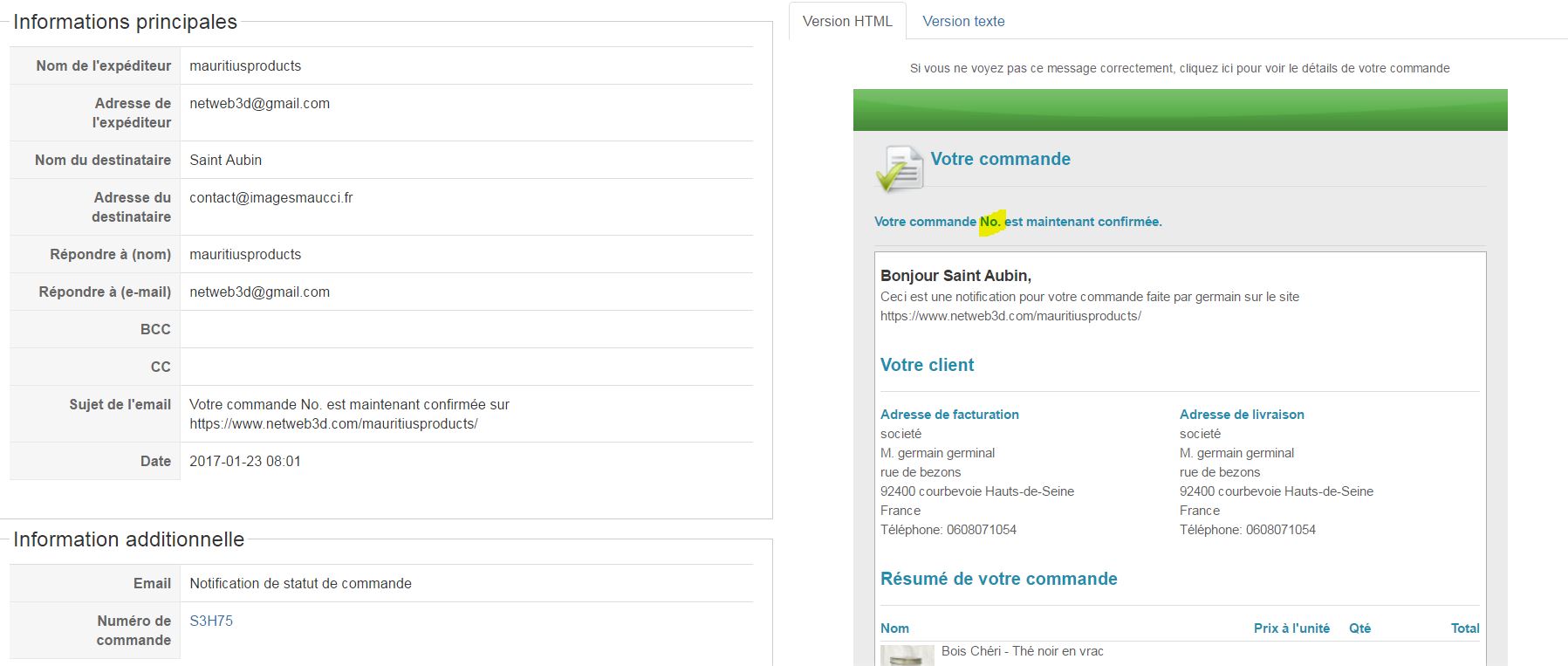

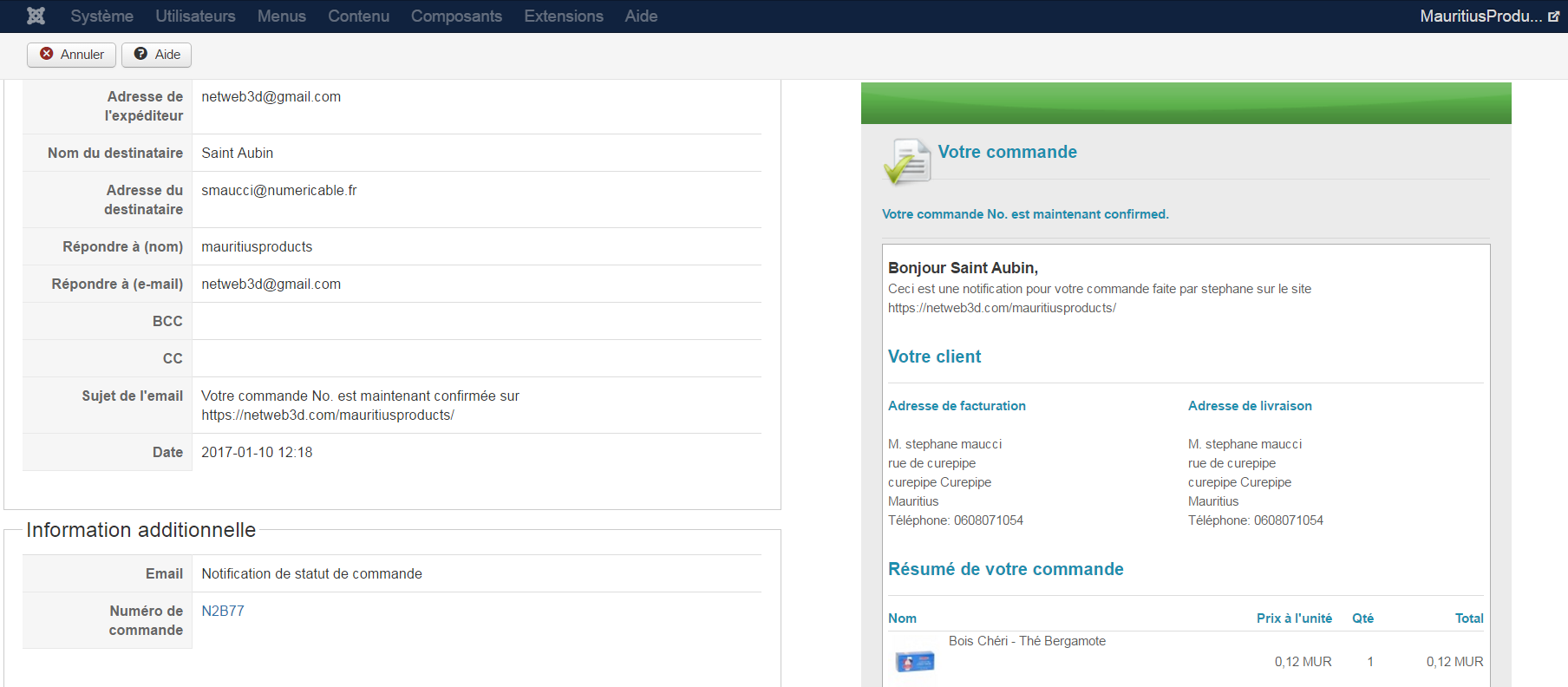

  • Posts: 96
9 years 8 months ago #259939

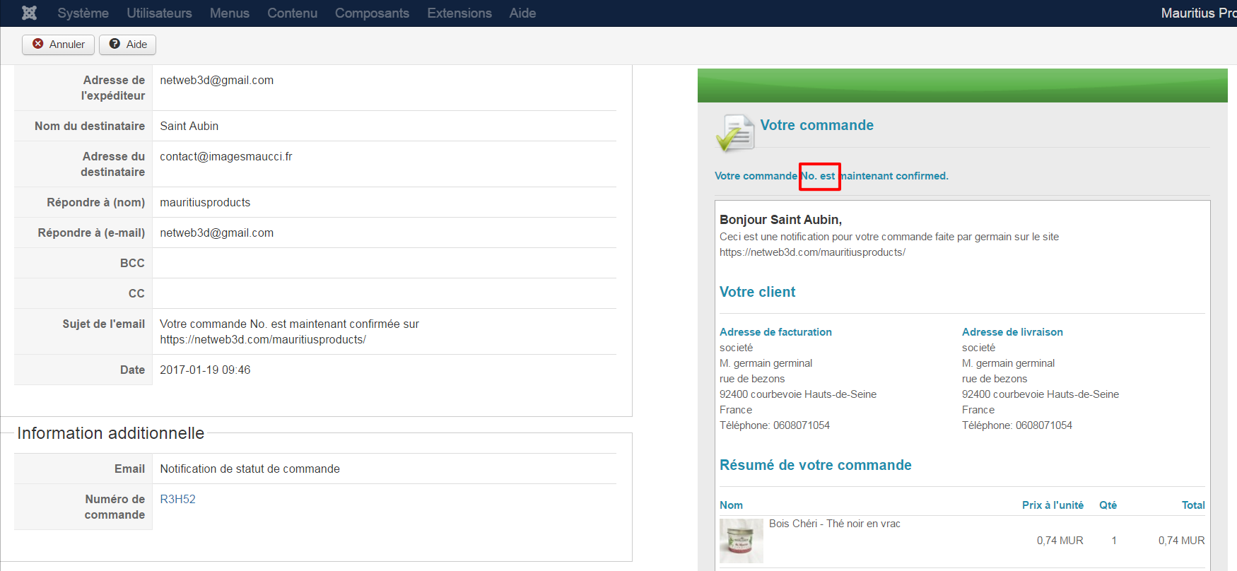

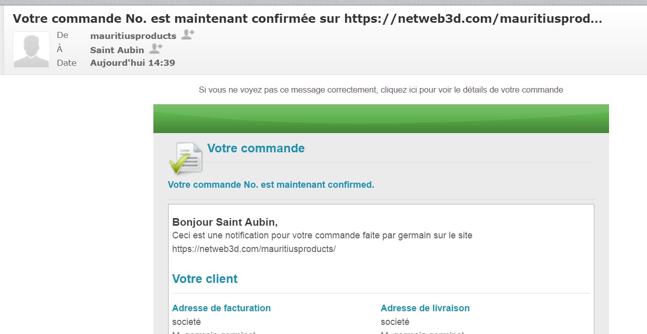

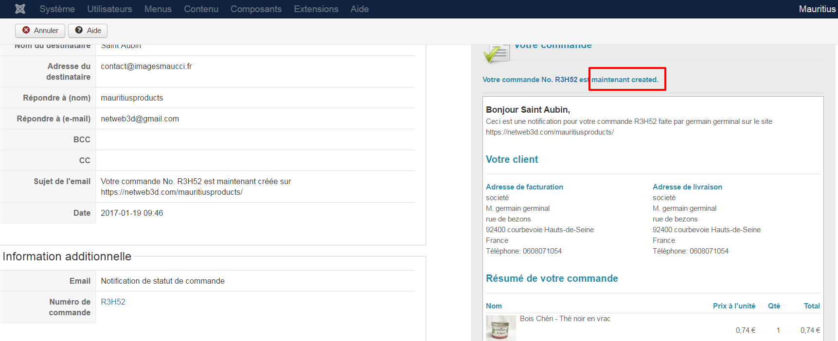

In the "creaded" notification, there is a mix french/english.
More important, in the "confirmed" notification, there isn't the order number (see attached files).
Best regards.

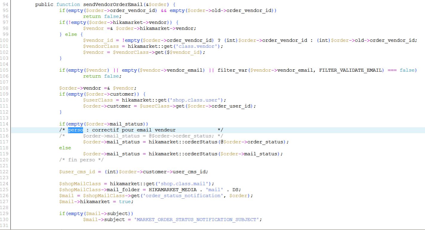

In the file "administrator/components/com_hikamarket/classes/mail.php", please replace
$order->mail_status = @$order->order_status;
By
$order->mail_status = hikamarket::orderStatus(@$order->order_status);
And it will perform the translation of the order status in the mail content.
  • Posts: 96
9 years 8 months ago #259970

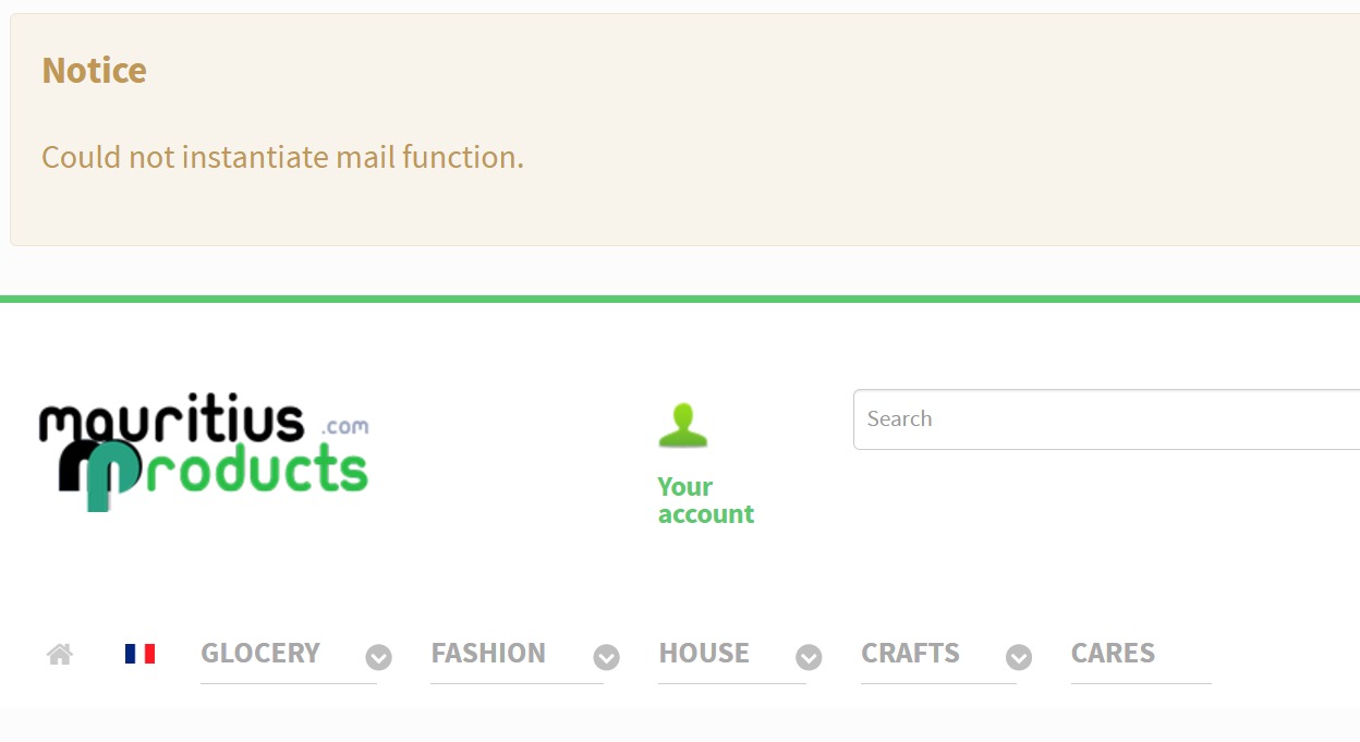

I replaced the code as you said, and the "created" mail is ok, but not the "confirmed" mail.
And the error message "could not instantiate mail function" appears now (see attached file).
So, I don't receive anymore the vendor notifications.
Regards.

I don't see why the confirmed is not handle ; I'll perform some checks.
About the error on the mall function ; I'm afraid that's not related to HikaMarket or HikaShop.
I let you perform some search in that forum and in Internet search engine for more details.

Just after the line you modified previously
Please add that content :
		else
			$order->mail_status = hikamarket::orderStatus($order->mail_status);
And it should translate the mail_status variable that some HikaShop plugin could set.

9 years 8 months ago #260076
I added the lines in mail.php, but same result unfortunately (see attached files).
Regards.
  • Posts: 26387
  • Thank you received: 4078
9 years 8 months ago #260088
As you can see in your email, you right have "confirmée" and not "confirmed", right ?!
  • Posts: 96
9 years 7 months ago #260181
In the "confirmed" email, the order number is always missing.
That is the issue, only on the notification towards Vendor, strangely.
Regards.

It looks like we already have that patch in our side.
In the same file, please modify
		$mail_subject = JText::sprintf($mail->subject, $order->order_number, $order->mail_status, HIKASHOP_LIVE);
to
		$order_number = isset($order->order_number) ? $order->order_number : @$order->old->order_number;
		$mail_subject = JText::sprintf($mail->subject, $order_number, $order->mail_status, HIKASHOP_LIVE);

  • Posts: 96
9 years 7 months ago #260249
It's better ! The order number appears now in Email subject.
It don't appears in email body, but it's ok for me now.
I let you fix this in the next release.
I thank you very much for your help.
