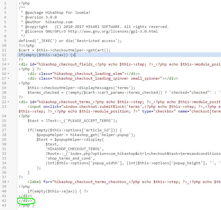

  • Posts: 9
9 years 7 months ago #261566
if step 3 is complited terms and conditions, then try add tag </div> in block: checkout / show_block_terms.php. He probably missed?

  • Posts: 86187
9 years 7 months ago #261563
This would indicate a missing </div> at the end of one of the view files.
It could be by default in HikaShop, but then everyone else would have the same problem, or it could be caused by a view override.
Try renaming the folder templates/YOUR_TEMPLATE/html/com_hikashop to something else in order to use the default view files of HikaShop. If you don't have the problem, then you need to investigate the view files in that folder in order to understand which one has a missing </div> tag. I would guess the product/show_default.php or another one from the product folder and one from the checkout folder.
The following user(s) said Thank You: mei

9 years 7 months ago #262544
I had only set up a product view and i removed that. That solved the problem with the sidebar. It didn't solve the checkout problem (and i hadnt added a layout for that).Bvltl was correct that a div was missing in the show_block_terms.php view. i added it and created a copy in my template.
In addition, i added css to auto resize the image, since the image was not resizing automatically despite the responsive template.
Thanks for your help!
