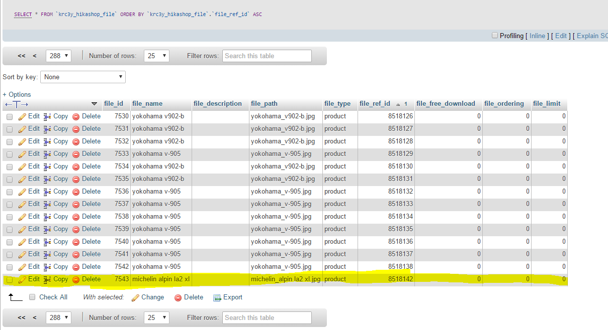

From what I can see in your PDF, there is a problem with the hikashop_file table in your database.
The MySQL queries on that table take 1 to 6 seconds each even though the queries are fairly normal and should only take a few milliseconds.
So either you have hundred of thousands (or millions) of entries in there, or there is a problem with the structure of that table.
Could you open it with your PHPMyAdmin and provide a screenshot of its structure and tell us how many entries you have in it ?

i dont know how but there are more then 3 million entries in the database table.
i have noticed that with each time the cron job does his work, the table gets filled with fields.
for example : It says 1700 entries, with just 400 products in hikashop after i deleted everything.
The CSV with 7000+ fields should insert the products and if the product exists he should update the products.

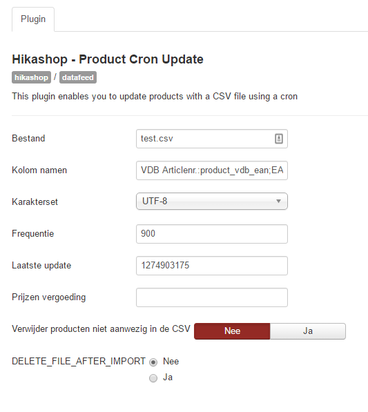

So if I understand correctly, you're using the HikaShop Product Cron Update plugin in order to import your CSV, is that right ?

Could you look at the data in that hikashop_file table ?
What is wrong with the entries there ?
Do you have a lot of entries for each product ? Or maybe most of the entries are for product_ids that don't exist (in the column file_ref_id) ? Maybe something else ?
As a quick fix, I suppose you could just empty the whole table in PHPMyAdmin before running the import of your CSV once. That should fix the problem temporarily, until the images entries gets added back in the table little by little.

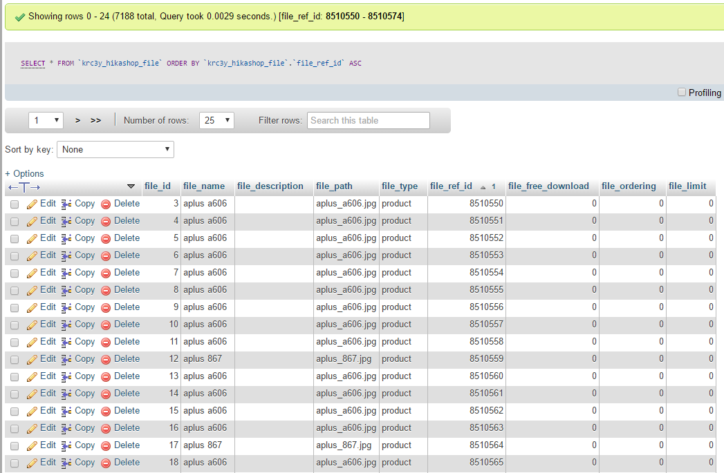

Oke i have made some printscreens from the file table, which now looks normal. No double items ( if i sort and check the file_id field )
Even if i load a test csv file manually to hikashop it works fine as well..
I also have the same test file added as cron job to check it.
It was succesfull but no extra entry was added, so that is good.

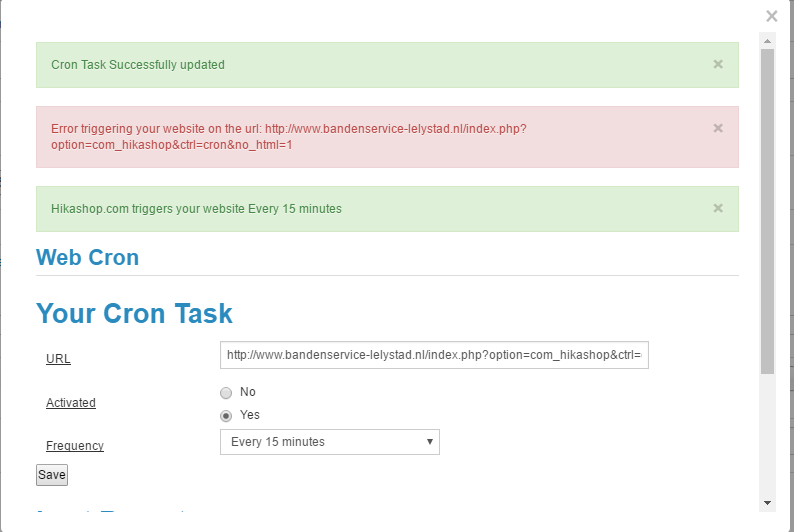

The cron job says something like : exchance course updated. ?? here is the example in dutch :
HikaShop Uitgevoerd op 2017-01-30 22:44 ( hikashop triggered at 2017 ... )
Wisselkoersen succesvol bijgewerkt (exchance course succesfull updated. )
I have added alot of usefull printscreens.
Kevin

Then maybe the data in there was some old data and it wasn't caused by the import but something else. Otherwise, the problem would have continued after clearing the table and increase the amount of entries by 7K on each CSV import.
Thus, it means that it fixed for good on your website.

Can you provide a full copy of the CSV file and the full text you have in the "column name" setting of the plugin ?
You can send these to contact AT hikashop DOT com so that we can look at it.
  • Posts: 30
9 years 7 months ago #261524
I have send the mail to contact AT hikashop dot com.
