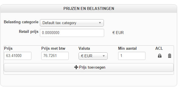

Hello i have a problem.
All products are displayed without tax in my shop.
In the checkout there is tax displayed.
Only products with characteristics are not showing tax in the checkout.
Can anyone help me? Thanks.

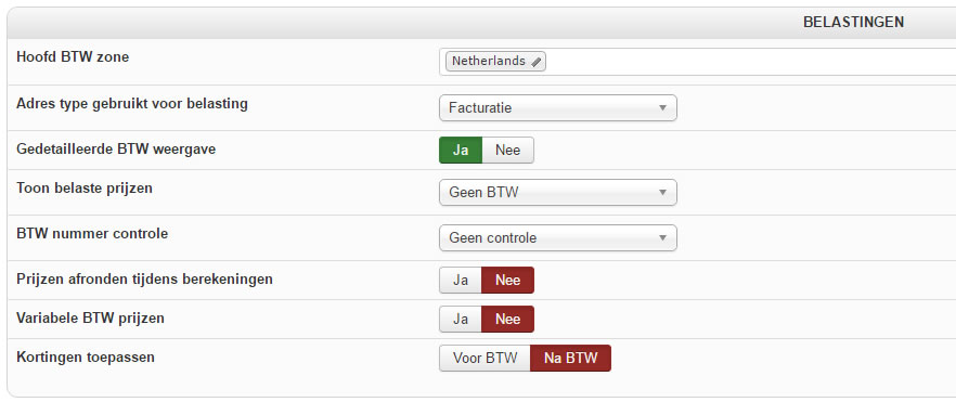

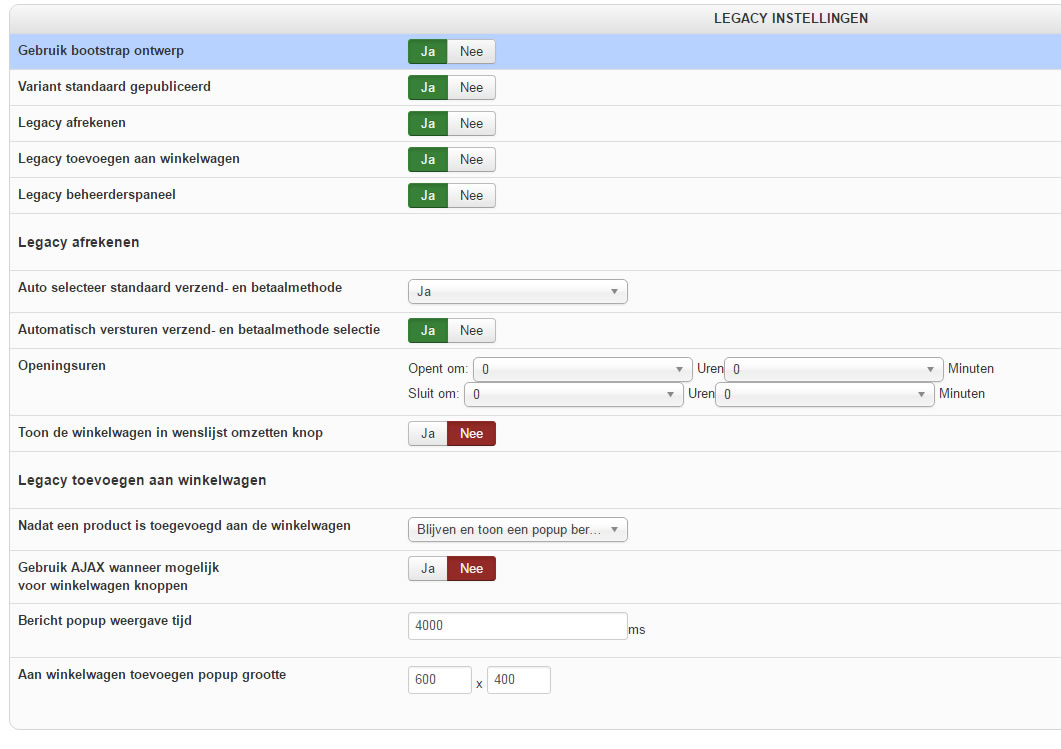

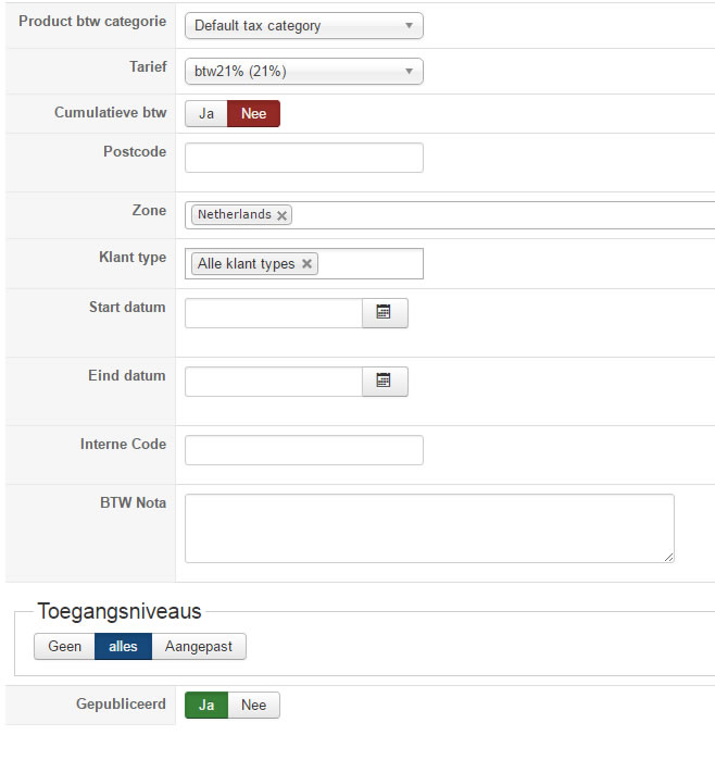

Regarding your displaying issue, would it be possible to have screenshots about your HikaShop tax configuration and about your advanced/legacy settings ?

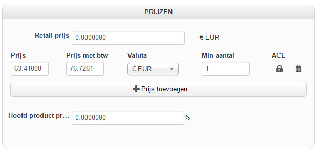

Thanks for you reaction.
I use joomla 3.6.5, php version 5.6.29-1~dotdeb+7.1, webserver apache2handler
link to product: www.mag-tech.nl/winkelstellingen/product...-1400-1000-370-h-b-d
Wenn i have a product he is showing tax in the checkout.
Wenn i have a product with two variants he is also showing tax in the checkout.
Wenn i have a product with two variants and two different prices he not showing tax in the checkout?
Greetings Bjorn

  • Posts: 7
9 years 7 months ago #261630
Yes it is like this on all products.
When i make a new product also.
product with tax , variants with tax , variants with prices no tax.
Bjorn
