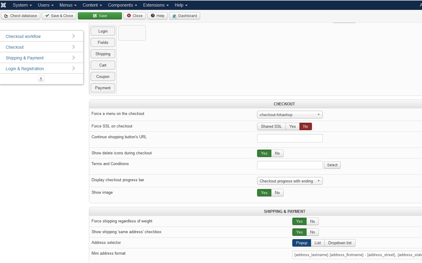

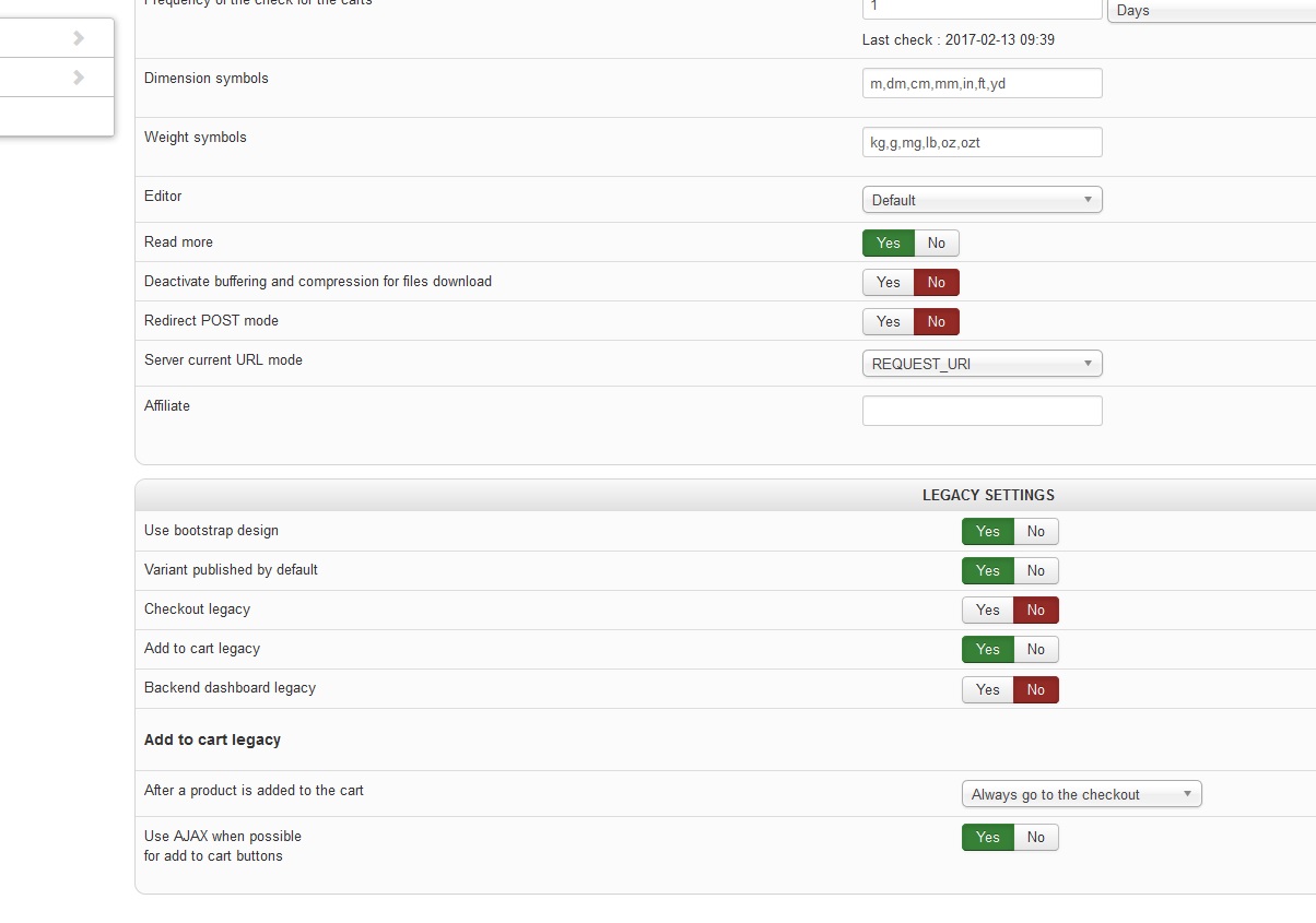

My "Force a menu on the checkout" menu which is a hidden menu doesn't work unless I put the
"Checkout legacy" Button to Yes then the force to menu button works. With "checkout Legacy" option set to YES it creates a new and even larger problem which is it doesn't allow a user to input any credit card info as there is no display box shown to get users Credit info, and they are at a dead end with no way to checkout. When I put the "Checkout Legacy" button back to NO then my force to menu doesnt work but they are allowed to input CC and still make purchase.
So currently I am stuck without a way to "force a menu on checkout" which makes my checkout page look very busy messy and quite confusing with tons of extra modules that arent needed or wanted. Please help me figure out a solution for this. Thanks!

There is no reason that an hidden menu won't work for the checkout forced menu ; I have an hidden menu in my local website and it's working just fine.
Please provide more details about your configuration and your HikaShop 3.0 build number.

It only seems to work for me when checkout legacy is turned on see first post for more info on that. I attached a image of my settings pertaining to force checkout, maybe you can see something I cant.
  • Posts: 26387
  • Thank you received: 4078
9 years 7 months ago #262364
See : www.hikashop.com/support/documentation/5...onfig.html#main_main
We need to be sure that you really have the latest version correctly installed in your website.
Because your template is stripping/compacting the HTML ; it is not possible to check it manually in the front-end, so only the backend will tell us that.
