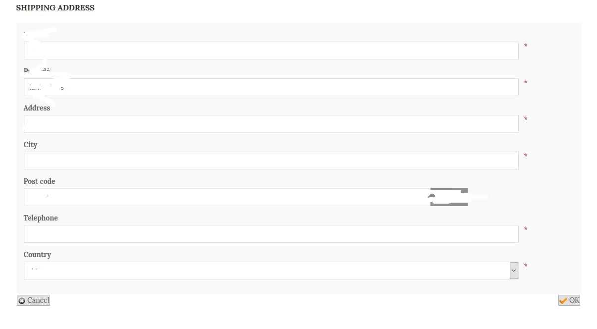

  • Posts: 1119
  • Thank you received: 114
9 years 7 months ago #262846
Nicolas if you check address where you create new address during new checkout you will see that "<span class="hikashop_field_required">*</span>" is added after input and not after label. I think this is what topic author is asking about. I have attched screenshot.
Last edit: 9 years 7 months ago by kyratn.
  • Posts: 86216
  • Thank you received: 14222
9 years 7 months ago #262873
Thank you for pointing that out. That's something we forgot to change there.
It's actually pretty easy to change from one display to the other for the required star with the new system.
I've made the corrections for that and updated the install package on our end with the changes.
The modifications should appear in a few hours on our demo website too.

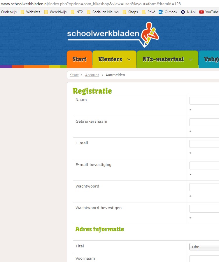

  • Posts: 18
9 years 3 months ago #271161
I'am struggeling with the same issue.
How do I place the asterix after the label?
(HikaShop Starter: 3.1.1)

  • Posts: 18
9 years 3 months ago #271288
No, all "Legacy Settings" are disabled.
Asterixs are still displayed after input and not after label.

  • Posts: 18
9 years 3 months ago #271435
I use the Hikashop Registration Form.
In this form the asteriks follow the input field. I would like them after the label. Now the rows are unnessesary high.
I hope the screenshot will help.
  • Posts: 86216
9 years 3 months ago #271467
That's why.
This subject was about the display of the asterisk on the checkout.
On the registration page, it still uses the old views of HikaShop 2 and thus the asterisk are still placed after the inputs.
Changing that would require modifying the code of the files of the view "user" via the menu Display>Views.
I'm sorry but I don't have an easy solution for that for now.
We have on our todo list to do the changes on that view too in a future release so if you can wait, it will be handled in a future update of HikaShop.
