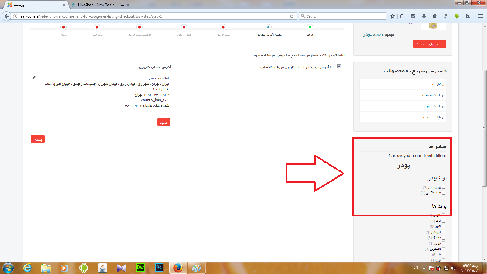

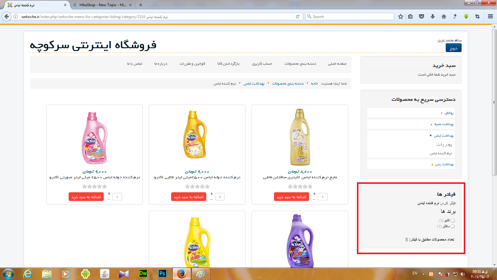

i have assigned a module to product category listing menu , but when i want proceed to check out it shows that module there too. what should i do.
  • Posts: 26387
  • Thank you received: 4078
9 years 6 months ago #263484
If you take a look at your URL, you'll see that you're using the same Joomla menu for your checkout.
You need to create a dedicated menu for the checkout and use the HikaShop setting to force the checkout on that menu.
