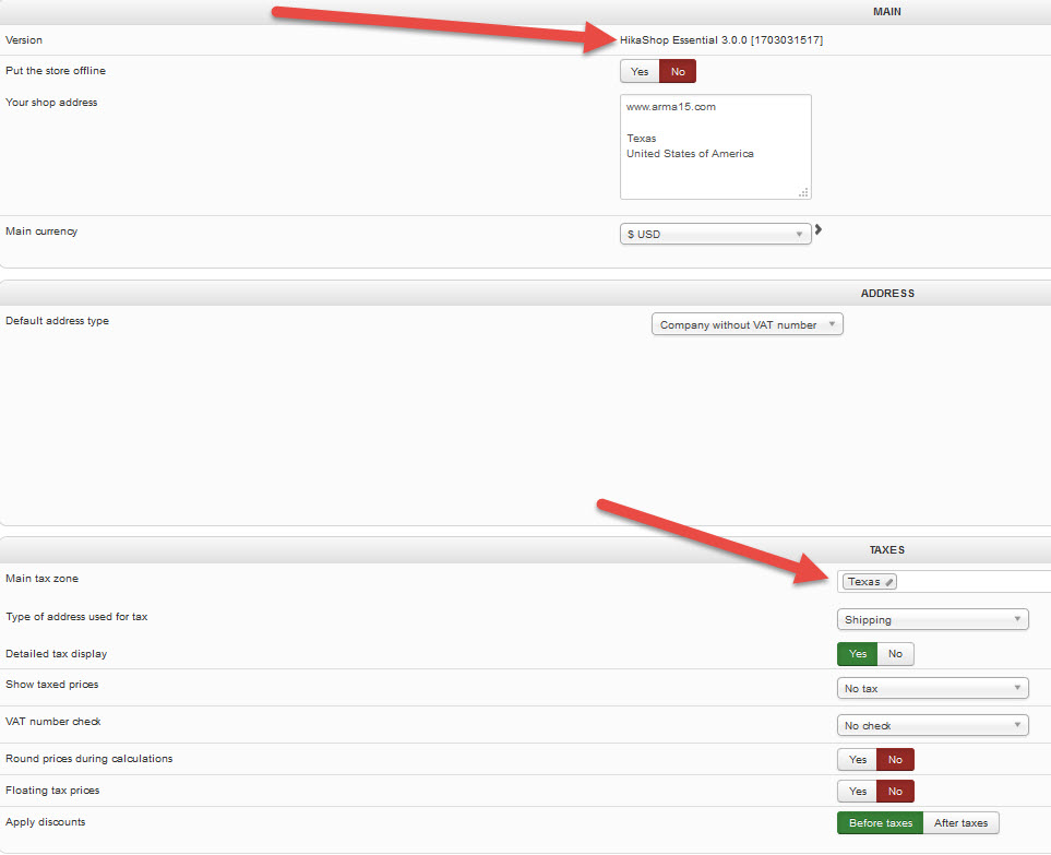

9 years 6 months ago #264061
Have the latest build. See Screenshot for build number.

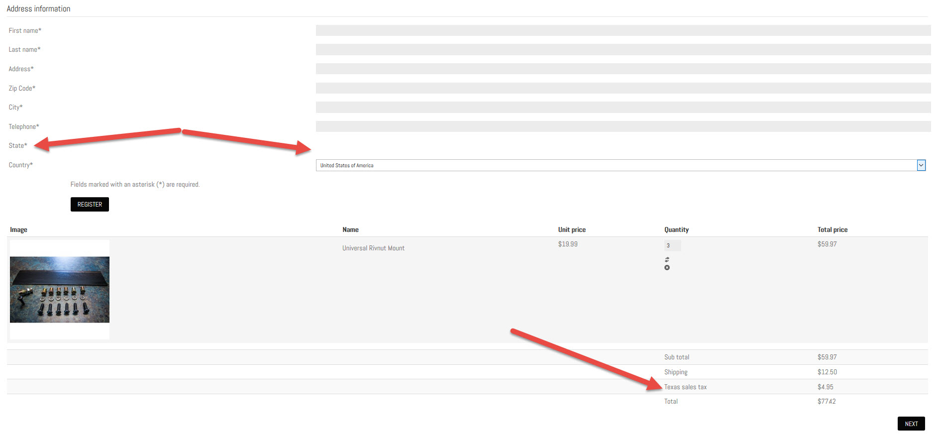

Problems I have:
1. Still gives me a "blank" for state. No ability to select
2. Charges State Sales Tax Automatically before state is entered.
See screen shots:
  • Posts: 92
9 years 6 months ago #264066
Tried Changing the Tax zone to United States to see if it would fix anything... With no luck.

9 years 6 months ago #264069
As usual, you unpublished all countries but you did not re-save your "country" address custom field in order to store the default country in the database.
So the "state" field is trying to display states for a country which is currently unpublished.
You have to edit your "country" address custom field and just save it.
