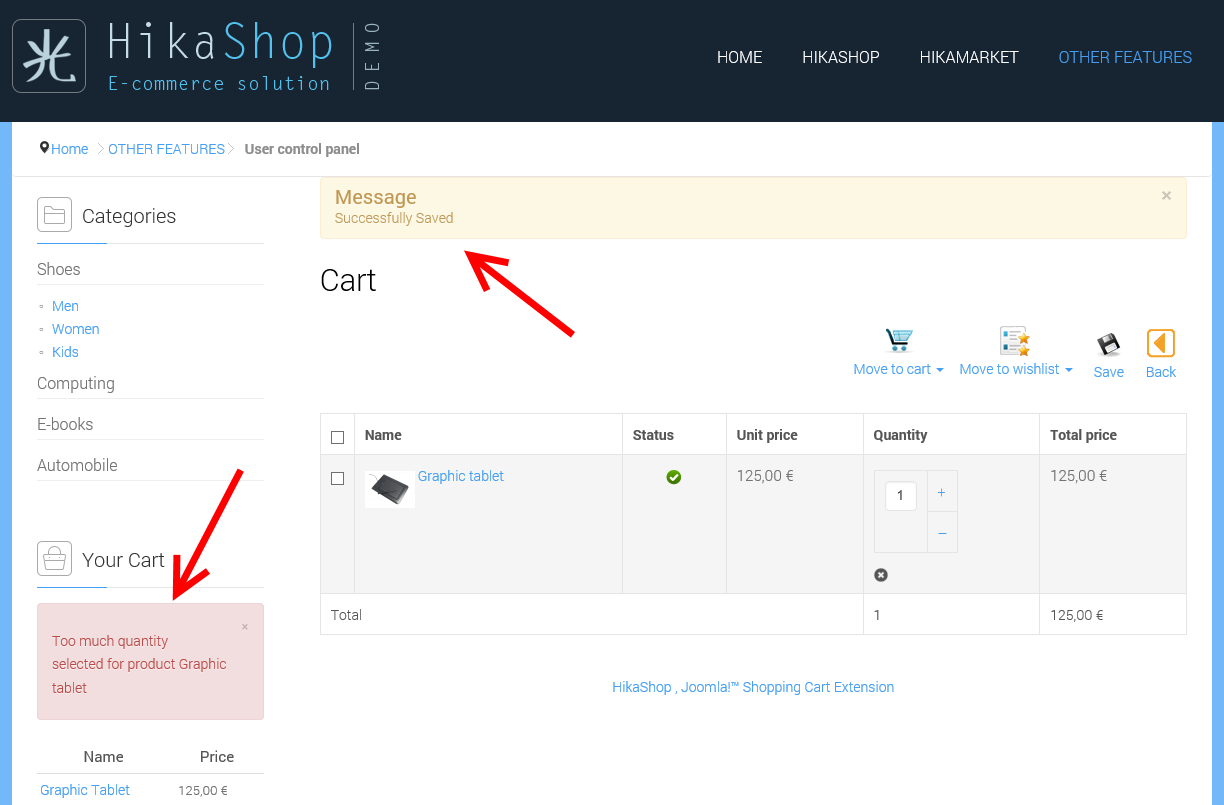

we see slightly strange behaviour in Hikashop 3 on the show cart page when we try to change the quantity of a product to a value higher than is in stock. We still get a "Successfully Saved" system message even though nothing is saved, and the "too much quantity selected" error message actually appears in the cart module.
It also happens on the demo page, see attached screenshot. That is what appears after entering a value higher than is in stock and clicking on save. Can this perhaps be fixed so the "too much quantity" error message appears as a system message at the top of the page?

To get to the issue we describe on the demo page:
1. Add the graphic tablet to cart (it has limited stock of 9)
2. Go to cart page through user control panel -> Show the carts -> click on our cart
3. Then on the cart page enter a quantity higher than 9 in the product quantity field
4. Click Save
5. The page reloads giving a system message "Succesfully Saved" and an error message down in the cart module saying "Too much quantity selected for product Graphic tablet", as shown in the screenshot in our first post.
The main problem is that the "Too much quantity" error message appears in the cart module.
If, as was in our case, you don't have a cart module showing on the cart page then the user won't see this message at all. All the user will see is the "Succesfully Saved" system message, but nothing is saved and the product quantity isn't modified because it was too high, so this will be quite confusing to the user.
9 years 6 months ago #264281
