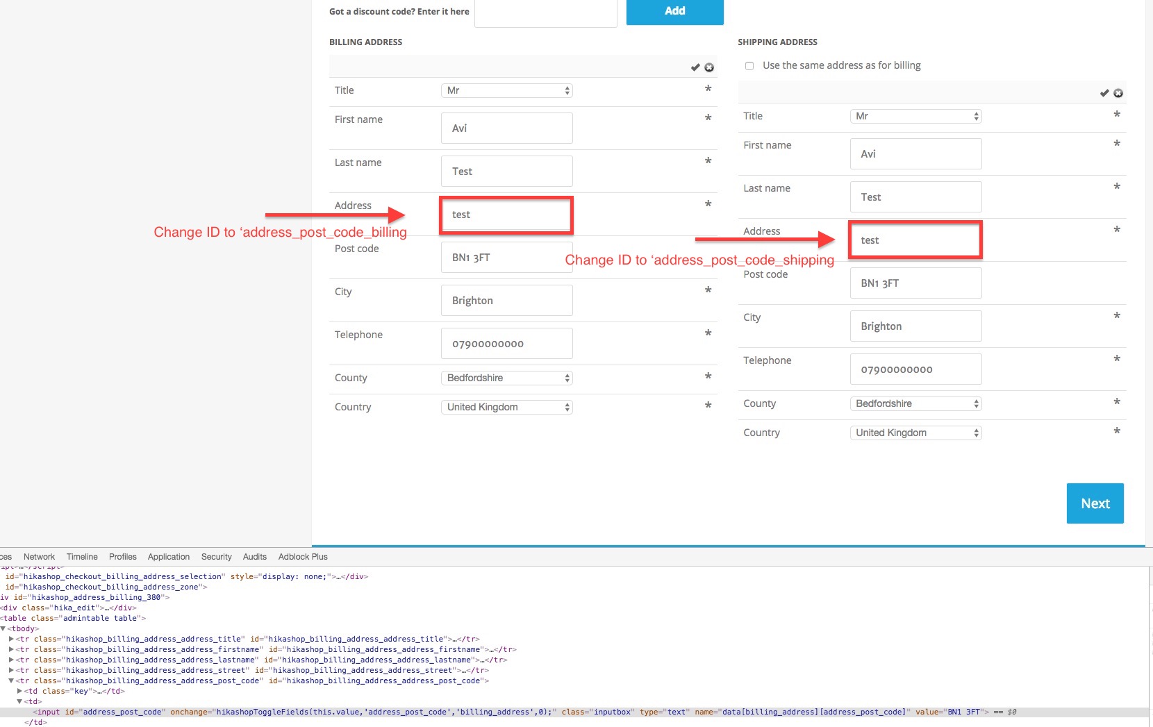

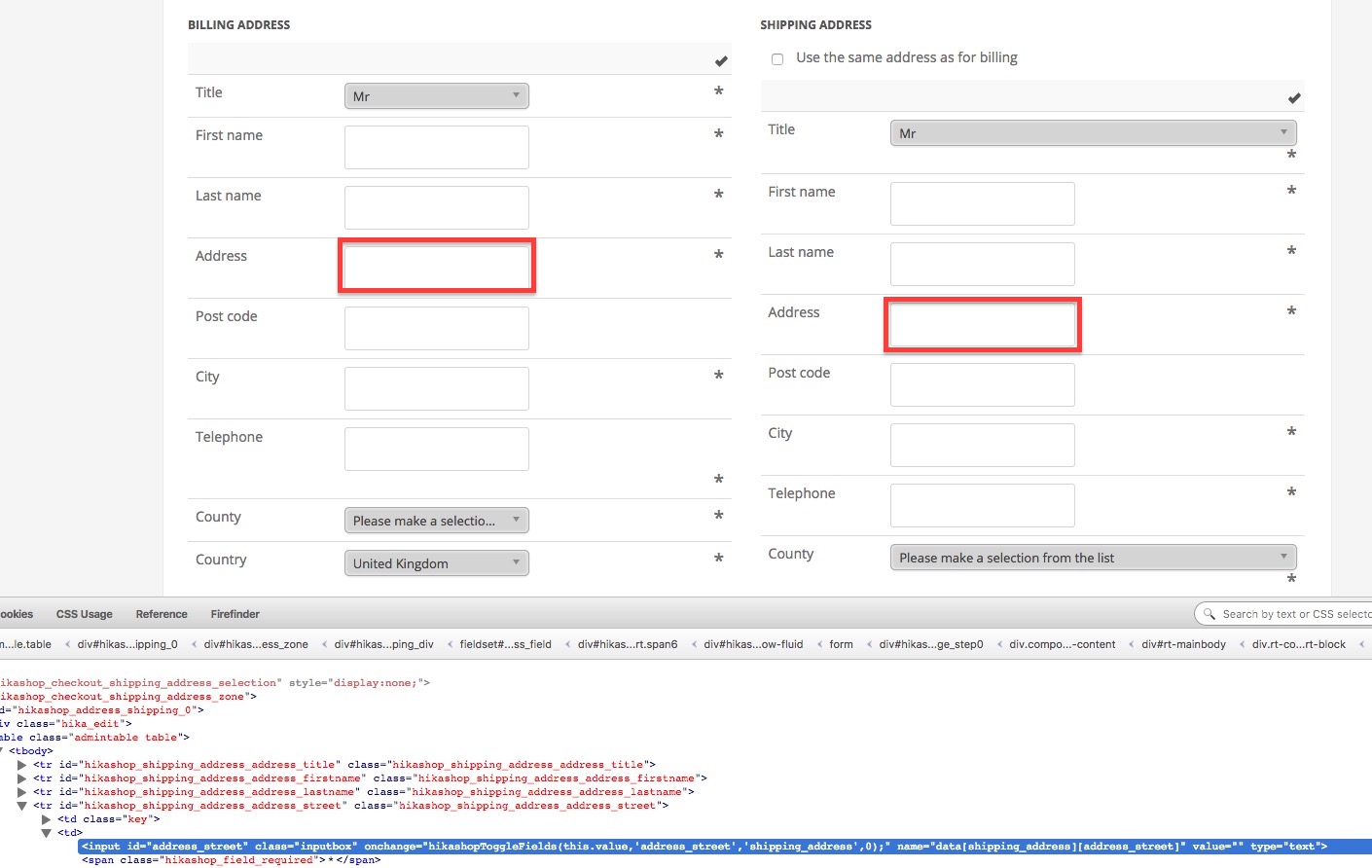

Hey,
At the moment both billing and shipping address are using the same ID :
Both IDs are called 'address_street' - Is there a way to change the ID of the Billing Address fields?
This is not for CSS purposes. I know that for CSS I can use
hikashop_shipping_address_address_street td input#address_street
Ideas?

  • Posts: 57
9 years 6 months ago #264627
Hey Nicolas,
Thanks for your reply.
I have switched off legacy but don't understand how it solved the problem... Input fields still have same ID name...
Regarding the str_replace on the code - can you please give an example?
Avi

  • Posts: 57
9 years 6 months ago #264715
Hey Nicolas
I think maybe I'm not explaining myself correctly.
I need the input ID to be different for billing and shipping.
Ideas?
