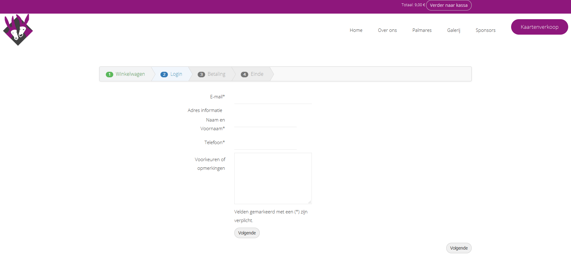

  • Posts: 8
8 years 6 months ago #289416
Dag Joris
Ik ervaar hetzelfde als u. Op www.langhoirs.be/kaartenverkoop heb ik ook 2 knoppen met volgende.
Mag ik vragen hoe u dit probleem hebt opgelost? Ik had graag de bovenste volgende knop weg gezien.
Ik heb een printscreen toegevoegd om te weten wat ik bedoel.
Alvast bedankt voor uw hulp.

8 years 6 months ago #289431
II think they would like english here ;-)
In your situation you can get one of the buttons on the class of that login step.
On everystep there is added a class to the div above it.
.hikashop_checkout_page_step2 and the class of the button you want to remove.
Does this make sense for you?

  • Posts: 8
8 years 6 months ago #289435
I see that there indeed is a class to it. The solution that you had to add display: none to the css is a very good solution. However I cannot find how and where to add this CSS to make this button disappear.

  • Posts: 8
8 years 6 months ago #289453
Hi Joris
Thanks for this! It worked out perfectly.
I just added some css code to the custom css of the template.
Many thx for this
