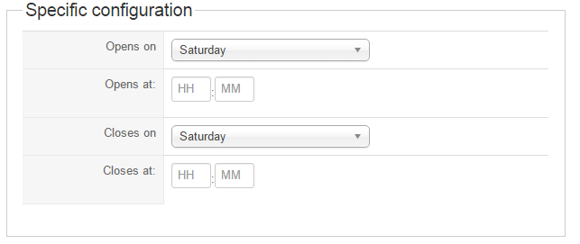

I noticed another thing. When I reopen an existing day, the hours field is blank. See attached a pic.

9 years 5 months ago #267399
I'm not able to reproduce that, neither on my end, nor on your website:
monosnap.com/file/fZPtfjCrFGSCHuU0hQHmo6Co1zRoes
  • Posts: 31
9 years 5 months ago #267441
HI,
I see, interessting. I have a copy of that site offline for development. There I experience this issue. Any idea what it could be?
  • Posts: 26387
  • Thank you received: 4078
9 years 5 months ago #267480
You can activate the Joomla debug mode in your offline website ; it will allow you to see the SQL queries made for the page loading.
The plugin should load the configuration from the database and if you see the fields empty, it means that there is an issue with the loading of the data.
But because we are not able to reproduce, it will be difficult for us to give you more indication on where the problem would be.
  • Posts: 31
9 years 5 months ago #267540
I have been trying around a bit.
Online, on the side you have access to, this is a complete new setup of joomla and hikashop 3.0.1.
When I do an update of an f.e. 2.6.4 HIkasShop installation to 3.0.1 and I configure an Opening Hours Plugin.
I will see the entry in HikaShop when I go to Plugins, but in _hikashop_plugin, the table is empty. So this explains to me why I won't see any time when I open up the entry.
You have any idea why this could happen?
PS: I have add an entry by hand in _hikashop_plugin, but it won't show up in Plugins on Hikashop

  • Posts: 86216
  • Thank you received: 14222
9 years 5 months ago #267555
I don't see how you could have something on the listing of the plugins in the menu System>Plugins with the hikashop_plugin table empty. I'm not able to reproduce and looking at the code I don't see how that could happen.
If you configure an entry in the menu System>Plugins, then you should see it there after your save & close it, and it should be stored there.
Note however that the plugin will only work with the new checkout of HikaShop 3. So the checkout legacy setting, which is turned on by default when you update from a 2.6.x, has to be turned off.
