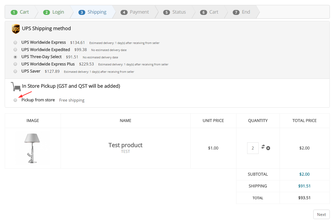

If you check attached screenshot, the behavior I am expecting is like this:
Customer is logged in with let's say US shipping address. If customer chooses UPS shipping method, the cart should look as on the image, however if customer switches to In Store Pickup option, GST and QST taxes have to appear in the cart and the Total has to be recalculated.
Is there a way to do this?

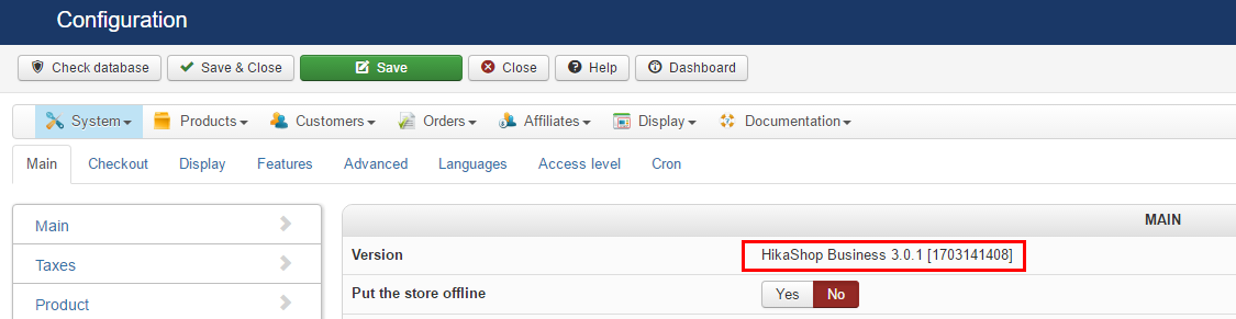

My customer just purchased Joomla template from bdthemes.com that contains Hikashop Business 3.0.1 [1703141408]
How can I get your fixes into this build?
Thanks.
Best regards,
B.G.

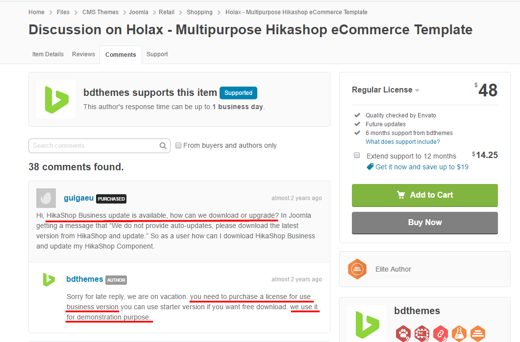

  • Posts: 39
9 years 5 months ago #268035
Hi Jerome,
It looks like Holax template from BDThemes contains Hikashop business in holax_quickstart_j365.zip file. The reason I am saying this is on attached image.
As for the note I was referring to in the previous post - here it is themeforest.net/item/holax-multipurpose-...te/11566009/comments
My initial understanding of these posts was that customer purchased the template, it came with business edition and he is asking how to upgrade it to the latest version. However, after re-reading these messages few more times I am not so certain anymore.
You may want to make a test purchase from them and check yourself.
