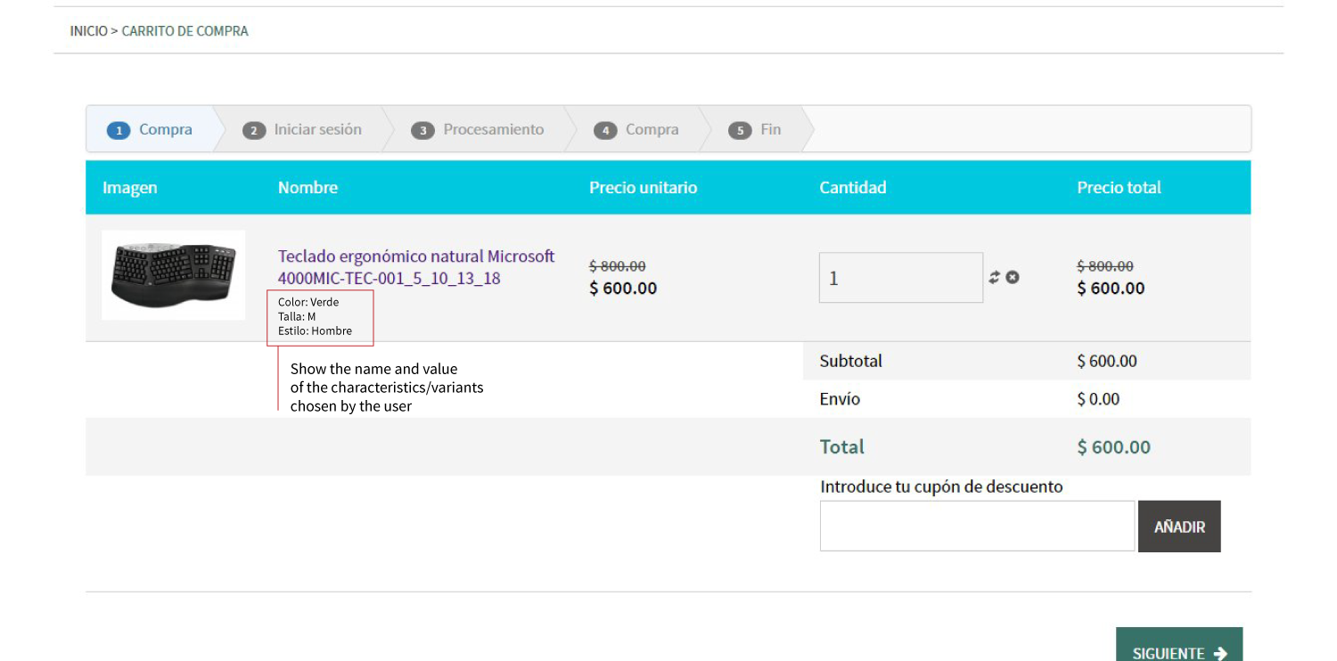

Greetings, Currently I'm in the process of building an online store and my client wants that in the checkout table, the name and the value of the characteristics/variants appears as a list and not in the title.
Currently, the variants appear like this:
PRODUCT 01: GREEN XL Men
And what the client wants is something like this:
PRODUCT 01
PRODUCT 01
- Color: Green
- Size: XL
- Style: Men

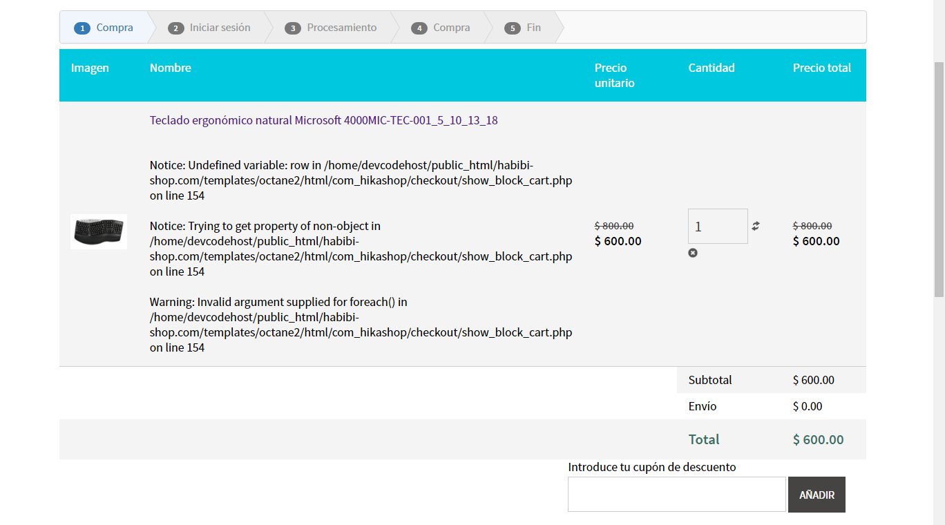

I'm adding a screenshot of what I'm trying to do. Basically each product in the cart table of the checkout page has to show details of the characteristics/variants chosen by the user in a list format or something similar.
i tried to use the following code suggested by thewebtailors in the checkout / show_block_cart.php view

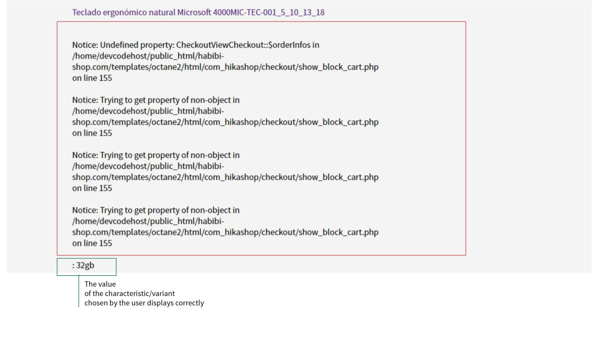

But after reloading the page the following message appears:
However if I change this line:
to
The values of the characteristic appears but not their name, instead I get this message.

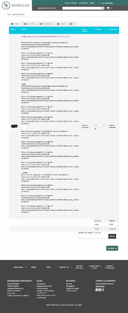

This message repeats itself depending of the number of variants of a product. So the full page looks like this:

<?php foreach($row->characteristics as $characteristic){
echo "<br /><span class='characteristic'>".$this->orderInfos->products[$i-1]->characteristics[$characteristic->characteristic_parent_id]->characteristic_value.": ".$characteristic->characteristic_value."</span>";
Code:
to
Code:
foreach($product->characteristics as $characteristic)

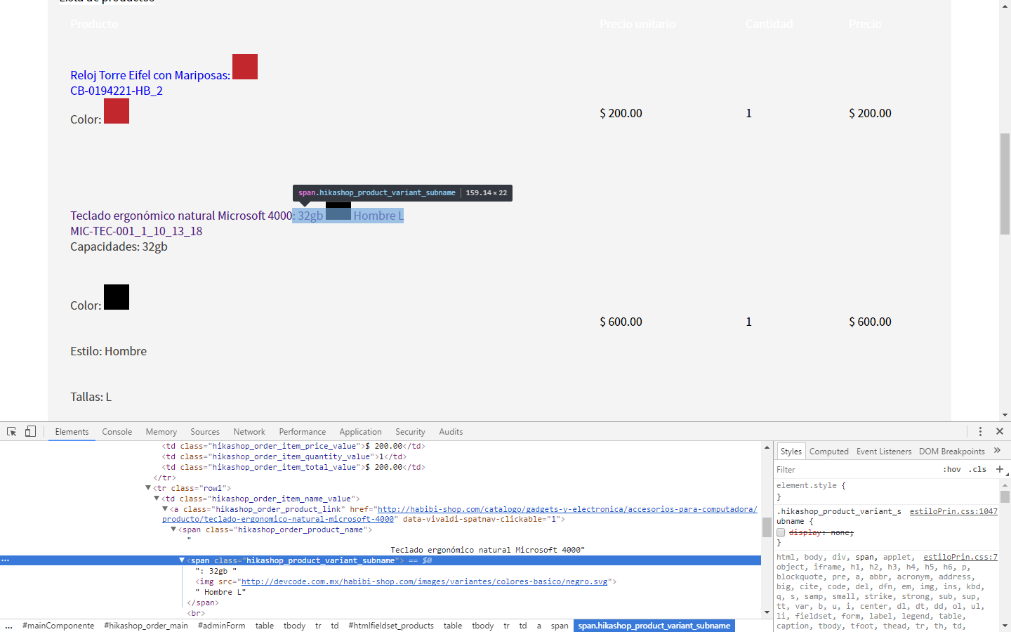

I have another question. How can I remove the contents inside "hikashop_product_variant_subname"?
9 years 6 months ago #268517
by nicolas
Replied by nicolas on topic Display characteristics name and value in list form in checkout
What I usually recommend is to leave it there and just add some CSS to the page with a display:none on that class name so that the span is not displayed.

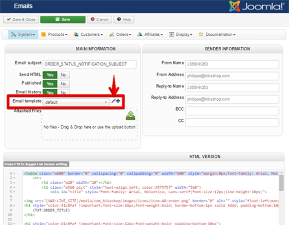

The problem I'm having is with the emails. I can't figure it out how to hide this information.
9 years 6 months ago - 9 years 6 months ago #268798
by Philip
Replied by Philip on topic Display characteristics name and value in list form in checkout
In order to add some Css in your Email you can process like this, follow me step by step :
1°) Go to Components => HikaShop => Configuration, then in System dropdown select Emails to see Emails type listing.
Then select your required Emails to edit it.
2°) If I follow you, you want remove this element :
So, click on the little pen icon close to Email template :
You will see a popup window that display your email Css, you have just to add this kind of Css code :
Hope this will help you.
Code:
<span class="hikashop_product_variant_subname">
</span>
Code:
Span_class_name {
display: none;
