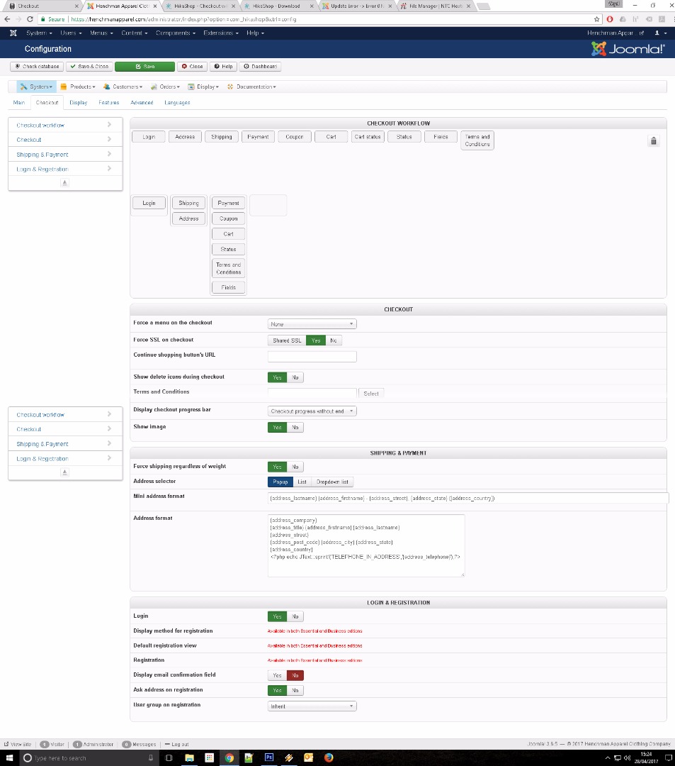

Also, could you provide a screenshot of the settings under the "checkout" tab of the HikaShop configuration ?

Screenshot provided.

Then I'm stumped. Can you provide a backend access, a FTP access and a link to this thread via our contact form so that we can have a look at the issue ?
