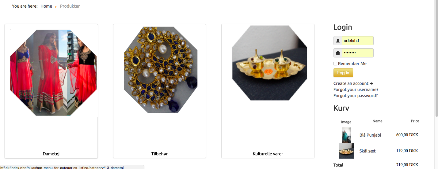

Hello i have a few problems.

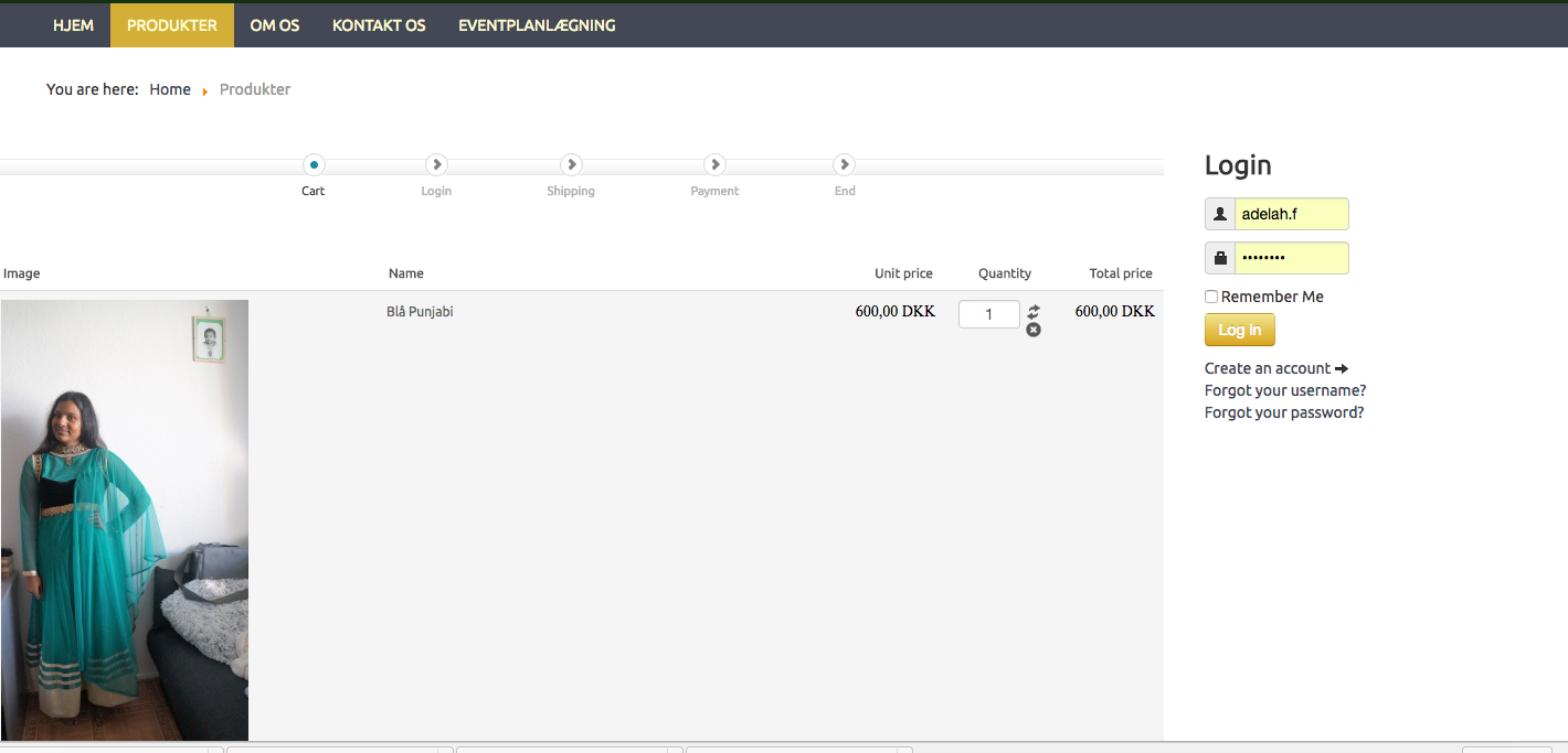

problem 1: After i add a product to my car it automatic goes to check out. How can i change that so it only add to the cart and i can keep shopping?

Problem 4: How can i use the thumbnail pictures of the products instead of the big pictures because the pictures are taking alot of room?

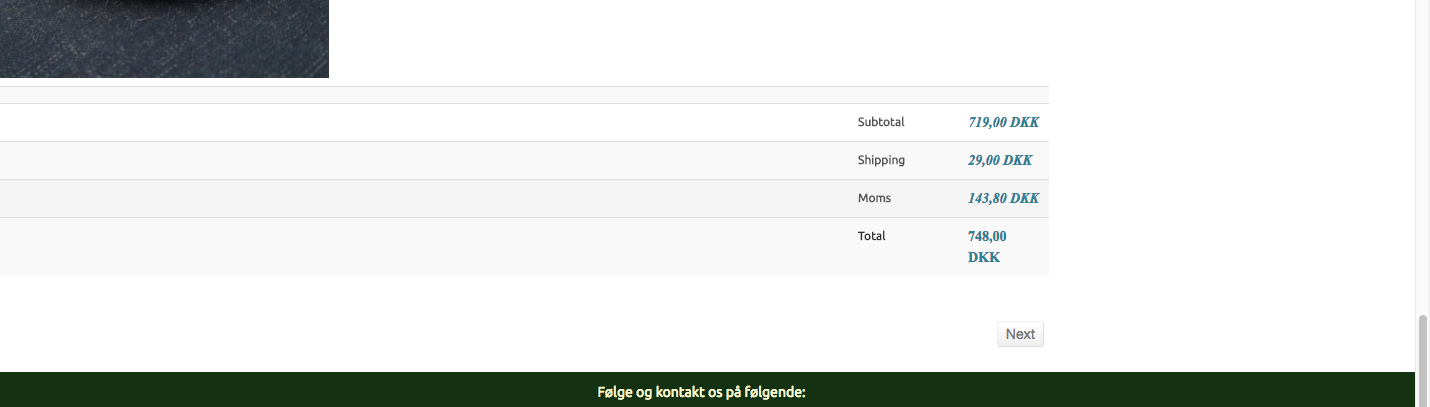

Problem 5: how can i add a back button because there is only af next button

1. You can enable the HikaShop cart notification plugin via the Joomla plugins manager.

4. That should be the case, unless you configured too big numbers in the thumbnails width/height settings of the HikaShop configuration or turned off the "thumbnails" setting there.
5. You need to enter the URL you want for that button in the "Continue shopping button's URL" setting.

Hello nicolas
To my first problem, It was already enabled, i tried to disable and there is no difference. the page still goes directly to the checkout page adding a product to the cart
