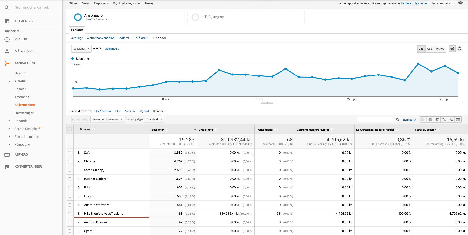

9 years 4 months ago #269607 by dyvel
Hi again
After some more testing, and realtime tracking in Google Analytics, I can follow a user from e.g. Facebook, all the way through the checkout and to the thank you page, while keeping the referral. So the issue is not missing tracking, or a broken session during checkout.
Then I started looking into the data from Google Analytics. There I found that all the conversions had HikaShopAnalyticsTracking as browser. So it seems that "something" is broken in what Hikashop Google Analytics Plugin is reporting back to Google Analytics?

9 years 4 months ago #269615 by nicolas
The fact that you have HikaShopAnalyticsTracking indicates that in the settings of the plugin, you have activated the direct call setting. In that case, the plugin will directly contact Google Analytics to send the data of the order, without any javascript involved.
So it explains why you're loosing the tracking since the tracking is done with the javascript.

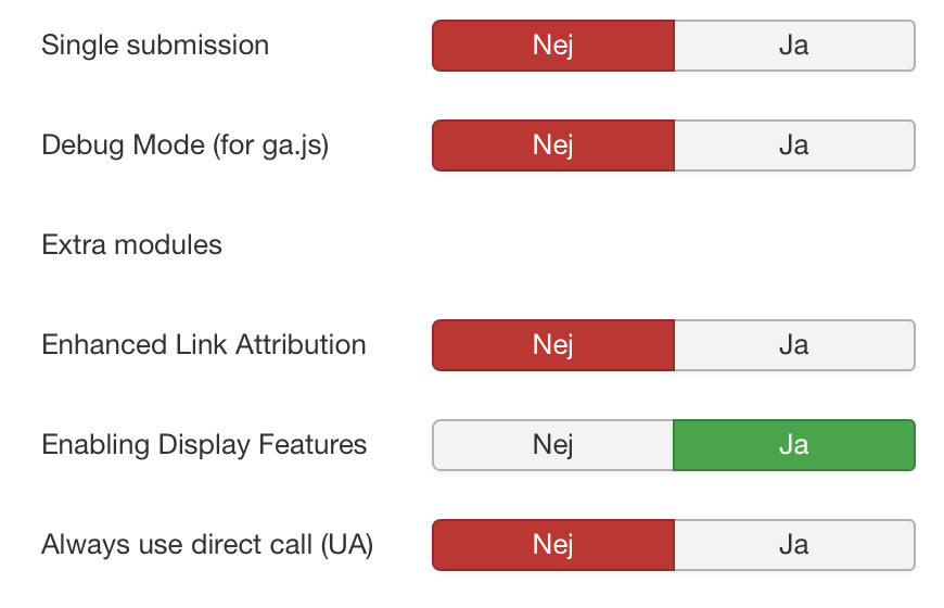

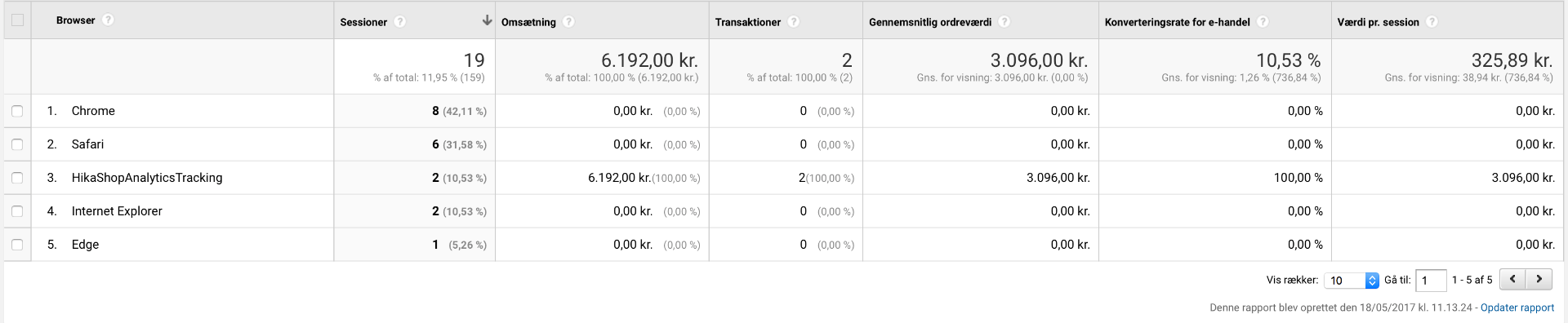

9 years 4 months ago - 9 years 4 months ago #269761 by dyvel
I actually changed that (set direct call to no) 2 days ago, and checked today. Still, all conversion are from HikaShopAnalyticsTracking browser. Please see attached. The screenshot from Google Analytics is for conversion from today, so not old data here.
Also, I'm failing to see the ecommerce javascript after I set direct call to no - at hvad page should it be added? I would expect it at the thank you page?

9 years 4 months ago #269778 by Jerome
You are using Paypal as paiement method right ?
And he is right ; but he forgot to mentioned that, when an order is confirmed by "server-to-server" notification ; the Direct Call is also used in order to not loose any track.
Before ; the real big issue and the main reason why we have the "direct call" is that a customer do not always come back in the store to have the special Analytics JS and track his sale.
