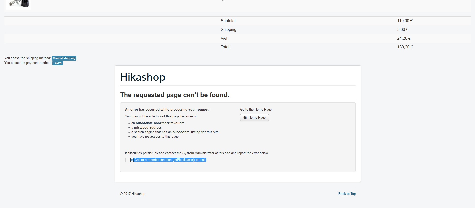

-- Error-message(debug-mod must be tuned on) -- : 0 Call to a member function getFieldName() on null
Hi.

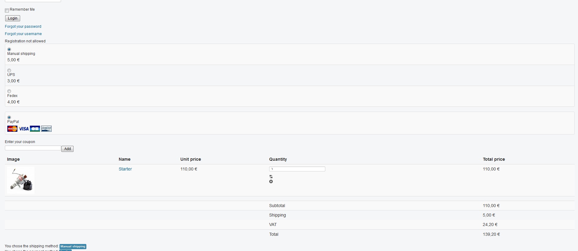

I downloaded the last version of hikashop and installed it with default sample data on a clean joomla. After clicking add to cart I receive an error message and the entire order form takes up the whole screen. In version 3.0.1 I had no such problems.

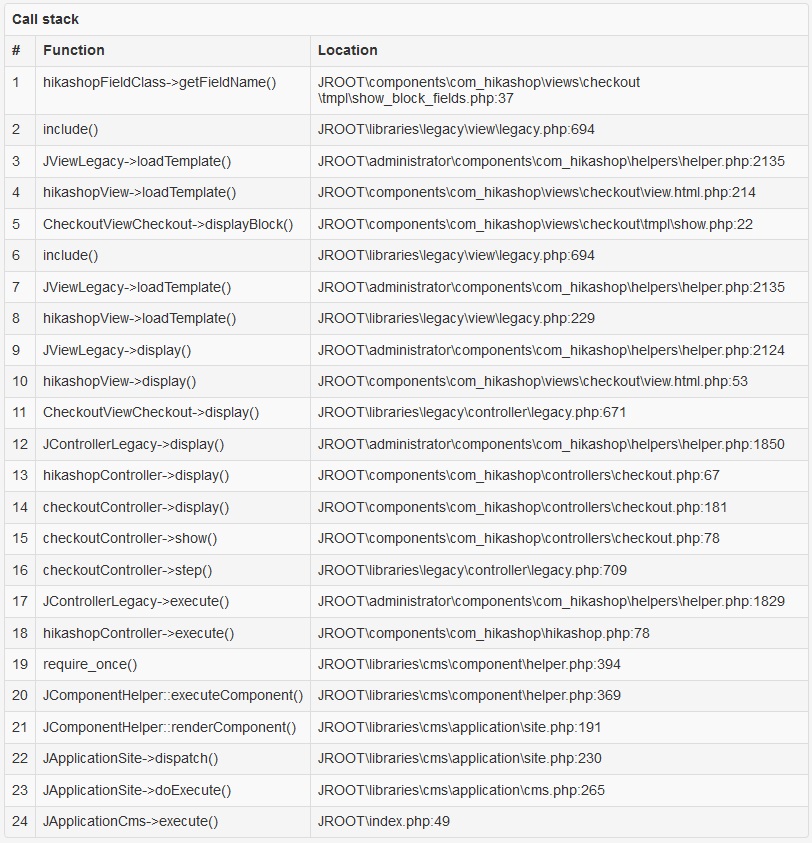

Can you please activate your debug mode in order to get the call stack ?
Thanks to that, we will be able to know from where the problem is coming from ; like that we can't know which file is incriminated and that function is used in a lot of views !

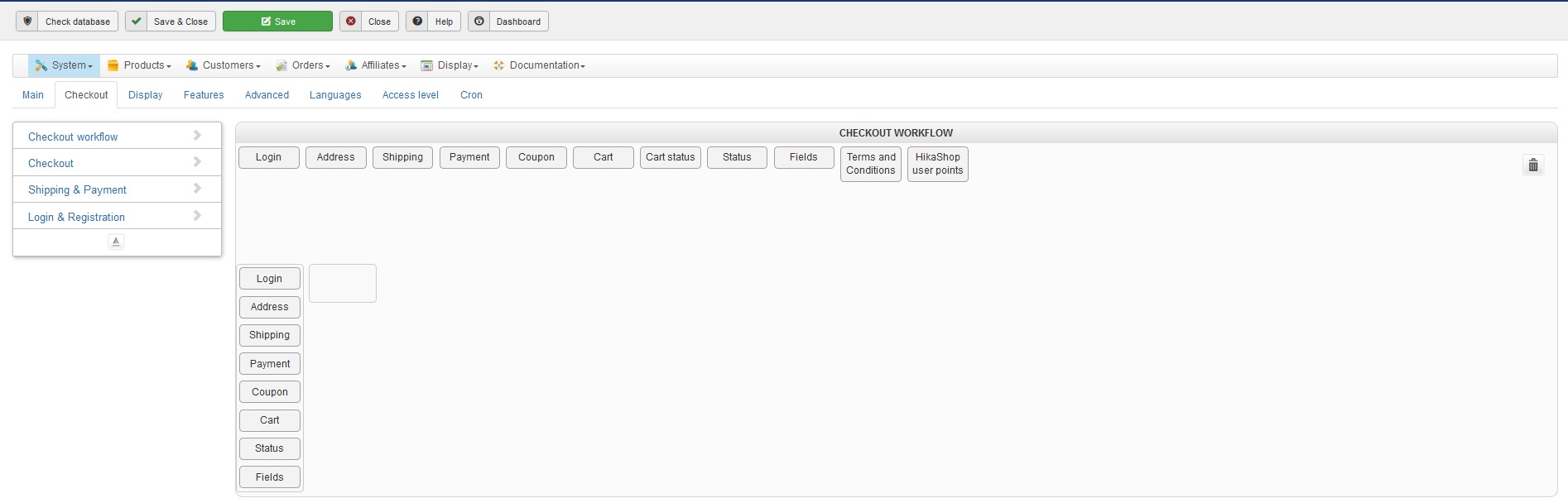

If you can also provide us your checkout workflow, it will be useful.

Screens from debug mode.
Checkout workflow is also default.
