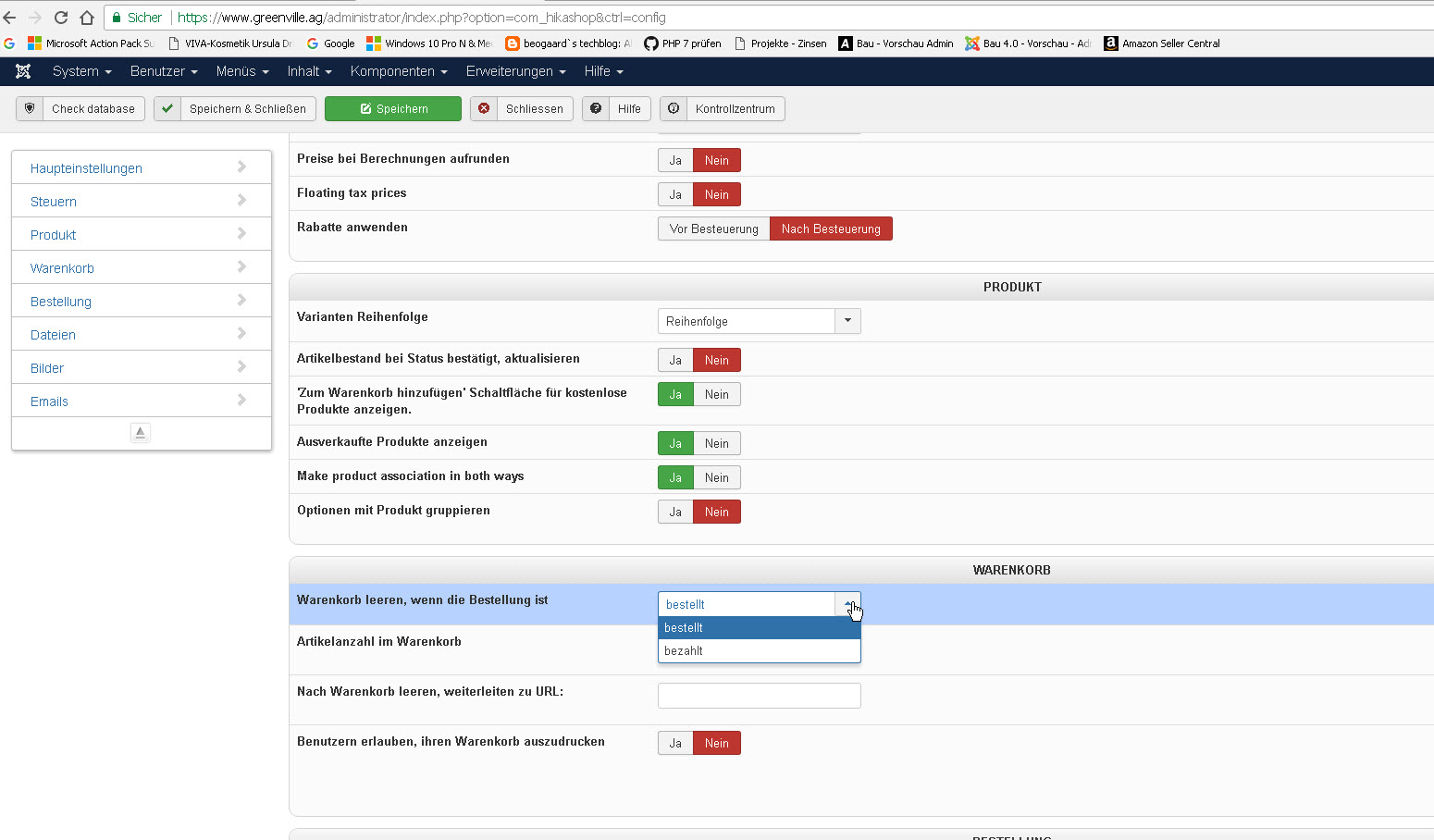

The cart will not be cleared after correct checkout.

Please provide us more details about your HikaShop configuration.
www.hikashop.com/support/documentation/5...onfig.html#main_cart

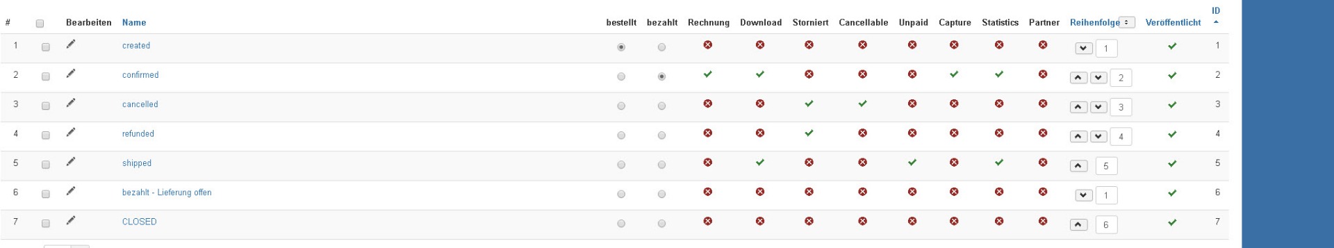

The option "created/besellt" is selected

I just process some test on your website and I succeed to get an empty cart with Paypal and your account.
So maybe you have to provide a step by step in order to reproduce your issue.
Awaiting news from you.
