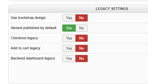

If I understand correctly the new checkout from Hikashop 3.x updates the checkout form without refreshing the page manually.
Unfortunately this doesn't work in my website.
For testing I have made a clean Joomla install, installed only Hikashop and used the Protostar template. Attached is an image of the legacy settings.
Do you have an idea what goes wrong here?
Rgds, Eric

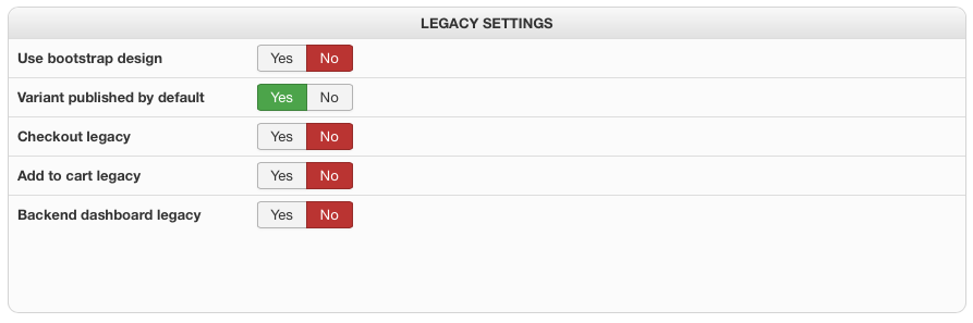

Updating the version today July 07, problem solved .
My version > hikashop_business_v3.1.1_2017-07-07
Attached my configuration legacy
Javier Ballester
