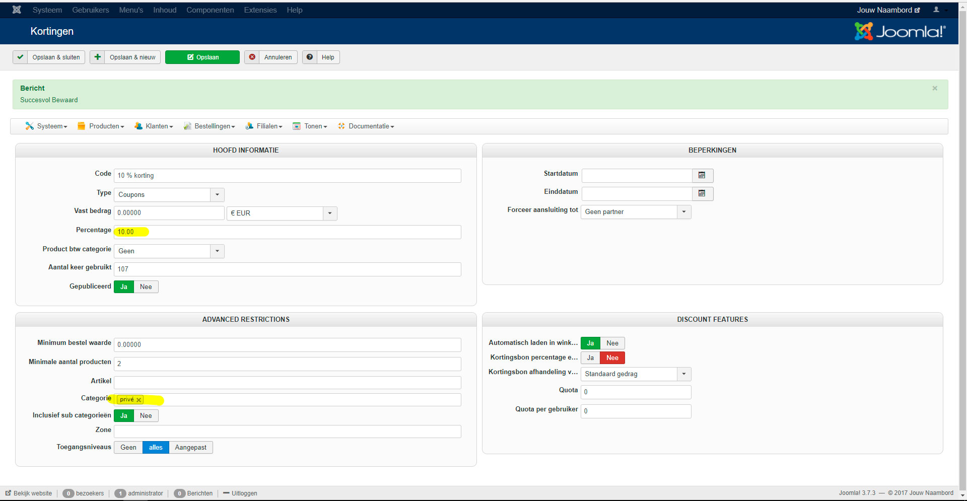

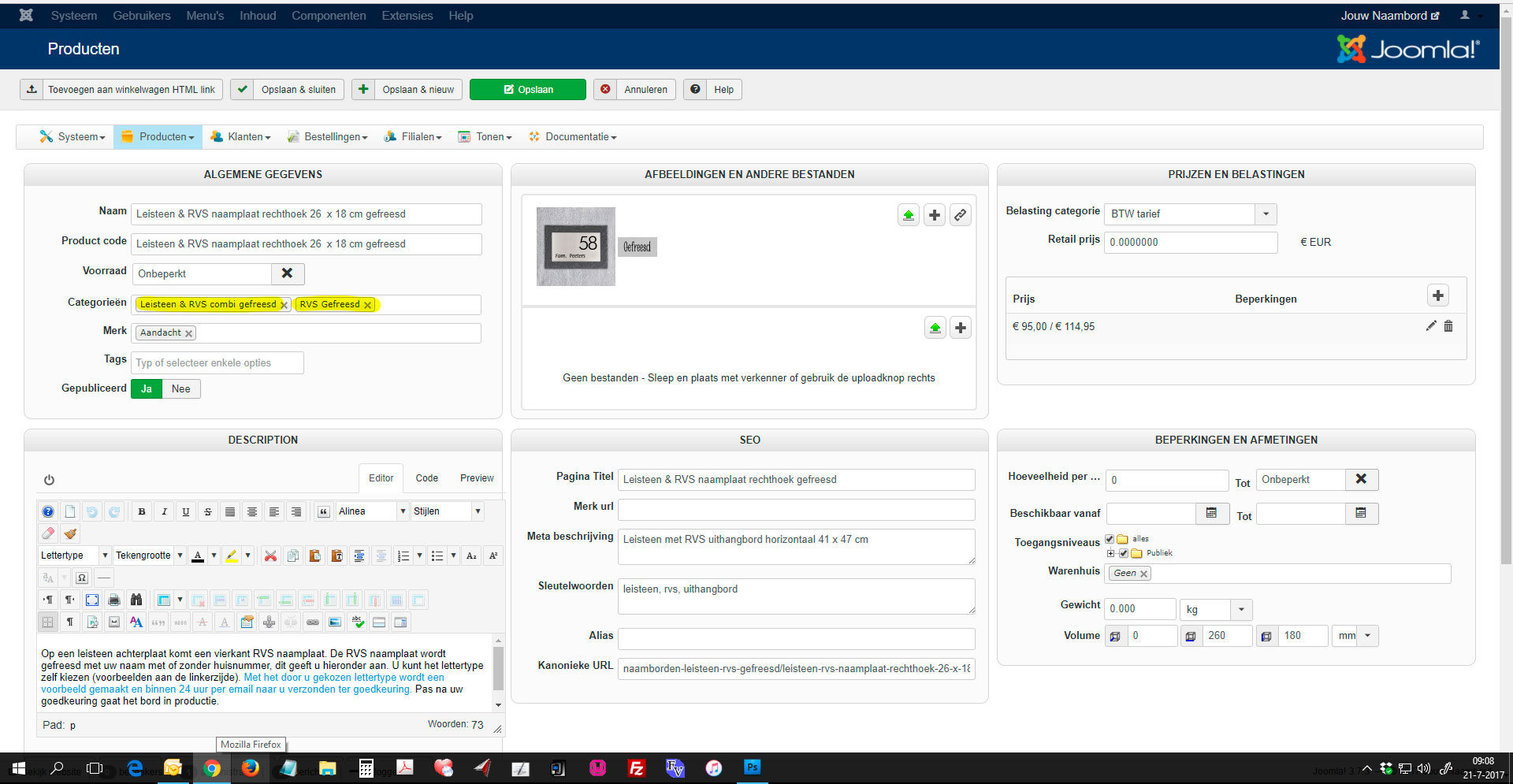

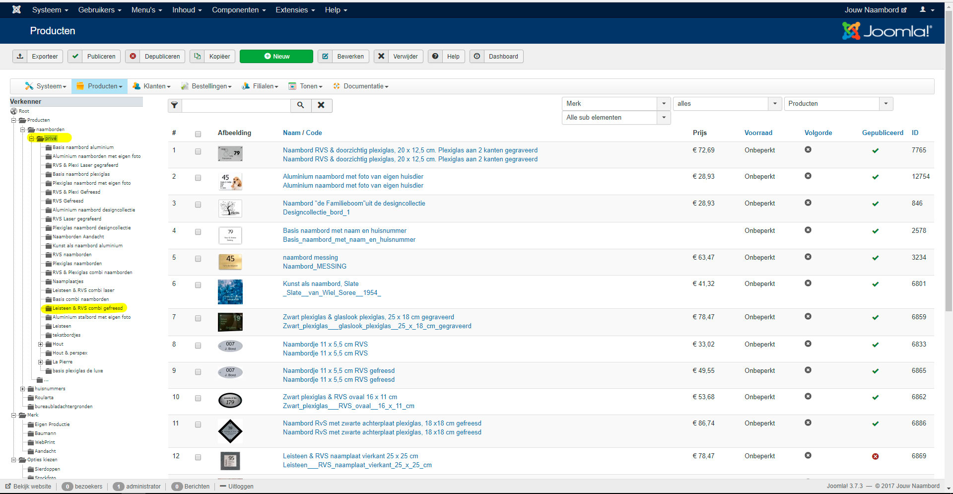

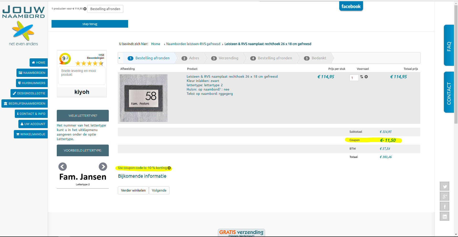

When a product is assigned to more than one category, it gets a 10% COUPON discount (wich shouldn't, because this should only apply when a customer order more than 1 product). When assigning the product to a single category, it works fine???
See screenshots

Try changing the code:
				foreach ($id as $productid) {
					if($product->product_id !== $productid[0]) {
						foreach ($products as $product2) {
							if(!empty($product->cart_product_parent_id) && $product2->cart_product_id == $product->cart_product_parent_id && $product2->product_id == $productid[0]) {
								$coupon->products[] = $product;
					} else {
to:
								break 2;
					} else {
						break;
in the file administrator/components/com_hikashop/classes/discount.php
That should allow the system to count the products only once and not once per category link between the product and the categories of the coupon.
Let us know how that goes so that we can add the patch on our end.
  • Posts: 515
  • Thank you received: 22
9 years 6 days ago #274462
Hello Nicolas,
Yes, this code works fine, problem solved! Thanks again.
