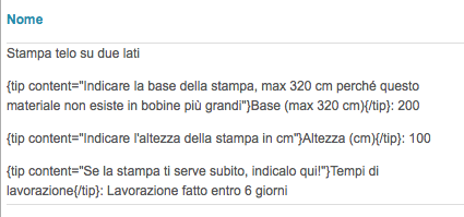

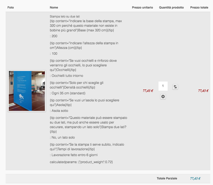

  • Posts: 42
8 years 11 months ago #274974
I will try to explain better and include two screenshots.
Have added tooltips on custom items with the tooltip nonumber extensions. This means in the Label of each custom item, I do not write the label only, but also the tooltip, for example:
instead of only: Base (cm)
I have:
{tip content="Indicare la base della stampa in cm"}Base (cm){/tip}
I can disable this whole field in emails, but it is very important to have this field included as it is fundamental for understanding what a customer orders.
As you can see from the screenshots however, the whole text in the Label field is taken and not only 'Base (cm)'.
My question is: how can I exclude the tooltip part from the emails and also the shopping cart (at first the shopping cart shows the tooltips as tooltips, but when modifying the cart it shows simply the whole text ({tip content="Indicare la base della stampa in cm"}Base (cm){/tip}) instead of the 'Base (cm) with a tooltip.
