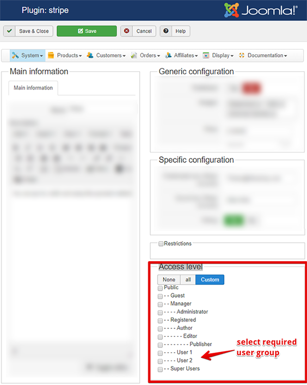

8 years 11 months ago #276463
For this you have to use the "Access level" in your Payment Method like this :
Note that you can create for the same plugin payment several Payment method in order to have for each user group different configuration, if needed.

  • Posts: 63
8 years 11 months ago #276534
Thank you for your reply. However, already set that up, is there any way thatU if I use the credit card payment method I can pull the PRICE A even I'm using a USER B?
I want to have the Price A on the cart even Im using USER B when I check out using the credit card payment.
