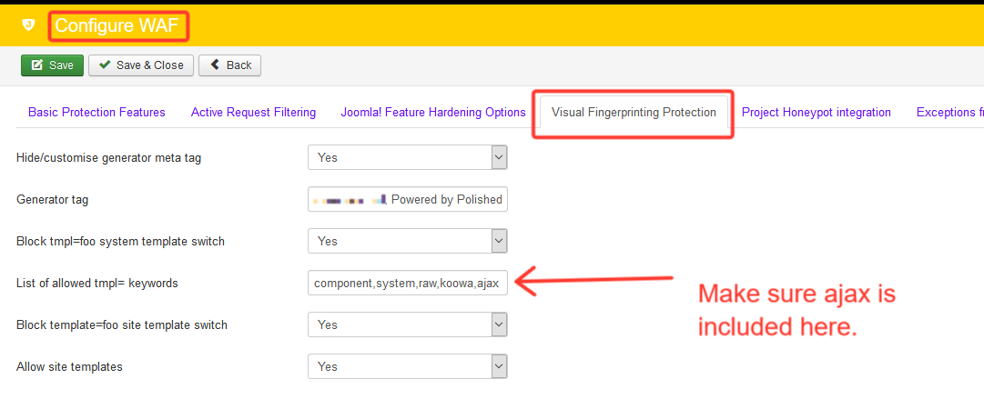

  • Posts: 329
  • Thank you received: 94
8 years 10 months ago #277472
Take a look at this setting in Akeeba Admin Tools and make sure you have ajax included in the list: cl.ly/0q0P3q2u1g3F

  • Posts: 177
  • Thank you received: 4
8 years 10 months ago #277498
Adding AJAX to the allowed list in Akeeba seems to have resolved the issue. Many thanks
