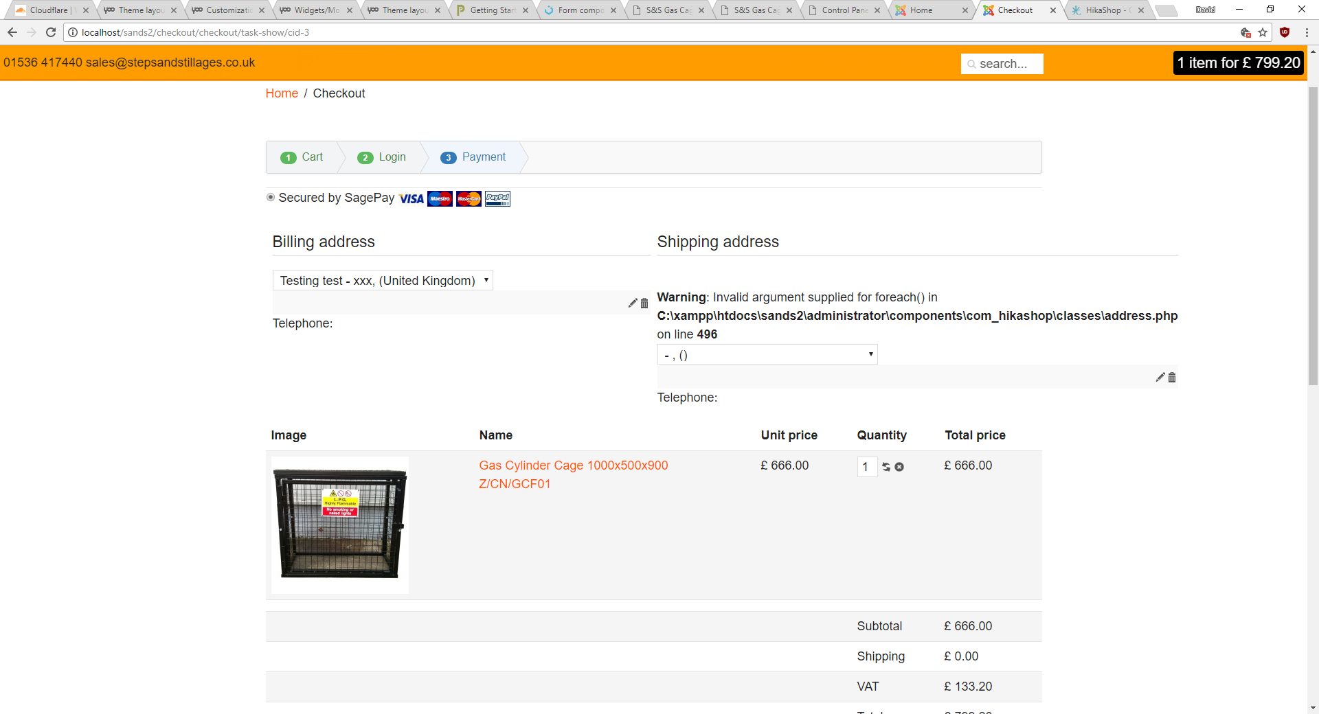

-- Joomla version -- : 3.7.5
-- PHP version -- : 7.0.9
Just testing a new template for the site on localhost using non legacy settings. Checkout works fine in legacy mode and was working in hikashop 3.1.1.

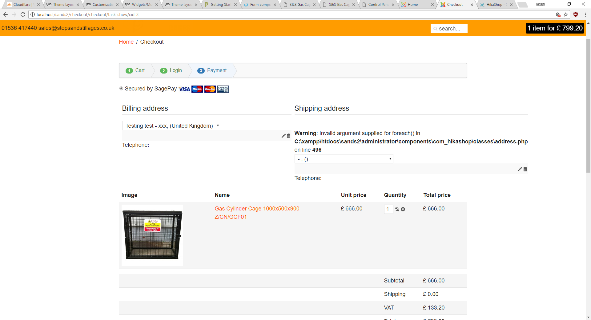

In non legacy mode when using the dropdown list address selector i get php warning
Warning: Invalid argument supplied for foreach() in C:\xampp\htdocs\sands2\administrator\components\com_hikashop\classes\address.php on line 496

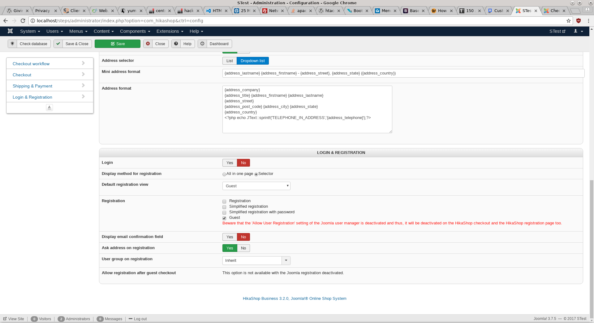

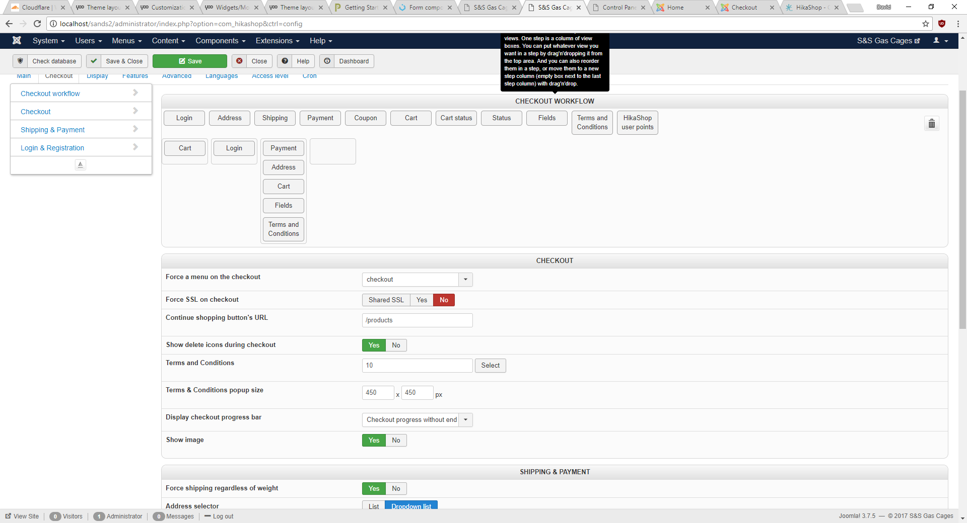

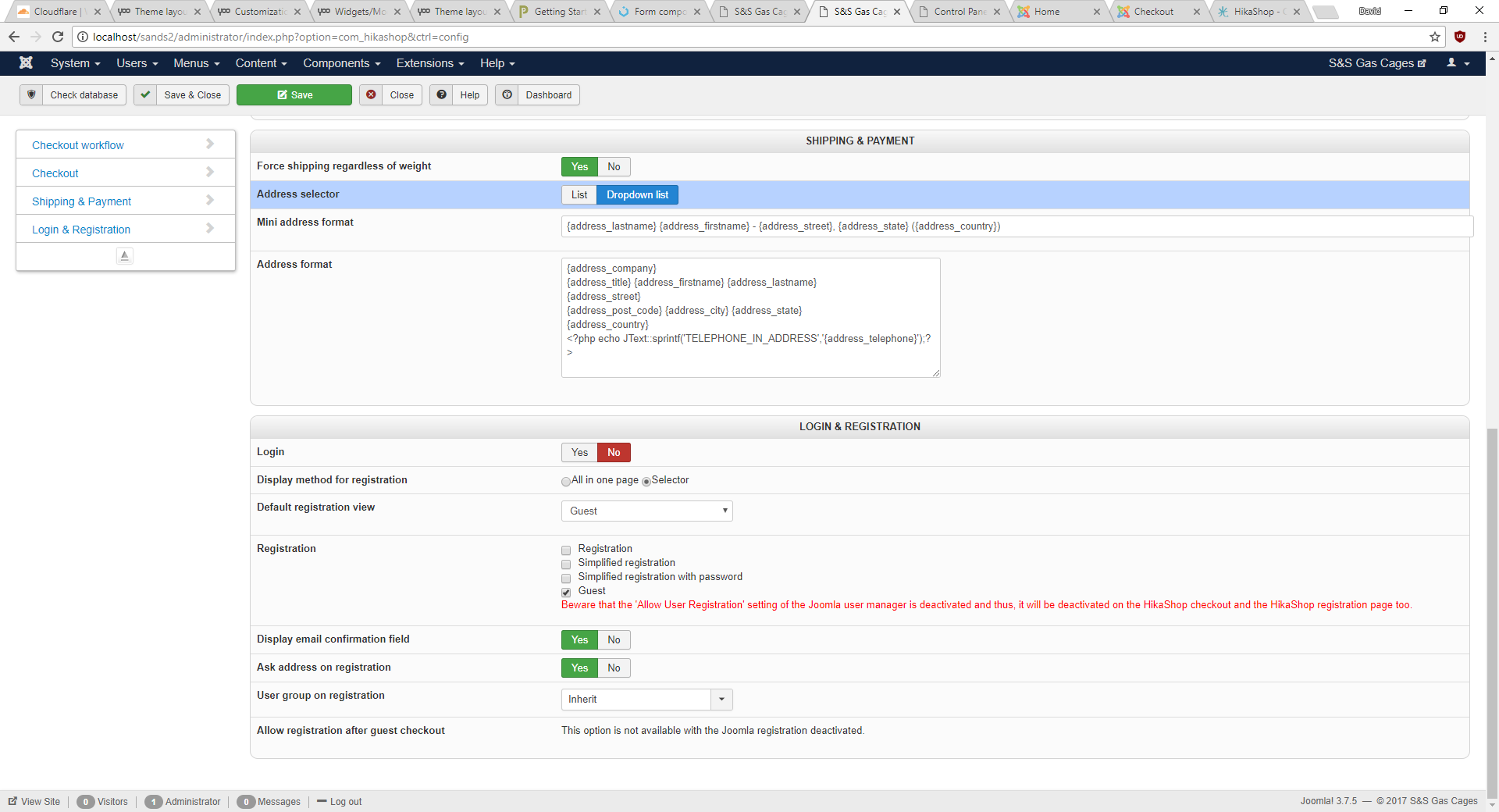

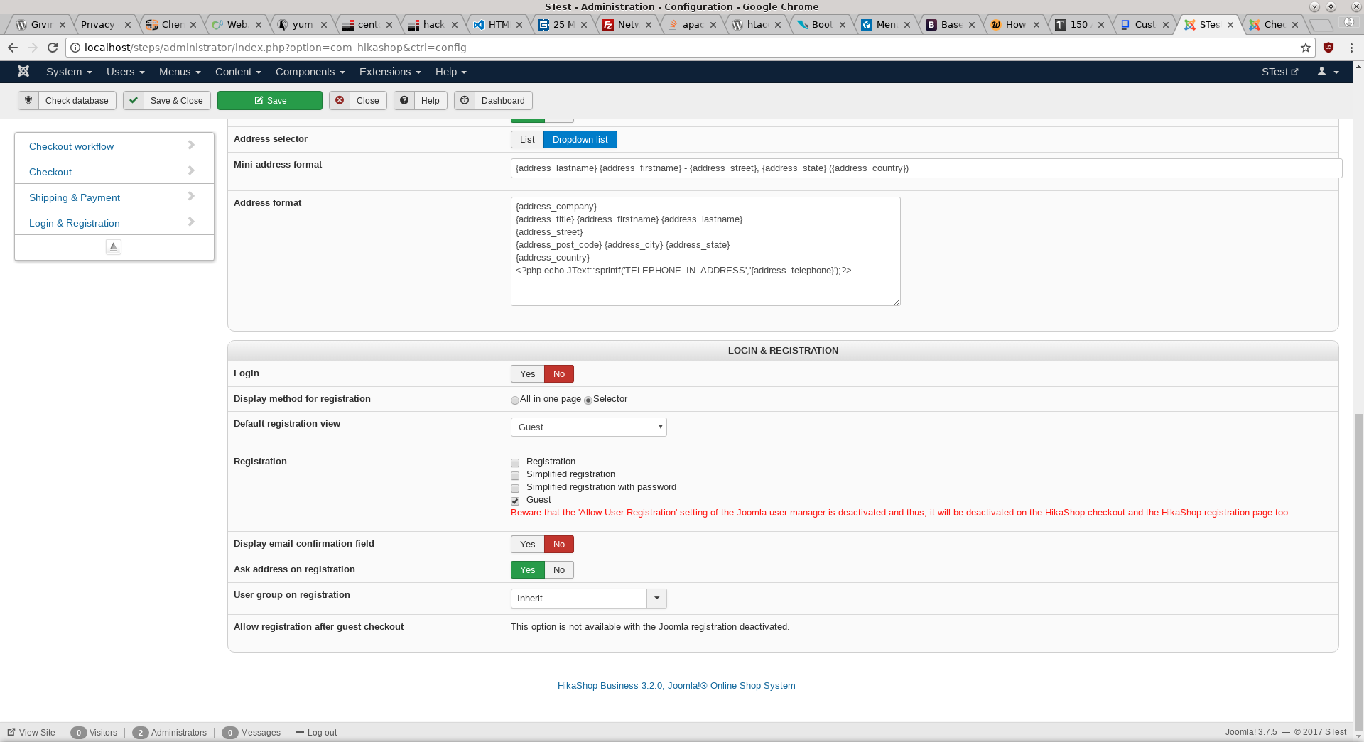

I enclose a screenshot and a screenshot of my settings. Shipping is always free and customers often choose a different shipping address to billing address.
It works mostly ok when using the list mode but none of the addresses are by default selected and if the customer checks out no addresses are stored in the order.
Thanks,
David.

8 years 10 months ago #278142
The error persists no matter what I do! I have tried with a clean install of joomla and hikashop business with test data. The checkout workflow is single page unchanged from the test data. The only changes were made to the guest settings as in the attachment.
Like I said the list mode works but with no addresses selected thus allowing the customer to checkout with no addresses in the order.
In joomla allow joomla registration is deactivated.
You can see the result of checkout on the test server here tototoo.co.uk/test1/ Purchase a product from the category menu and checkout you will see that the shipping dropdown listbox has an error. If this was the list mode it would display ok but none of the addresses would be selected.
I just published the cart module to the sidebar so you can checkout. No other changes.
Bye,
David.
