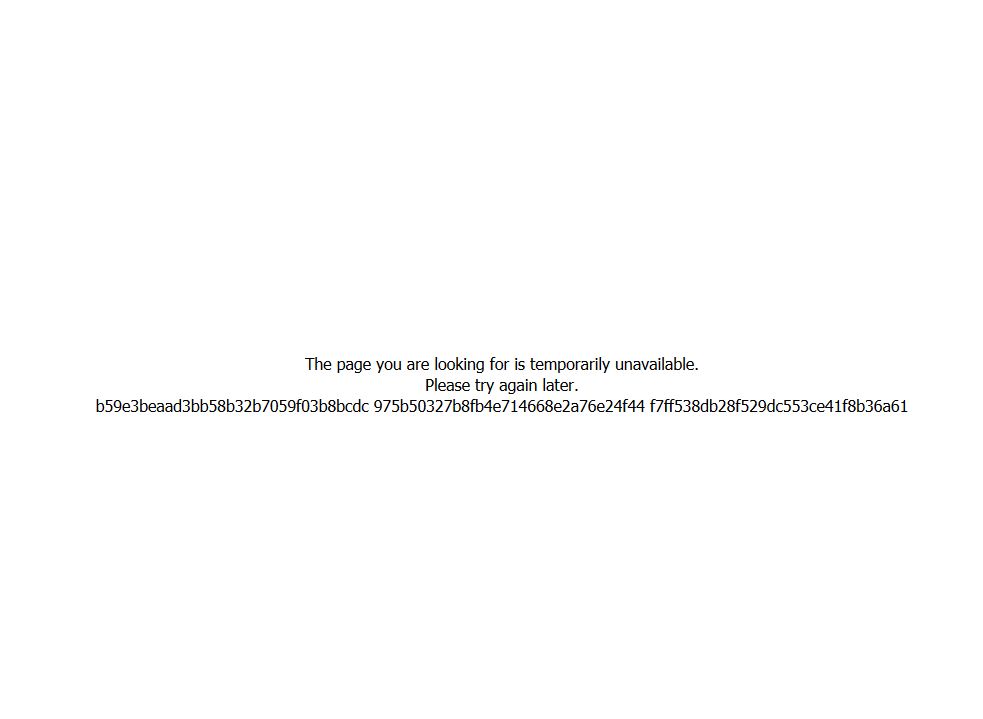

Hello, i have got a problem in the checkout since i have transfered my site from a local server to internet.

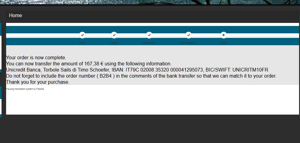

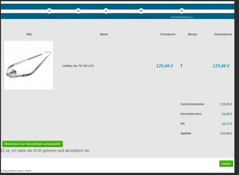

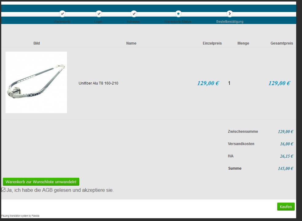

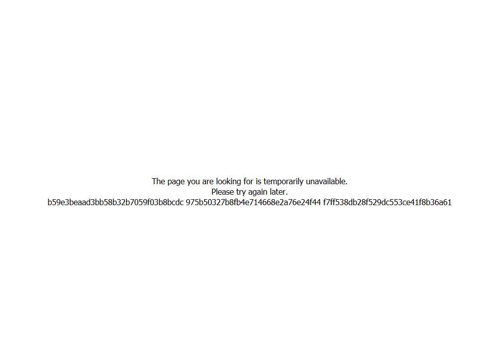

It is a 5 step checkout process and when i cklick at step four (cart status, image "checkout_1)) the finish button, for a long time it happens nothing and then i get an error message (look at the attached picture "checkout_2_failure. on my local server everything is functioning like it should (image "checkout_2_correct). seems to me like a broken link or something like that but i don't know where to look. Can someone help me please?

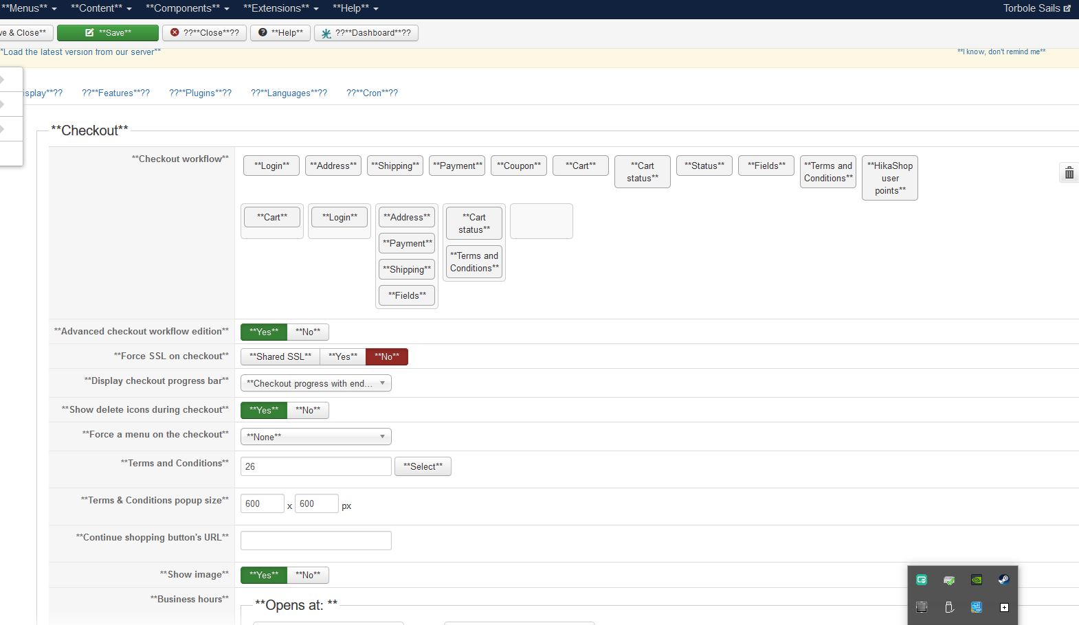

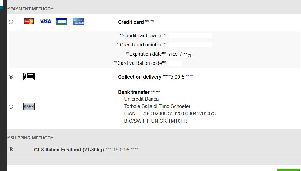

Can you give us more information through some screenshots for example about :
- The Payment methods your are using and how you configured them
- Your checkout workflow configuration that you can find via "Hikashop->System->Configuration->Checkout"

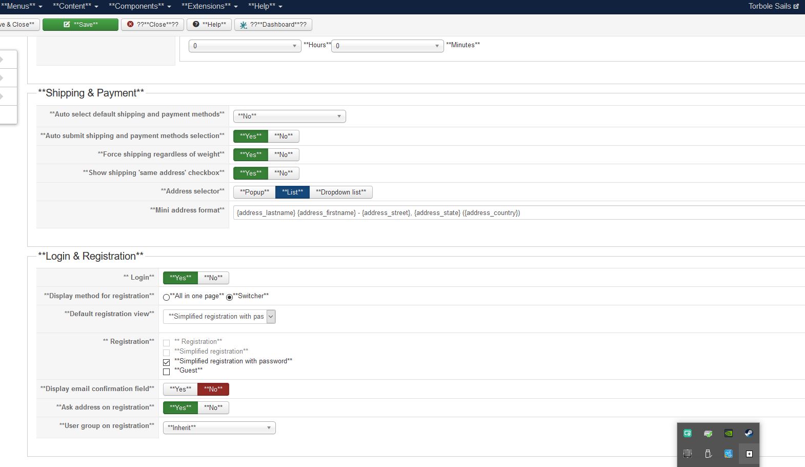

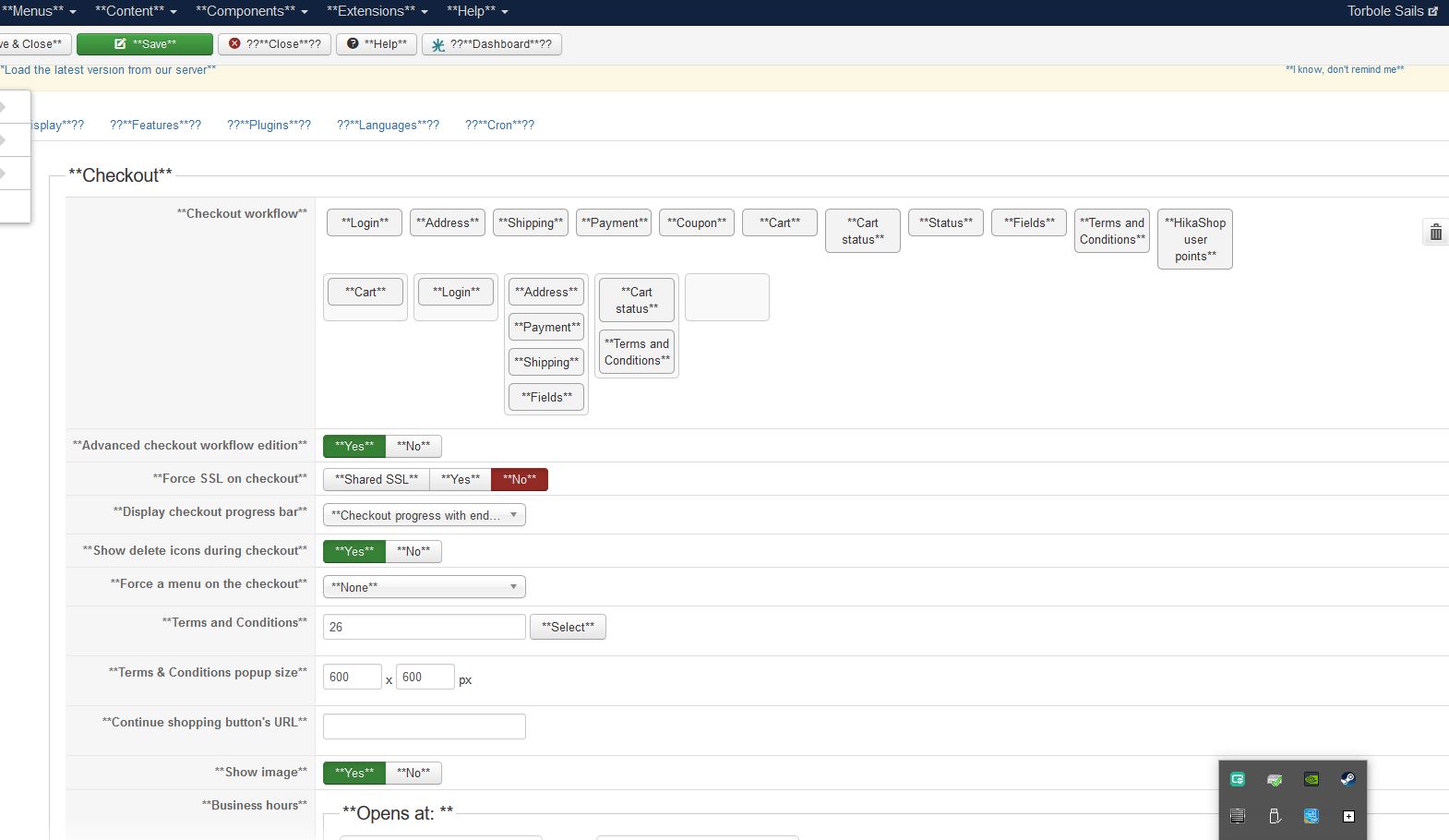

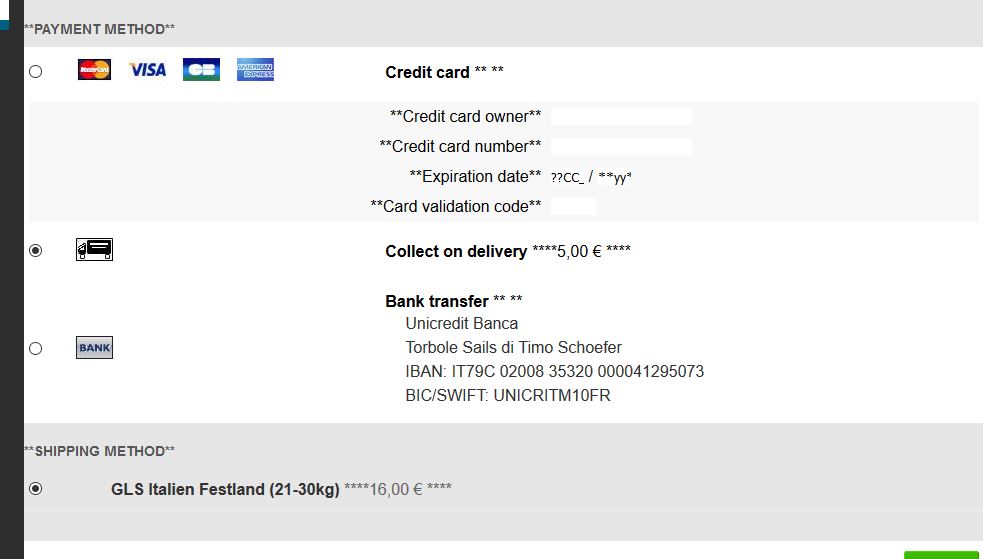

8 years 11 months ago #279232

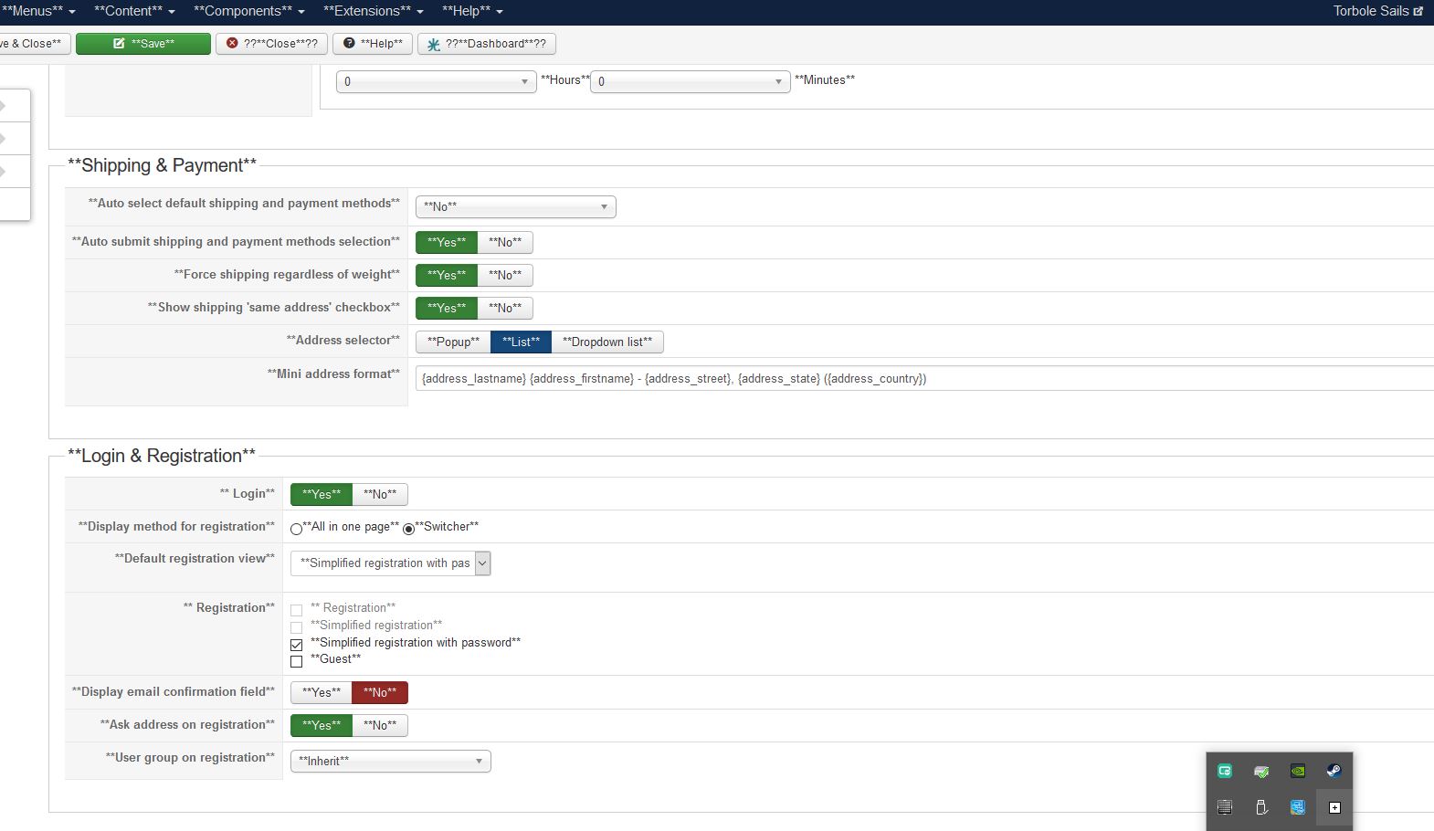

here are images from the payment methods - which it seems it doesn't matter because i have tried them and the result is always the same and the images from the checkout workflow page. i have also activated the debug mode... but i cannot see where to put the reporting level to maximum

ok i found the error reporting to "maximum" but where do i see those reports? do i have to open some file or should it come directly on the screen? i have seen no joomla message just the message of the browser that i have already sent to you. and the timelag when i cklick the finish button till the error message of the browser is very long - about 2 minutes where happend nothing.
