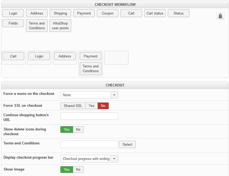

  • Posts: 7
8 years 11 months ago #281049
Please see attached. In your video you have a checkout progress bar, at least I think that's what is I do not get this showing the steps to check out. It's most likely something simple figure out
Paul
  • Posts: 86216
  • Thank you received: 14222
8 years 10 months ago #281052
I don't see why you would miss the progress bar if the setting is activated, unless you have an issue with your Joomla template.
If you switch temporarily to the default Joomla template, do you still have the issue ?
Could you provide a link to the shop with instructions to reproduce ?

  • Posts: 7
8 years 10 months ago #281131
All Got it working. You need the plug in on the product list to proceed to check out to see progress. Without plugin you see the add to cart message but no proceed buttton.
