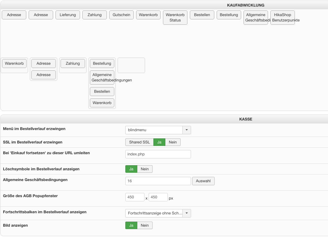

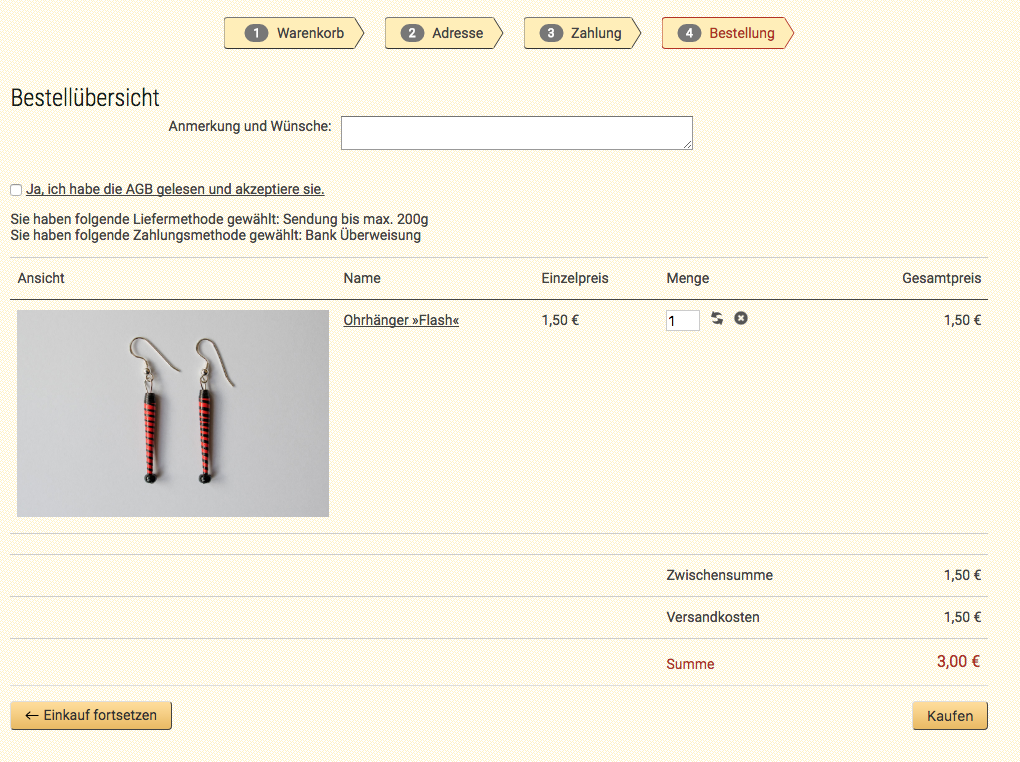

  • Posts: 95
8 years 10 months ago #281444
Hi Jerome,
here screenshots from front- and backend.
If I click "Kaufen" (Buy) without check the conditions (AGB) on top, I will go to the first step. Only if I marked the checkbox and undo this (click twice) I receive the alert, which I want by clicking the BUY button.
Sorry for my english – I hope you can understand my problem.
Thanks,
Jonas

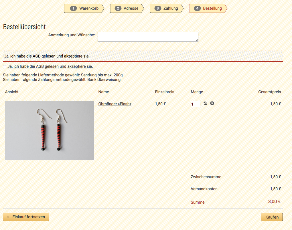

  • Posts: 26387
  • Thank you received: 4078
8 years 10 months ago #281445
turned on the first step. In this case the user have to go all the steps otherwise and need to know what were wrong.
For what I can see in your screenshots, the user is not redirected to the first step but it stays in the step with the problem.
And we can see the message above the checkbox explaining that the user need to accept the terms.
The display of the error is the same for every checkbox blocks ; we removed the javascript "alert" since it's less and less use nowadays.
  • Posts: 95
8 years 10 months ago #281546
Hello Jerome,
I don't understand your message.
I want, that the alert (how I produced by dobbleclick the checkbox, accept and no accept: screenshot with alert) figure if the user do not click the AGB checkbox but want to buy - clicking "Kaufen" (Buy).
In the actual case if the checkbox is empty and the user click "Kaufen" the user goes automatically to the first step (without any information what was wrong).
If you want test it, the shop is already not working and you can buying something using guest login and bank transfer – without buying something real.
Can you understand my problem? In an older version of hikashop it works well with alerts if the user 'forget' the checkboxes.
Jonas

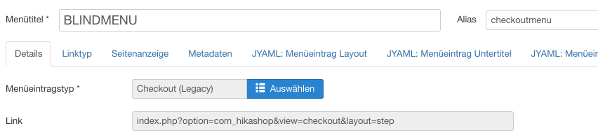

8 years 10 months ago #281679
Hello Philip. hello Jerome,
thanks for the hints!
After update from Hikashop 3.2.0 to the last 3.2.1 I looked to my menu settings and found something:
In the newer checkout legacy I cannot set a forced menu wich is linked to an article (item)! – I need a forced menu, because I want add other modules to the checkout pages.
Now I choose "Hikashop Checkout legacy" as menu-type (how you can see in the screenshot) and anything works fine. In frontend checkout I can jump a step behind and also if the user forget a formular, will be receive a error message.
Only one question: is it right to use this menu option "Checkout legacy" in this way or had it any other functions?
Thanks a lot! ... but I think about write a real manual for Hikashop in german … same day ;-)
Jonas
