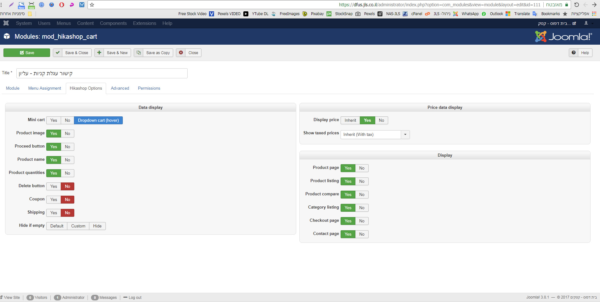

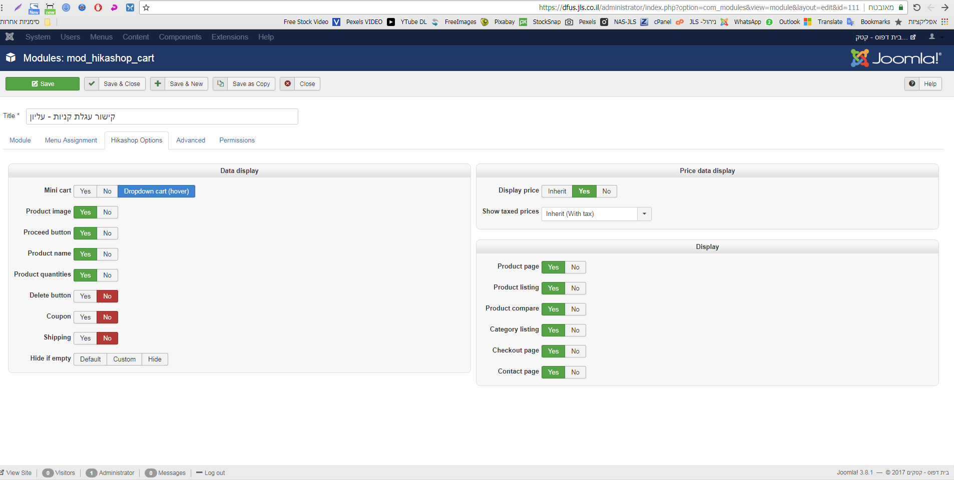

  • Posts: 8
8 years 10 months ago #282137
Hi... Dont see this kind of option...
Module option included.
  • Posts: 86216
  • Thank you received: 14222
8 years 10 months ago #282153
Thanks for the feedback on that. That's indeed a problem.
I've added a patch to avoid that.
Download again the install package in the menu My account>My subscriptions on our website and install it on yours and it will add the patch for that.
