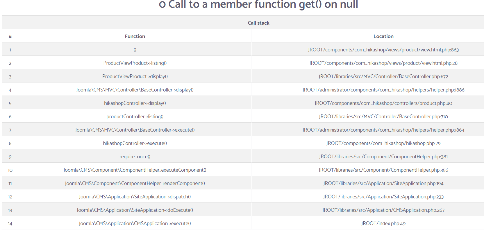

In debug mode the the messate "Call to a member function get() on null" show the messages in attached image.
Thank you

1. Well, if the setting doesn't change anything, it means there is a problem with the payment plugin. I would recommend contacting the developer of the payment plugin for help.
2. The order is created with the status "created" and then if you click on cancel, usually it changes its status to cancel and redirects you back to the checkout if the cart hasn't been cleared.
3. Thanks for the feedback on the error. We've added a patch on our end to avoid that.
