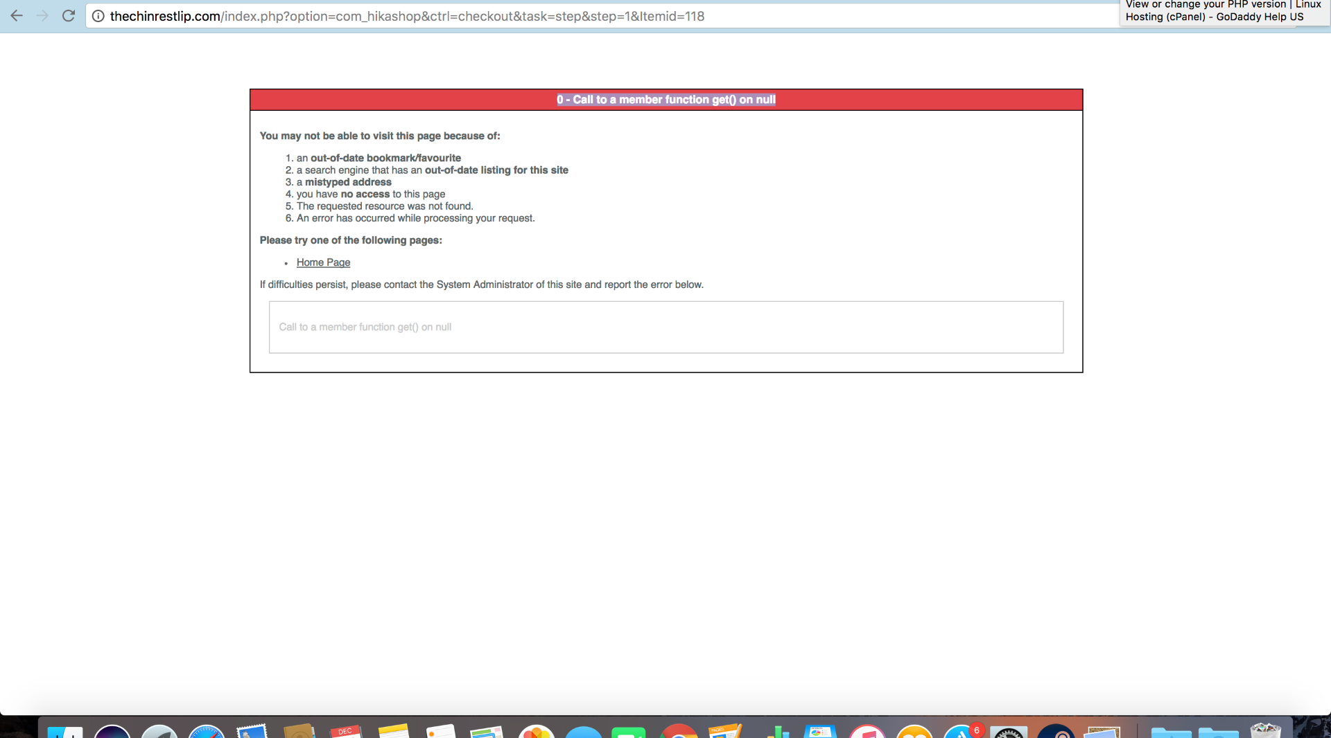

-- Joomla version -- : 3.7.2
-- PHP version -- : 7.1
-- Browser(s) name and version -- : google chrome
-- Error-message(debug-mod must be tuned on) -- : 0 - Call to a member function get() on null
When I tried to create an order from my website, normally it should take me to paypal, but now this message shows up "0 - Call to a member function get() on null".
What should I do? Please suggest.
I tried to look in similar topics in your forum, but still I don't know what to do.
Thank you so much
Shuiijn
  • Posts: 86181
8 years 8 months ago #284939
Firs tthing to do when you get a blank page/error on a Joomla website is to activate the "debug mode" and "error reporting" settings of the Joomla configuration.
That will add more information on the page where you have the blank page/error.
The additional information will be crutial to understand where the problem is coming from.
An error "Call to a member function get() on null" means that some code somewhere is trying to call a function "get" of a variable that doesn't contain an object with a function get.
There are hundreds if not thousands of "get" functions on a Joomla websites and 10 times more calls to these functions from everywhere. So that error could come from almost anywhere on your website.
The additional information you'll get with the debug mode and error reporting will allow to narrow down where the problem is coming from.
Also, please note that we released HikaShop 3.2.2 two days ago. You could first try to download it on our website and install it on your website to get the update. It contains many fixes and it might help.
And finally, I see that you're using the old checkout of HikaShop. You might want to turn off the "checkout legacy" setting of the HikaShop configuration. That alone might fix the issue.

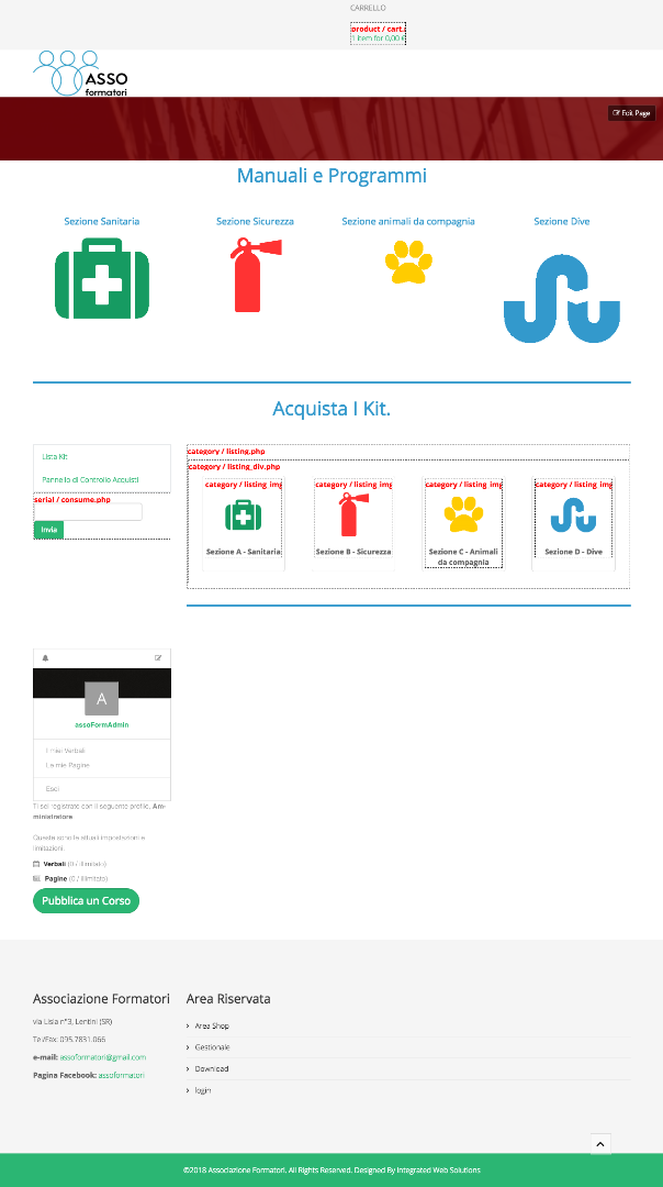

  • Posts: 21
8 years 5 months ago #290409
i updated hikashop business to 3.4.0 version, and now I found a new issue as you can see in the screenshot.
  • Posts: 86181
8 years 5 months ago #290400
With the debug mode activated you can see that error message:
monosnap.com/file/9SY0wUjokg42r4EopaEC9zRsjl63Ak
And this indicates that the issue comes from the easysocial plugin which isn't a plugin we developed. So no, the problem is not a bug in our component.
Please contact the developer of that plugin so that they can help you.
