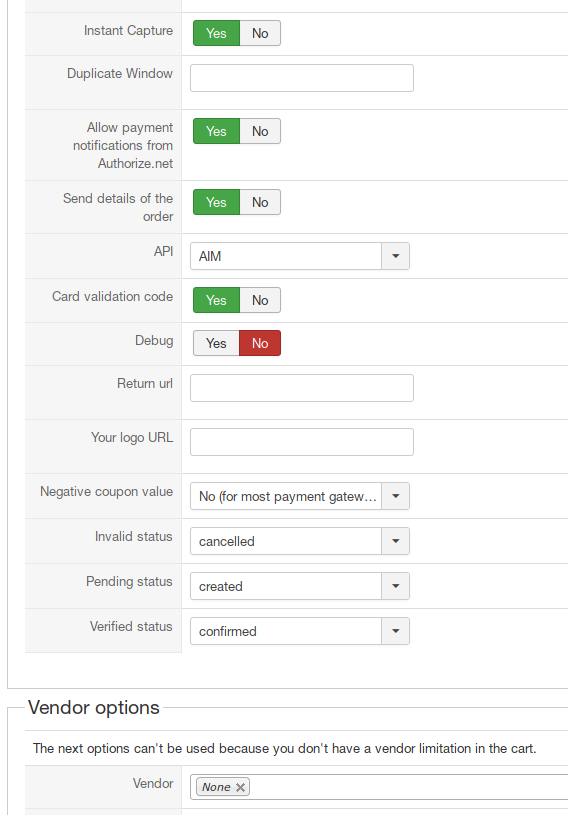

We're using AIM on Authorize.net plugin. I built this Shop in 2015 and have done continuous upgrades since, but can't remember if we ever had a message or popup on declined transactions.

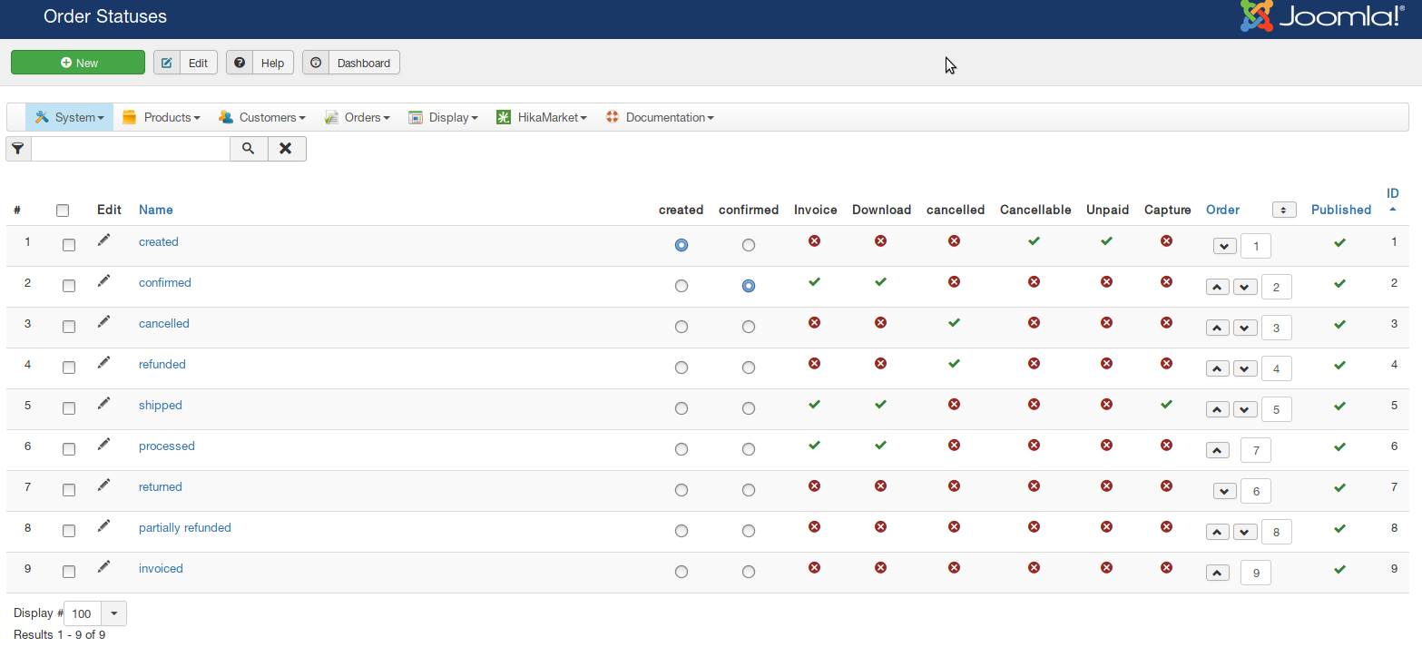

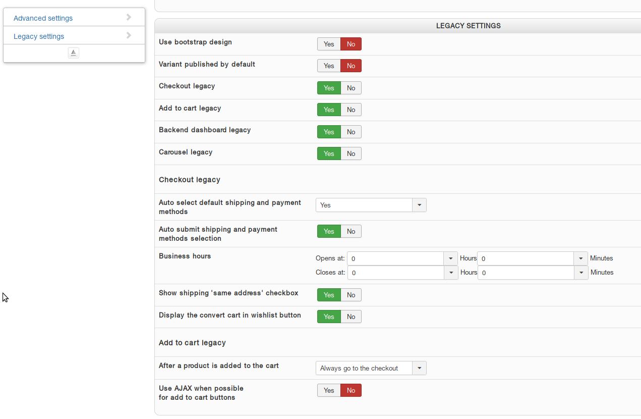

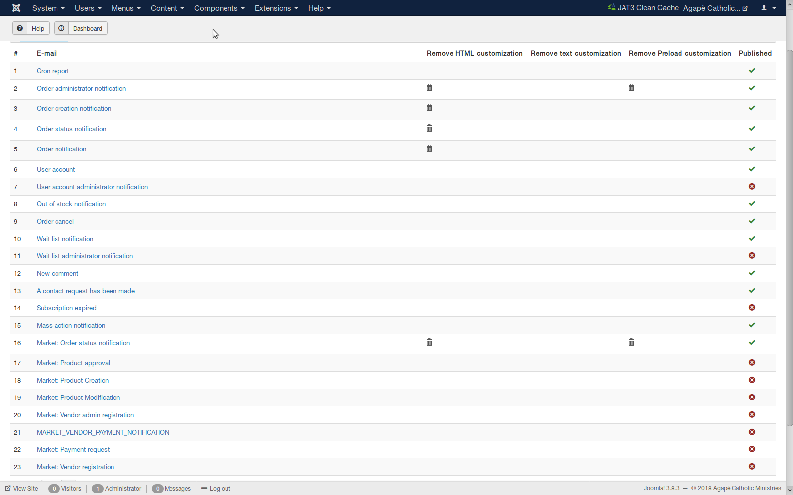

I've attached some screenshots of related settings: payment method, emails, order statuses, and legacy settings (we're running legacy at the moment). We using Vex popup mode.

The first thing to test is to deactivate the "checkout legacy" setting of the HikaShop configuration and see if that helps.
Also, it's possible that the issue comes from your template not displaying the error messages:
www.hikashop.com/support/documentation/6...tibility-issues.html
So try with the default template of Joomla and see if you get the error message with it. If so, then there is something to change in the template (and deactivating the checkout legacy setting should help in that case as it will circumvent the problem).
