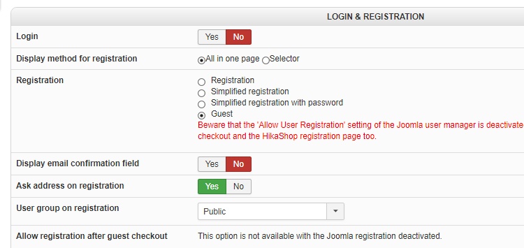

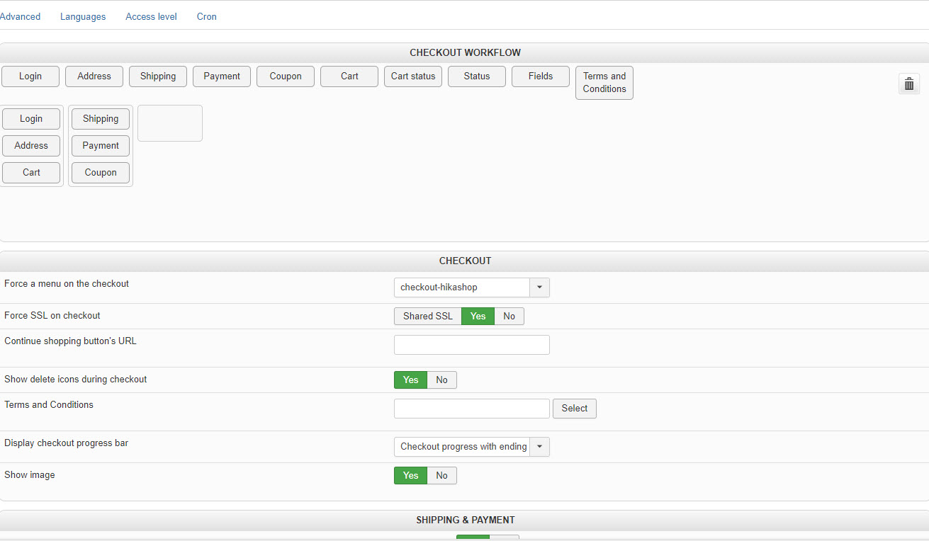

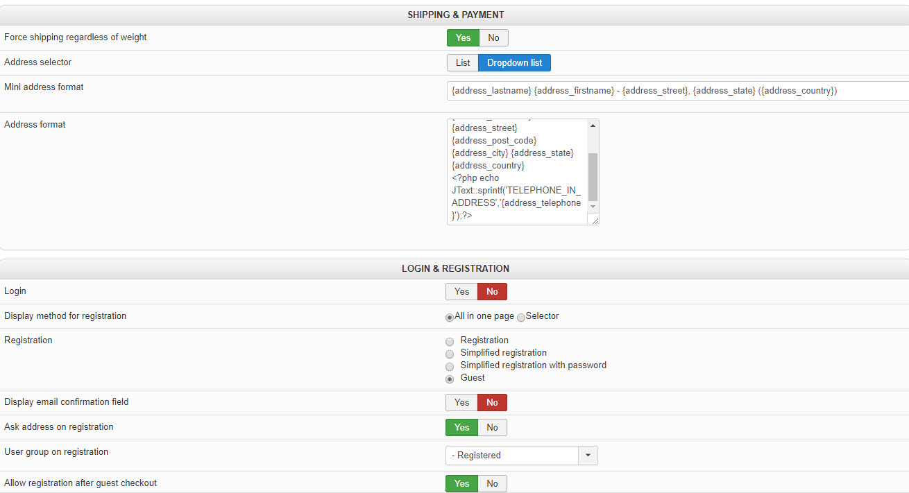

Attached are images of the hikashop checkout backend settings
  • Posts: 86176
  • Thank you received: 14211
8 years 7 months ago #286302
This means that you've set an "user group after purchase" in the settings of your product/variant and that you've the "Hikashop group plugin" activated in the Joomla plugins manager.
Because of that, the system requires that the user is logged in to purchase that product.
So you can either remove what you selected in the "user group after purchase" setting of your products, or you can simply disable the "hikashop group plugin" via the Joomla plugins manager.

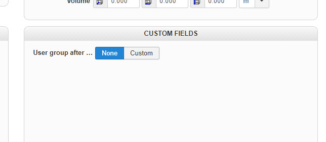

8 years 7 months ago #286326

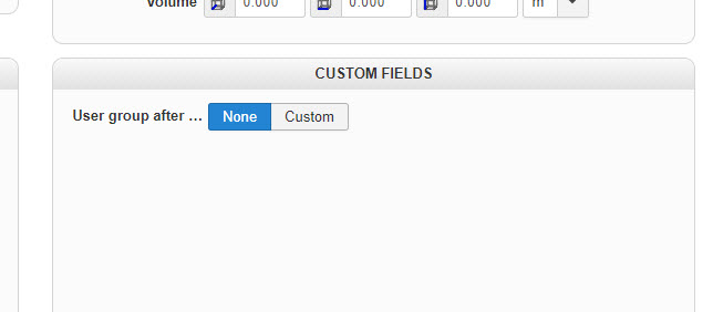

What does this "user group" feature do? I dont understand it or know what it does? I did see it under custom fields and I looked to see what it was set at and the product and all variants were set to "None" see attached image all looked exactly like that I check both product and all variants, made no changes and it was already set to none. Should it be something else or is this feature not working properly. I will disable it for now but I would like to find out more about it what it does and how it works. Thanks for helping I will test to see if I can checkout with this plugin disabled and report back one way or another. Thanks!
  • Posts: 86176
8 years 7 months ago #286350
This feature will add a user group to the user account of the customer after the purchase of the product.
If you select a group in it, then it requires the customer to have a user account on the website... otherwise it can't add the user group to the user account.
With old versions of HikaShop, there was no check that the customer had a user account and thus it it was possible for customers to purchase something they couldn't use if they were checking as guest.
So your problem is a mis configuration which was brought to light due to an improvement we made with the new version.

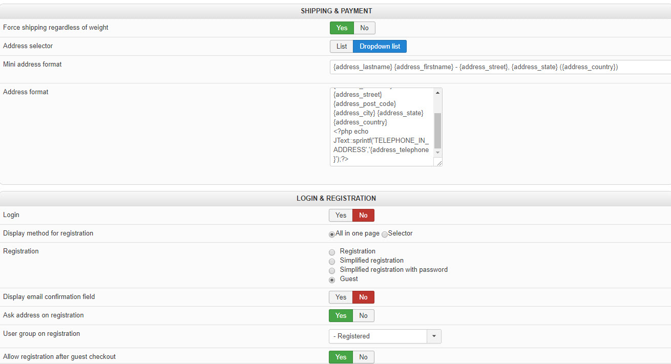

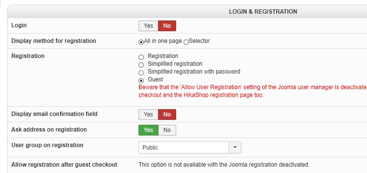

we're trying to let anyone go through as 'guest' to purchase any product but we still need their address details to know how to make contact and where to send items. Unfortunately, even though we've turned off registration, we get this message when the address of a new user is added and the 'Next' button is pressed;
Message
You cannot proceed to a guest checkout as some of the products in your cart require a registration to our website. Please register an account or remove these products from your cart in order to proceed.
I've attached out configuration setting so you can see if we've done anything wrong.

  • Posts: 86176
8 years 6 months ago #289603
You have two possibilities:
- You remove the "user group after purchase" setting of your products so that the plugin doesn't have to check that the user is logged in.
- You allow registration and login on the checkout so that the customers will be logged in when finishing their checkout for the products with a "user group after purchase" filled in.
If you want to add the users to a mailing listing user group, you don't want to use the "user group after purchase" option, especially if you've configured your checkout as guest since guests don't have a user group. Only registered users have user groups.

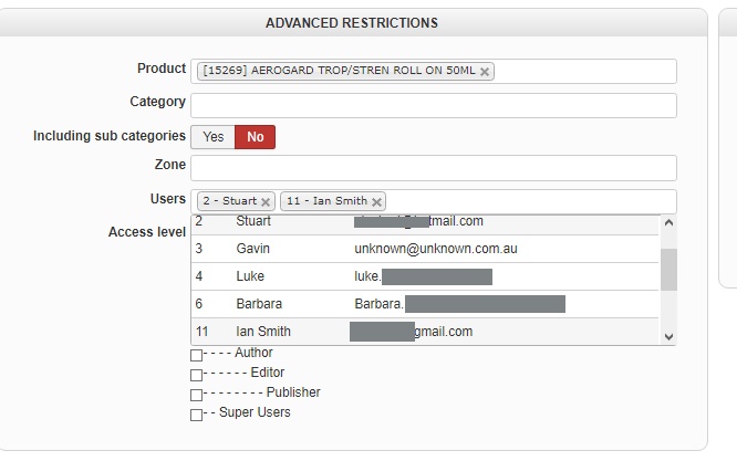

8 years 5 months ago #289764

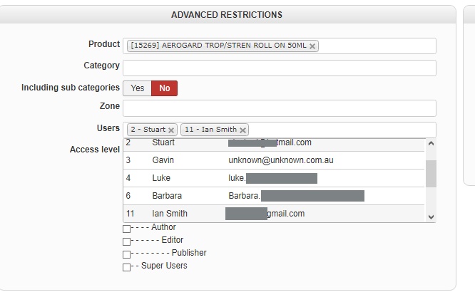

will selecting specific registered users (see image) from within the discount screen limit the discount to them? Or, will other registered users (i.e. not selected on the discount screen) also have access to the lower price?
I agree that creating new user groups is painful.
Ian and Stu
  • Posts: 86176
8 years 5 months ago #289779
The restrictions use the AND logic.
So if you set a user group and users, then the user needs to be among the selected users AND in at least one user group selected in the user group setting.
