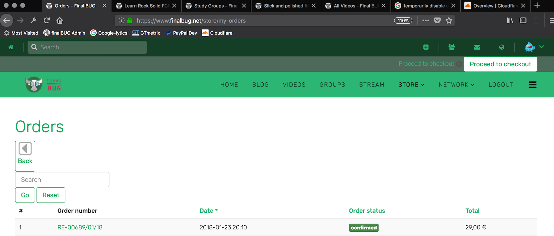

The thing is that coming back from my checkout process from Fast Spring...
i.e. after checking out I still see this button.
Is there a way to remove it after check out?

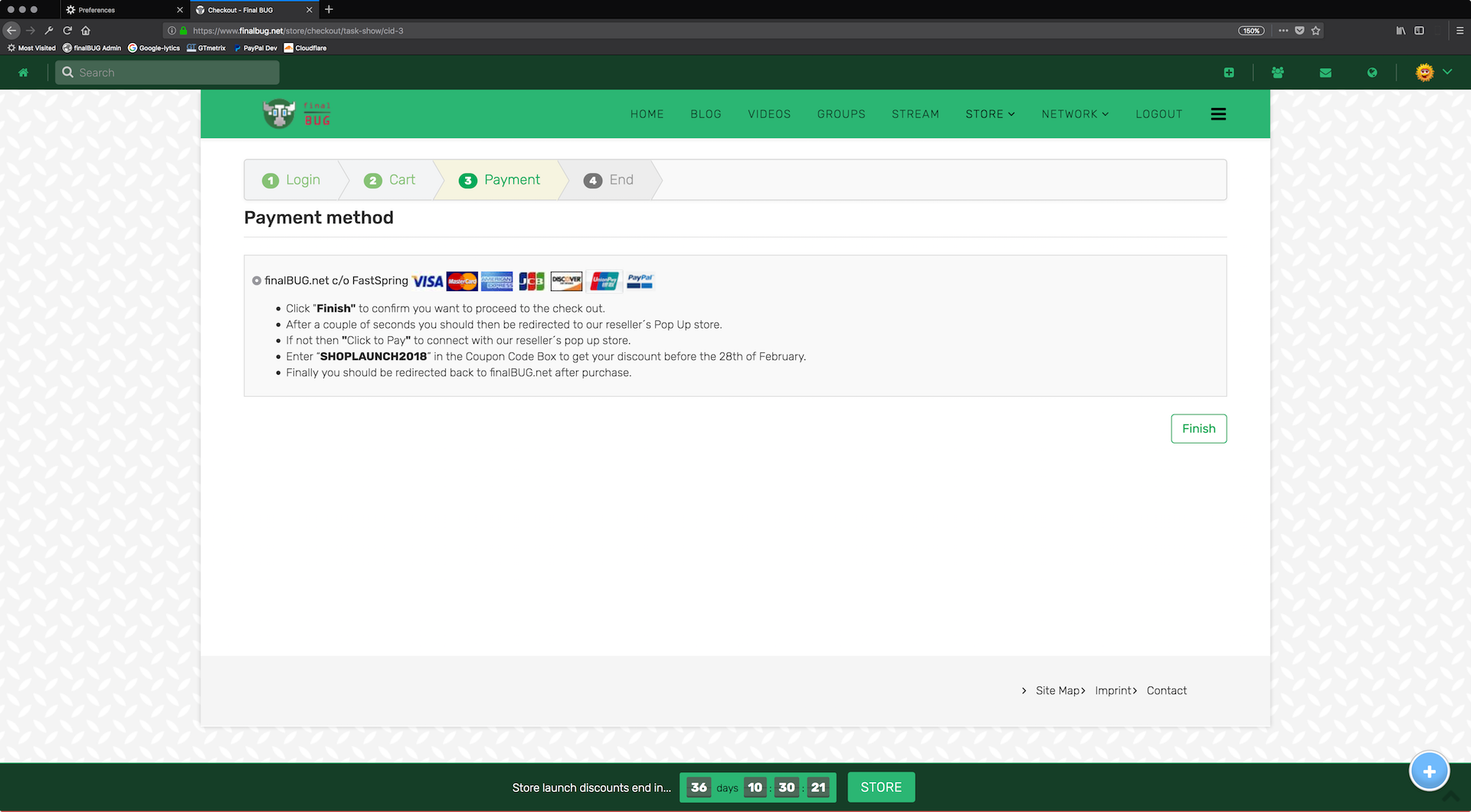

3) The module DOES NOT displays if some thing is in the shopping cart and you are in the shopping cart on your way to pay.
a) HikaShop Page types = Exclude
b) Selection has "checkout" entered.
eg:
www.mywebsite.com/store/checkout/task-show/cid-2
www.mywebsite.com/store/checkout/task-show/cid-3
