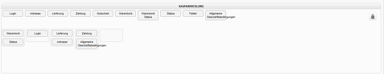

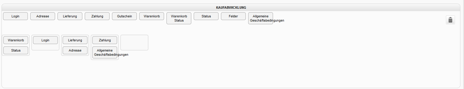

I have a problem with the checkout workflow. When I press next at the cart step I do not get to the login page. Sometimes it works, but I don't have found out yet what's the difference. I defined it as you can see in the attachments.

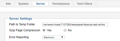

Unfortunately there is no error message. I switched to the Beez2 and the Beez5 template - both show no error message. I also turned the error reporting to the maximum as you can see in the attached screenshot and activated the debug mode.

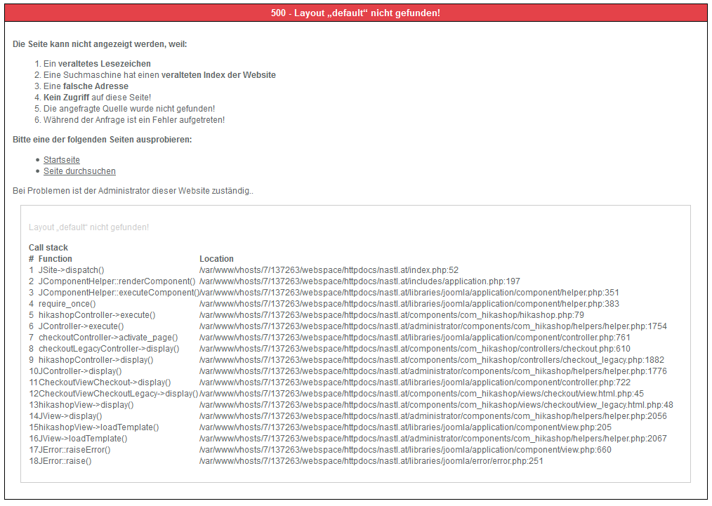

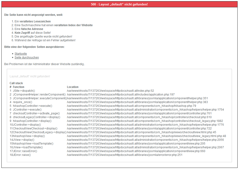

When registering with a new user (new email) there is a 500 Internal Server Error displayed. You can find a saved html file with a stacktrace in the attached files.
500 - Layout „default“ nicht gefunden!
Call stack
#		Function		Location
1		JSite->dispatch()		/var/www/vhosts/7/137263/webspace/httpdocs/nastl.at/index.php:52
2		JComponentHelper::renderComponent()		/var/www/vhosts/7/137263/webspace/httpdocs/nastl.at/includes/application.php:197
3		JComponentHelper::executeComponent()		/var/www/vhosts/7/137263/webspace/httpdocs/nastl.at/libraries/joomla/application/component/helper.php:351
4		require_once()		/var/www/vhosts/7/137263/webspace/httpdocs/nastl.at/libraries/joomla/application/component/helper.php:383
5		hikashopController->execute()		/var/www/vhosts/7/137263/webspace/httpdocs/nastl.at/components/com_hikashop/hikashop.php:79
6		JController->execute()		/var/www/vhosts/7/137263/webspace/httpdocs/nastl.at/administrator/components/com_hikashop/helpers/helper.php:1754
7		checkoutController->activate_page()		/var/www/vhosts/7/137263/webspace/httpdocs/nastl.at/libraries/joomla/application/component/controller.php:761
8		checkoutLegacyController->display()		/var/www/vhosts/7/137263/webspace/httpdocs/nastl.at/components/com_hikashop/controllers/checkout.php:610
9		hikashopController->display()		/var/www/vhosts/7/137263/webspace/httpdocs/nastl.at/components/com_hikashop/controllers/checkout_legacy.php:1882
10		JController->display()		/var/www/vhosts/7/137263/webspace/httpdocs/nastl.at/administrator/components/com_hikashop/helpers/helper.php:1776
11		CheckoutViewCheckout->display()		/var/www/vhosts/7/137263/webspace/httpdocs/nastl.at/libraries/joomla/application/component/controller.php:722
12		CheckoutViewCheckoutLegacy->display()		/var/www/vhosts/7/137263/webspace/httpdocs/nastl.at/components/com_hikashop/views/checkout/view.html.php:45
13		hikashopView->display()		/var/www/vhosts/7/137263/webspace/httpdocs/nastl.at/components/com_hikashop/views/checkout/view_legacy.html.php:48
14		JView->display()		/var/www/vhosts/7/137263/webspace/httpdocs/nastl.at/administrator/components/com_hikashop/helpers/helper.php:2056
15		hikashopView->loadTemplate()		/var/www/vhosts/7/137263/webspace/httpdocs/nastl.at/libraries/joomla/application/component/view.php:205
16		JView->loadTemplate()		/var/www/vhosts/7/137263/webspace/httpdocs/nastl.at/administrator/components/com_hikashop/helpers/helper.php:2067
17		JError::raiseError()		/var/www/vhosts/7/137263/webspace/httpdocs/nastl.at/libraries/joomla/application/component/view.php:660
18		JError::raise()		/var/www/vhosts/7/137263/webspace/httpdocs/nastl.at/libraries/joomla/error/error.php:251
Second:
When registering with a already existing user, there was no message that the user was already existing. This is missing in my template - i will fix this.
