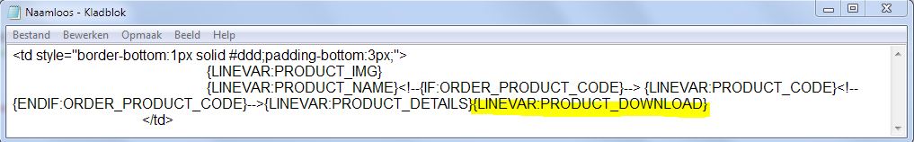

I hope you can help me with this question. Atteached you will find an image of the customer email after payment. It displays the download link to the product. I would like to add a clarifying label in front of the link. How can I do that? Thanks in advance.

The solution will be to directly edit the "HTML" code of your "" email, via "Hikashop->System->Emails" and add your clarifying label just before :
{LINEVAR:PRODUCT_DOWNLOAD}

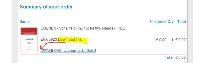

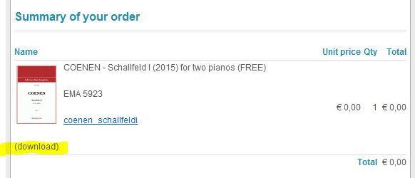

  • Posts: 56
8 years 7 months ago #288017
Hi Mohamed,

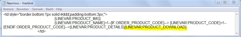

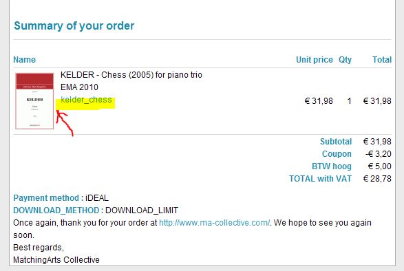

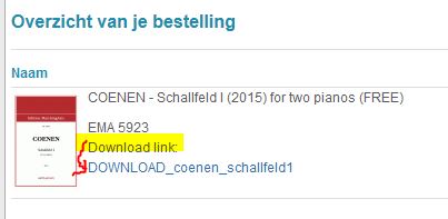

Thanks for your answer. However, I can't seem to get it right. My added label appears either before or after the download link and there is a CR somewhere. I added my code (not modified) and two examples of emails.
I would like to have: "Download link: link".
Thanks in advance.
Kind regards,
Hans

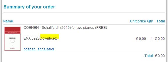

8 years 7 months ago #288018
In that case you should just change that line :
By:
Download link: {LINEVAR:PRODUCT_DOWNLOAD}
  • Posts: 56
8 years 7 months ago #288074

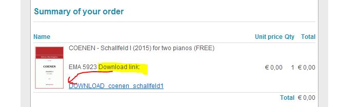

That's what I tried before, but that is not going to work (see attachment). It's the CR somewhere causing this issue. Hope you can solve this.
Thanks in advance.
Hans

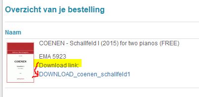

  • Posts: 1119
  • Thank you received: 114

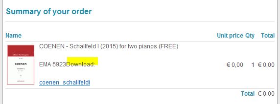

8 years 7 months ago #288076
Have you tried to add <br/> tag before? It should move it down to the new line. Like this:
<br/>Download link: {LINEVAR:PRODUCT_DOWNLOAD}

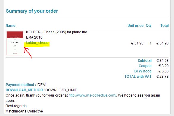

  • Posts: 56
8 years 7 months ago #288087

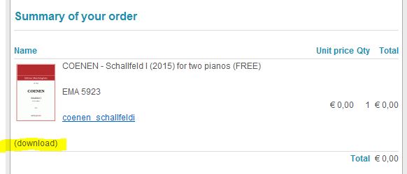

Please have a look at the attachment to see how this works out...
Kind regards, Hans

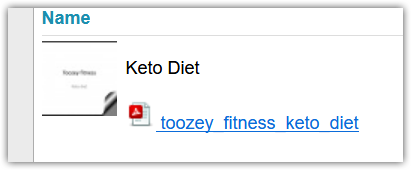

  • Posts: 306
  • Thank you received: 42
  • Hikamarket Multivendor Hikaserial Standard Hikashop Business
8 years 7 months ago #288108
I have done something similar. All my downloads are pdf's so I added a pdf icon before the download link in the preload version around lin 245:
$t .= '<a href="'.hikashop_frontendLink('index.php?option=com_hikashop&ctrl=order&task=download&file_id='.$file->file_id.'&order_id='.$oid.$file_pos.$url_itemid).'"><img src=". . ./pdf.png"> '.$fileName.'</a><br/>';
The following user(s) said Thank You: hans1961
  • Posts: 56
8 years 7 months ago #288113
Yes! This helped to achieve what I want.
Many thanks and kind regards,
Hans
