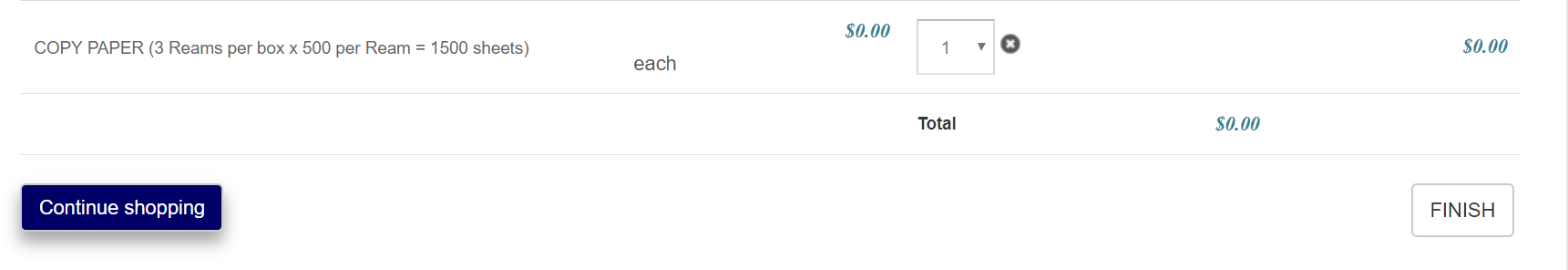

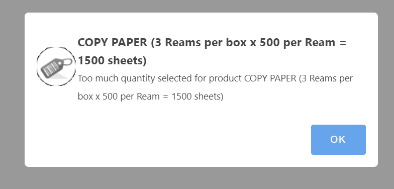

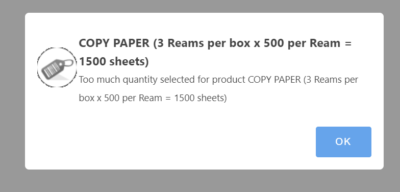

Users are not able to see a jquery popup as a registered user. If I give them super user rights they are able to see it as they should. This is causing problems with limits being set. Without the popup it will still allow them to add the product and checkout.
This image shows it working correctly when logged in as super user or admin.

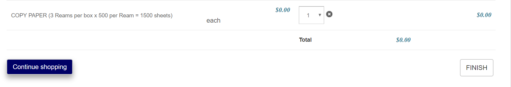

This image shows how it works with them logged in as a registered user only. I do not get the popup and it doesn't check the limitations set under Limits.
Checkout still allows the order to go through.
