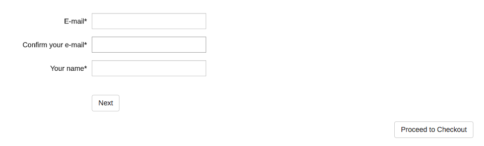

How can I change the order of fields on the checkout Guest Registration screen?
FROM:
Email
Confirm email
Name
TO:
Your name:
Email:
Thanks!

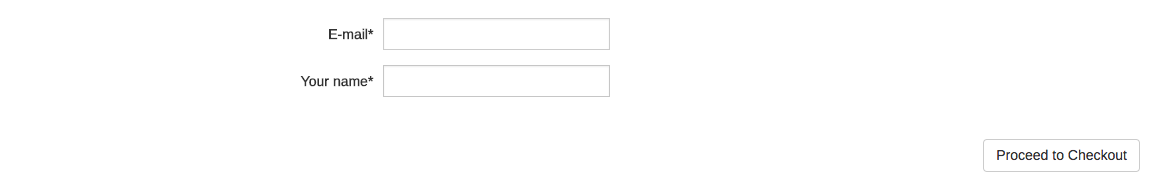

I had a little difficulty following the instructions but I think I finally got it. Thanks.
I can see that in checkout / sub_block_login_registration.php name is listed first.
...	<input type="text" name="data[register][name]" id="register_name" value="<?php echo $this->escape($this->mainUser->get( 'name' ));?>" class="hkform-control" size="30" maxlength="50"/> ...
...			<input<?php if($this->config->get('show_email_confirmation_field',0)){echo ' autocomplete="off"';} ?> type="text" name="data[register][email]" id="register_email" value="<?php echo $this->escape($this->mainUser->get( 'email' ));?>" class="hkform-control validate-email" maxlength="100" size="30" />
but for some reason, I get E-mail block on top of it. I added "Your Name" (table user, column name, type text).
I'm missing something obvious. Any pointers would be helpful. Thanks.

8 years 5 months ago #290856
The name field isn't displayed by that code. That name field is only displayed when your checkout is configured to accept registrations as that information is stored as the name of the user account in Joomla.
But on your checkout, you have it configured in guest mode.
No, the name field on your checkout comes from the custom field of the table "user" that you've created.
So it is actually displayed by that block of code:
$type = 'user';
if(!empty($this->extraFields[$type])) {
	foreach($this->extraFields[$type] as $fieldName => $field) {
	<div class="hkform-group control-group hikashop_registration_<?php echo $fieldName;?>_line" id="hikashop_<?php echo $type . '_' . $this->step . '_' . $this->module_position . '_' . $field->field_namekey; ?>">
		<?php
			$classname = $labelcolumnclass.' hkcontrol-label';
			echo $this->fieldsClass->getFieldName($field, true, $classname);
		<div class="<?php echo $inputcolumnclass;?>">
<?php
		$onWhat = ($field->field_type == 'radio') ? 'onclick' : 'onchange';
		echo $this->fieldsClass->display(
				$field,
				@$this->$type->$fieldName,
				'data['.$type.']['.$fieldName.']',
				false,
				' class="hkform-control" '.$onWhat.'="hikashopToggleFields(this.value,\''.$fieldName.'\',\''.$type . '_' . $this->step . '_' . $this->module_position.'\',0,\'hikashop_\');"',
				false,
				$this->extraFields[$type],
				@$this->$type,
				false
		</div>
	</div>
<?php
The following user(s) said Thank You: Hikarioo
  • Posts: 50
8 years 5 months ago #290901
OMG I think sorta understand it thanks to your great explanation. :-) Wow. Thanks for taking the time. I appreciate you!
