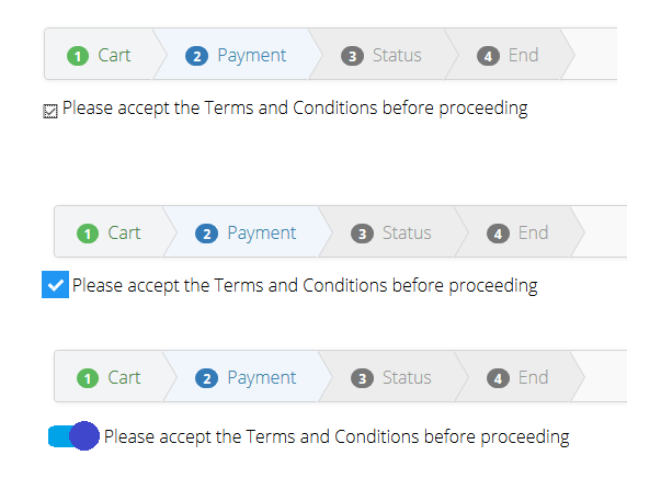

Sorry to bother again, I have three Questions.
1. Is it possible to customize the the T&Cs check box and if so what class do I need to edit
2. Is it possible to add a second checkbox (one to accept T&Cs the other to accept our Privacy Policies)
3. Is it possible to link the T&Cs to a PDF instead on an article
Last edit: 8 years 3 months ago by SnoozeULooze.co.za.
  • Posts: 85952
  • Thank you received: 14142
8 years 3 months ago #290815
1. Sure, you can do that with CSS.
You can easily find the class to use with your browser's developer tool as we explain here :
Its the class hikashop_checkout_terms_checkboxfor the checkbox.
2. Yes. Just add a second Terms & Condition view to your checkout workflow and in its settings select another Joomla article and enter another label.
3. There is no option for that. If you want to do that, you would have to edit the file "show_block_terms" via the menu Display>Views and add custom code to it for that.
