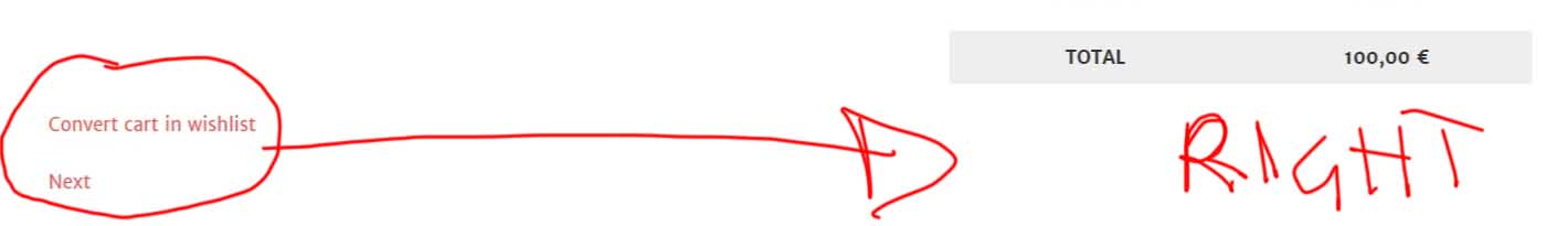

Ho can I move the NEXT button and also the Convert cart in wishlist button, on the right?

I've identified these lines:
class="hikashop_cart_button" id="hikashop_checkout_next_button"
class="hikashop_cart_button" id="hikashop_checkout_shopping_button"
I add:
a.hikashop_cart_button {
text-align: right;
But nothing is changed

Your CSS is not correct.
Your CSS will move the text of the button to the right inside the button.
Try with that instead:
float: right;
However, that's just part of it. This might have other implications and affect other buttons or it might not be that element on which you need to apply the float, or it might require some other kind of CSS code.
