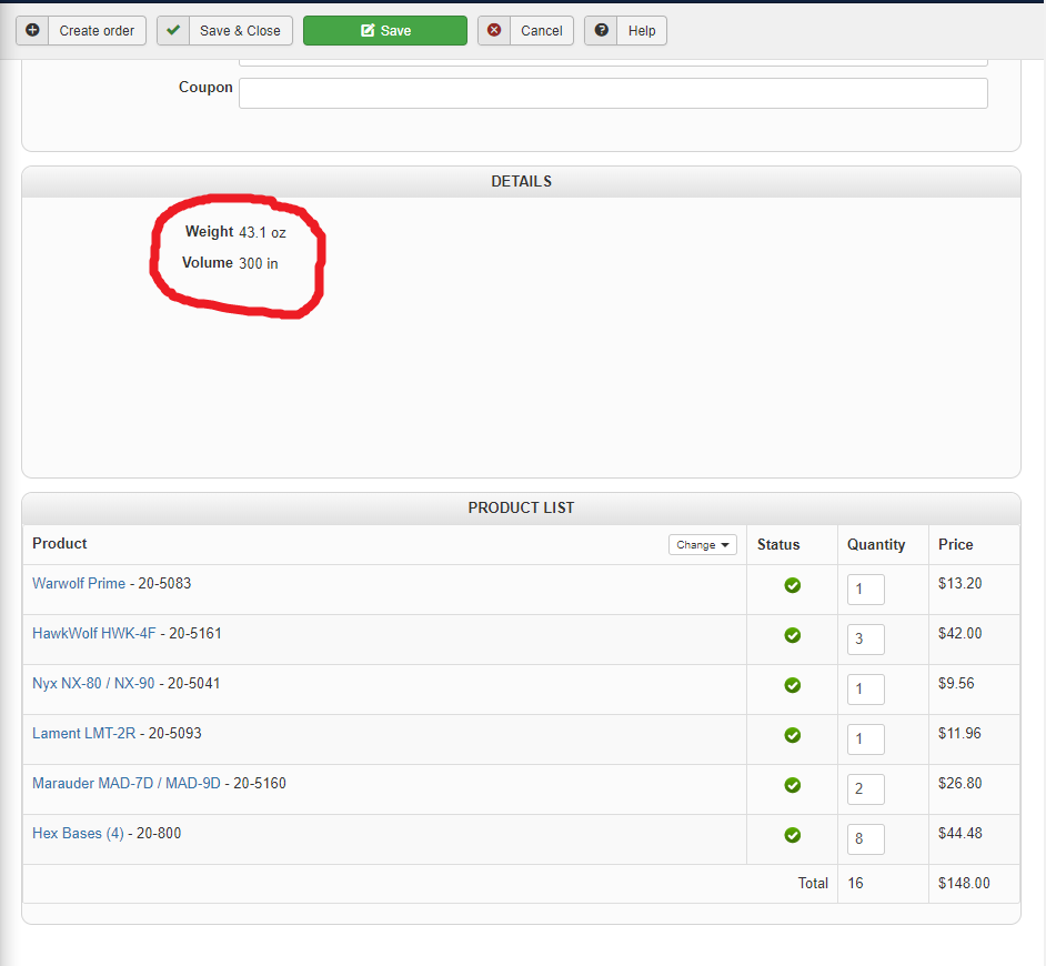

So, even before I updated to the most recent version of HikaShop, every so often I noticed a shipping charge that was just WAY off and I would have to refund some money back to people (I think it's criminal to keep this as it's not right).
Today I've finally figured it out. If you look at the attached image, the volume for the items in the cart is 300 inches. How can this be correct? Perhaps it is...in a 2 dimensional world...but we all know shipping takes place in boxes, so I can stack some of this on top of the others.
Each of these products are in the exact same blister packing. They measure 3in wide x 5in long x 1.25in high.
Is there maybe a setting I don't see or understand that could help in correcting this issue?
Thank you very much

I've chekced that every time, and they are listed properly at their correct measurements.. All products are physical, so I have them in hand, none are virtual...and it only happens every so often, like maybe 1 tieout of 10...but it scares the heck out of the customer when it does because shipping is so much they refuse to pay.

Thank you Mohamed. If you need exact weights for each of those listed items, please let me know...I'll get them for you.
As I added them in the order shown...when I got to the last ones (20-800 Hex Base)...if I put 5 or less in the cart...shipping was right. Once I put 6, 7 or 8...shipping was double what it should be and what USPS actually charged...so something is definitely going on.

Sure thing...in order as shown on the image
Warwolf Prime - 20-5083
This product is 1.8oz per blister...customer purchased a total of 1 blisters
HawkWolf HWK-4F - 20-5161
This product is 3.4oz per blister...customer purchased a total of 3 blisters
Nyx NX-80 / NX-90 - 20-5041
This product is 2.2oz per blister...customer purchased a total of 1 blisters
Lament LMT-2R - 20-5093
This product is 2.5oz per blister...customer purchased a total of 1 blisters
Marauder MAD-7D / MAD-9D - 20-5160
This product is 3.2oz per blister...customer purchased a total of 2 blisters
Hex Based (4) - 20-800
This product is 2.5oz per blister...customer purchased a total of 8 blisters
Each blister dimension is the same. 5in x 3in x 1.25in
Ship from Zip Code is 53406. Ship to Zip Code is 98101
Last edit: 8 years 5 months ago by Dragon41673.

8 years 5 months ago #291314
We just tested it with the "20-800 Hex Base" product and here is information that are sent to the USPS platform when you have 8 products on your cart :
<?xml version="1.0"?><RateV4Request USERID="XXXXXXXX"><Revision /><Package ID="1"><Service>PRIORITY</Service><ZipOrigination>53406</ZipOrigination><ZipDestination>98101</ZipDestination><Pounds>1</Pounds><Ounces>4</Ounces><Container>VARIABLE</Container><Size>Regular</Size><Width>5</Width><Length>10</Length><Height>3</Height><Girth>26</Girth><Machinable>false</Machinable></Package></RateV4Request>
And here is information that are sent to the USPS platform when you have 9 products on your cart :
<?xml version="1.0"?><RateV4Request USERID="XXXXXXXXXX"><Revision /><Package ID="1"><Service>MEDIA</Service><ZipOrigination>53406</ZipOrigination><ZipDestination>98101</ZipDestination><Pounds>1</Pounds><Ounces>4</Ounces><Container>VARIABLE</Container><Size>Regular</Size><Width>5</Width><Length>10</Length><Height>3</Height><Girth>26</Girth><Machinable>false</Machinable></Package><Package ID="2"><Service>MEDIA</Service><ZipOrigination>53406</ZipOrigination><ZipDestination>98101</ZipDestination><Pounds>0</Pounds><Ounces>2.5</Ounces><Container>VARIABLE</Container><Size>Regular</Size><Width>3</Width><Length>5</Length><Height>1.25</Height><Girth>13.5</Girth><Machinable>false</Machinable></Package></RateV4Request>
Which means that the USPS shipping plugin had to "send" 2 packages instead of 1 so that it won't exceed USPS package limitations, that's why the price nearly "doubled".
A solution can eventually be to set the "Use product dimension" to NO, through your USPS configuration page.
Best regards,
Mohamed Thelji.

Mohamed...thank you. I swear I had tried that before, and there was an issue with a product or two on my site being undercharged, but I just tested it right now on multiple products, and it seems to be working. I'll continue to test it until I'm as confidant as I can be that this is the resolution and push it live if there's no issues.
Thank you very much!
