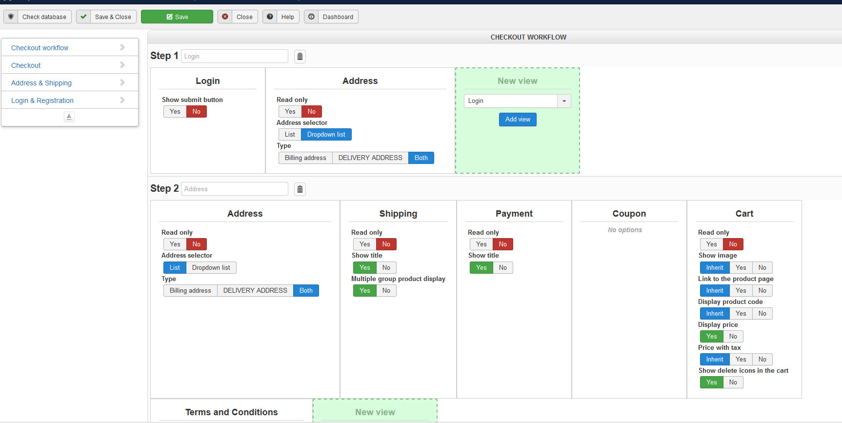

By the way, maybe you can use the new Checkout Workflow to have 2 differents address fields (1 for Shipping & 1 for billing) the both have to be completed to continue Checkout process, see my screenshot :

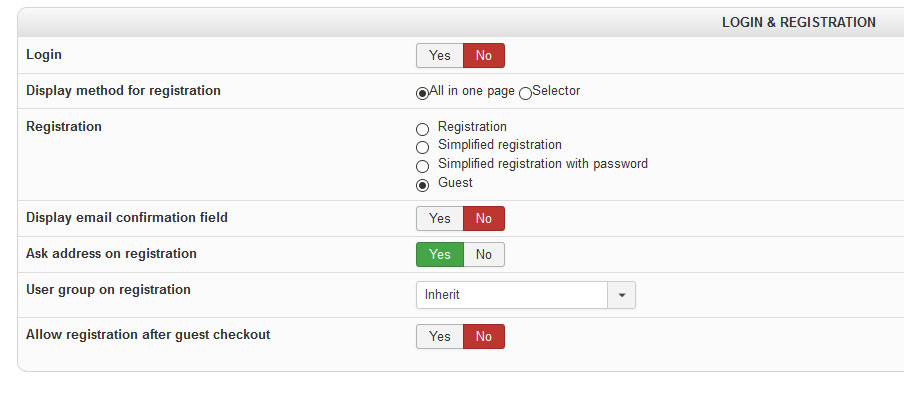

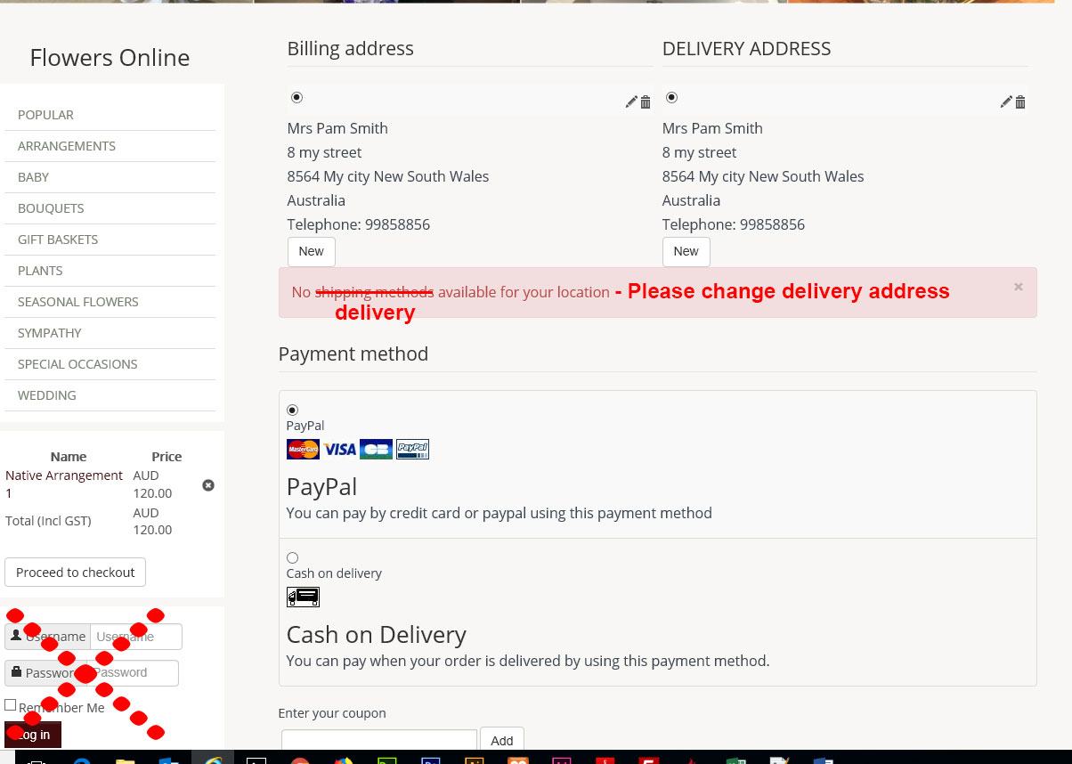

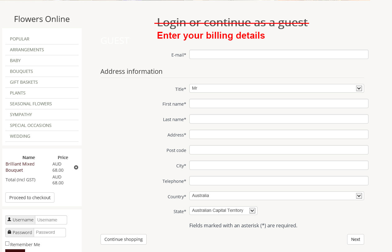

I have tried different options based on your information below and I think I have managed to come up with a workable solution. I am testing the setup on my localserver. I have attached images of the configuration and two of checkout step from that setup, I will also have to edit the language file as per sample images.

8 years 3 months ago #292690
Hello Lene,
As you can see through Philippe's screenshots, you should actually should choose for each address step if you want them to be shipping or billing address selection.
