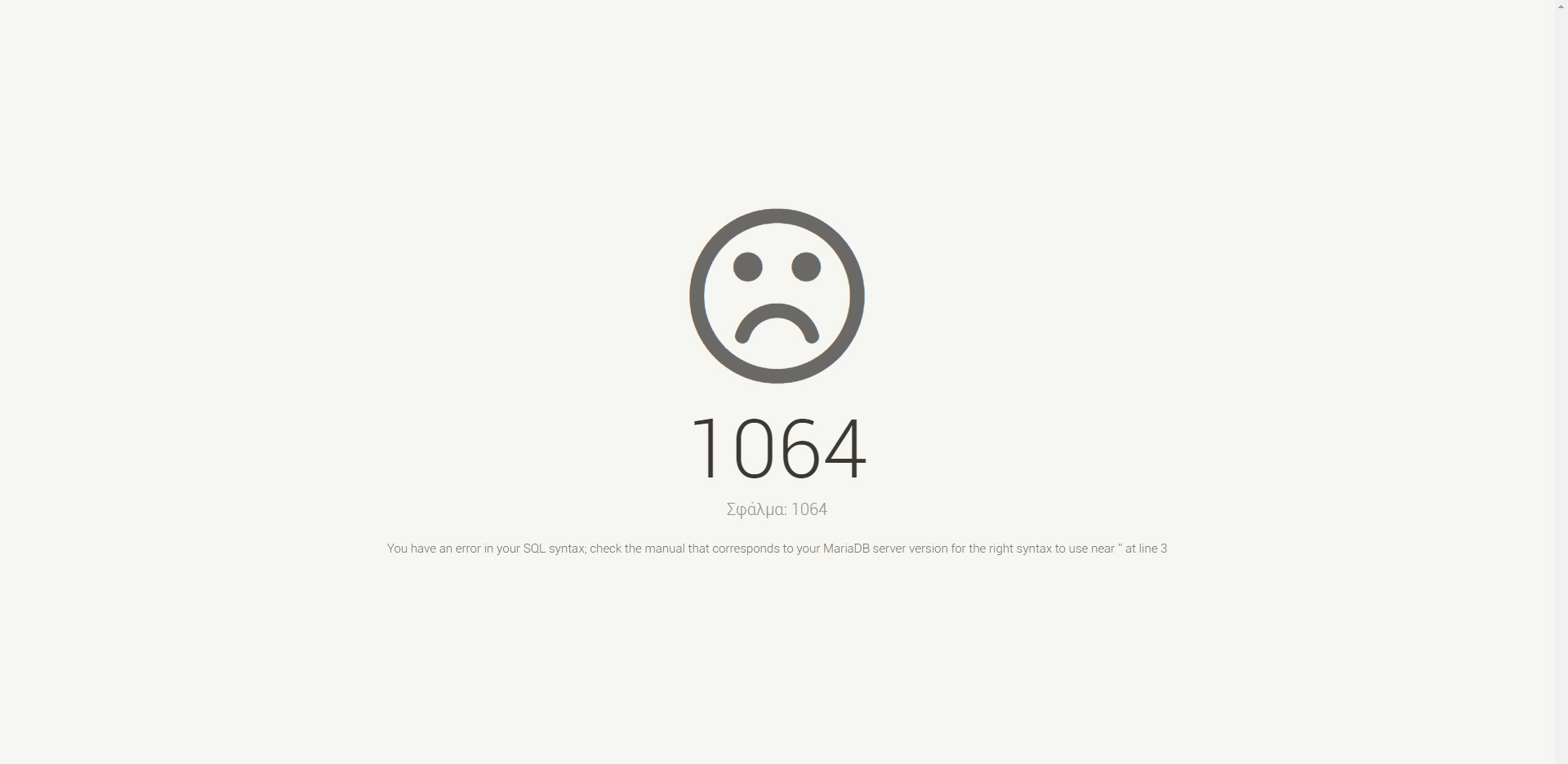

after updating to latest version of hikashop, i sometimes get this error when i click on finish at the chekcout page:

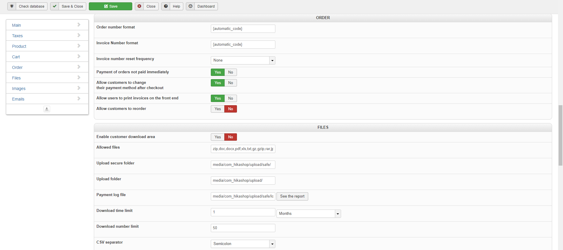

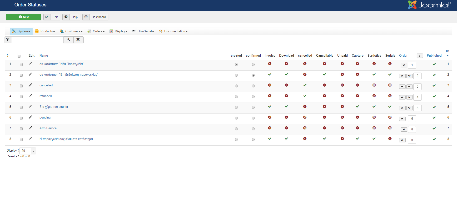

Regarding the quantity issue, could you provide a screenshot of the settings of that product ?
Could you also provide a screenshot of the System>Order statuses menu and of the "order" section of the HikaShop configuration so that we can get a better understanding of the situation ?

it's not one specific product that has that problem, if it helps i can send you credentials to check.
Here are the screenshots you asked

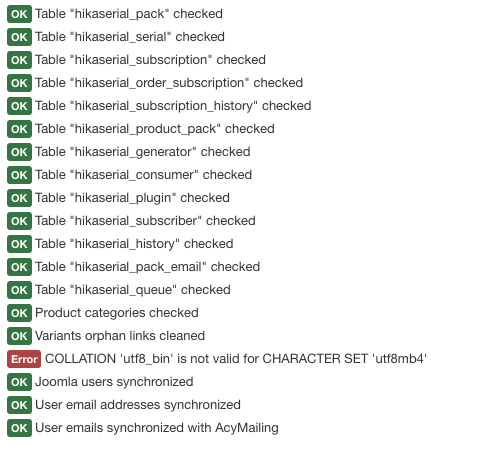

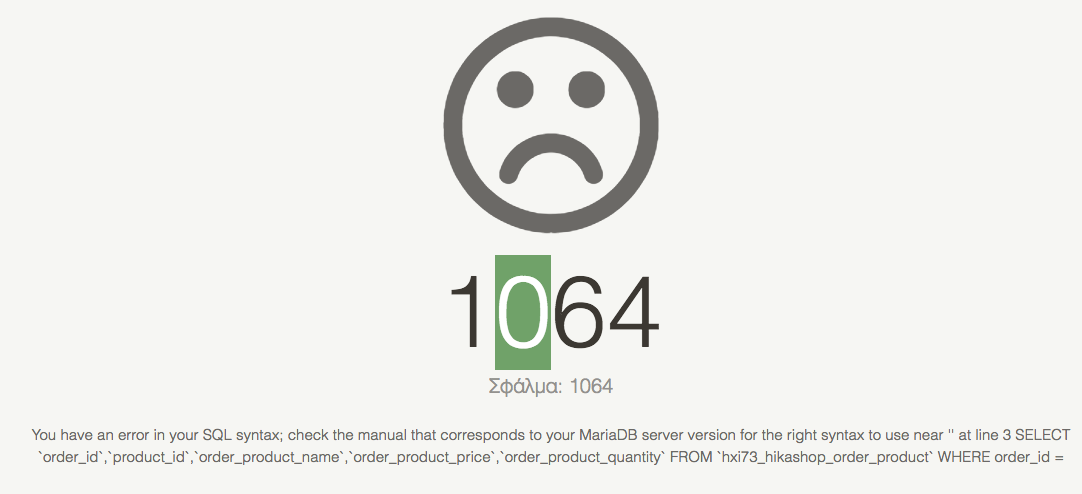

8 years 3 months ago #294206
HI!
ALSO 1 error in db
Last edit: 8 years 3 months ago by verzevoul.
  • Posts: 86216
  • Thank you received: 14222
8 years 3 months ago #294214
I've searched in HikaShop, HikaMarket and Hikserial and I can't find such MySQL query.
So this must come from a plugin, either third party, or custom.
I would recommend to disable the plugins of the group "hikashop" and "system" via the Joomla plugins manager one by one and test each time in order to find the culprit. If you've developed your own plugins or added 3rd party plugins, I would start with them.
