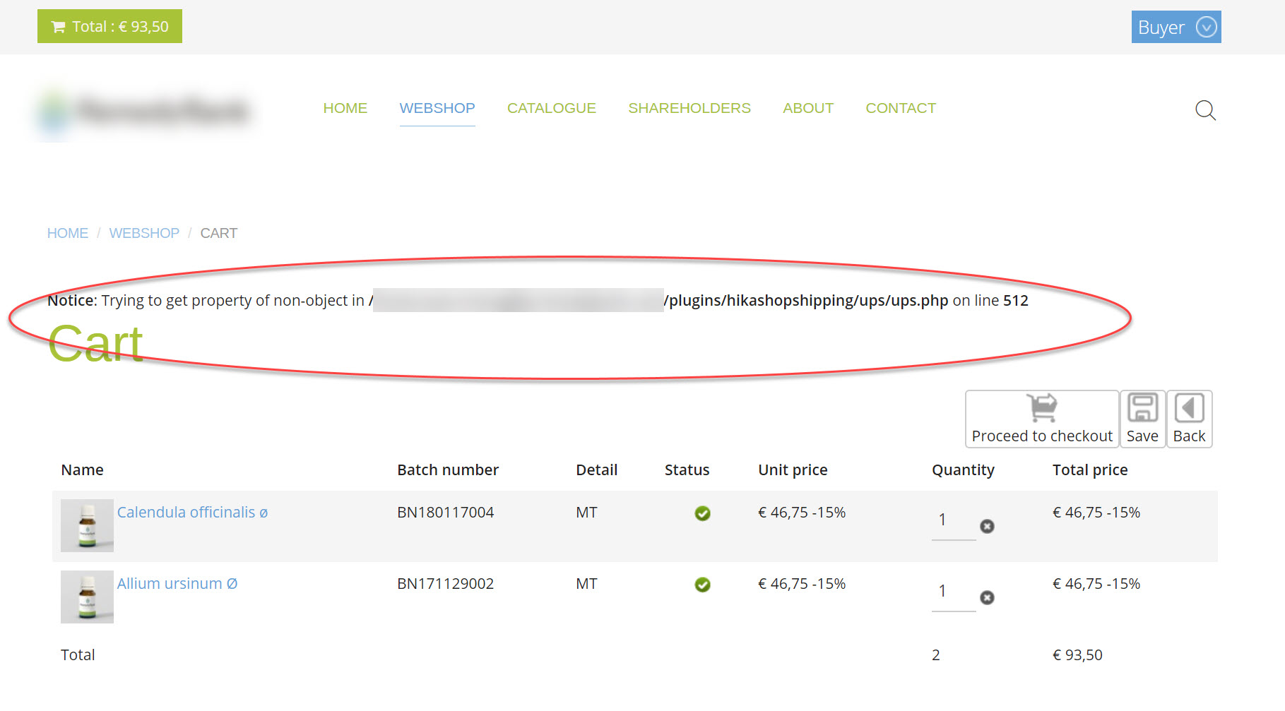

Hi Hikashop team,
Do you know why we get this error when we go to the cart page after we create a cart on the back-end for our test customar.
After a refresh the notice was gone:
............./plugins/hikashopshipping/ups/ups.php on line 512
Kind regards,
Lumiga

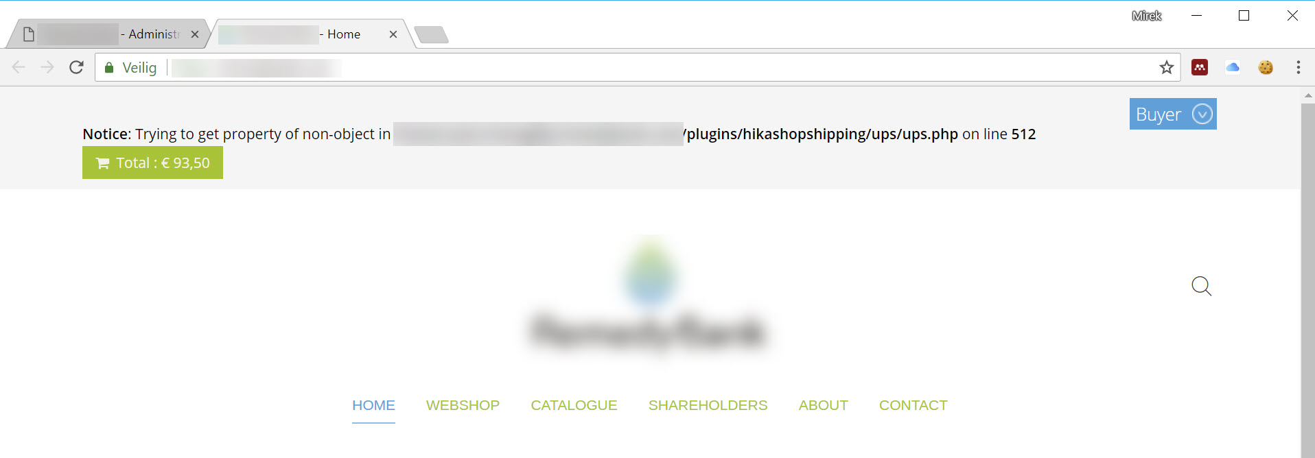

  • Posts: 637
  • Thank you received: 26
8 years 3 months ago #293004
I also get this error where we put the mini cart (on hover)
Kind regards,
Lumiga

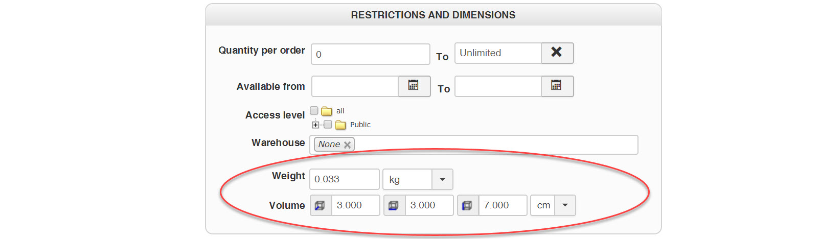

Update: When we delete the Weight and Volume the issue is solved.
So there is no notice error anymore and also the cart notification popup is showing up.
So it has something to do with the Dimension!!! I think.
We use kg and cm. See screenshot

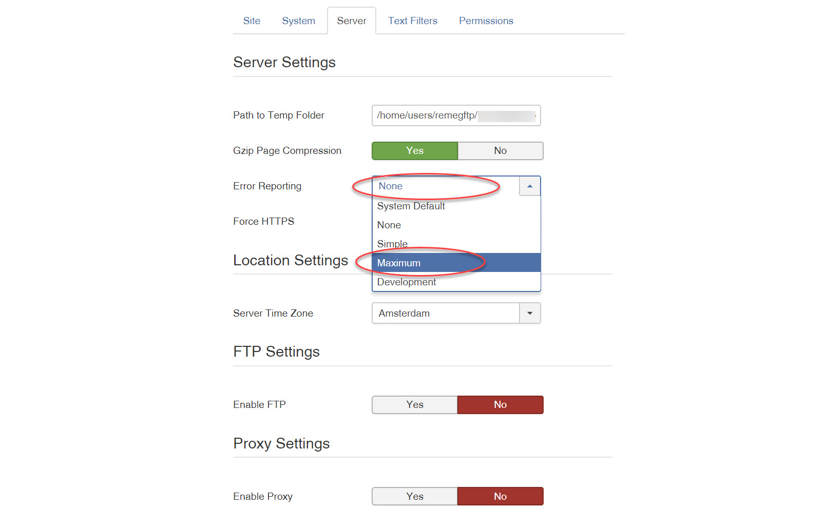

8 years 2 months ago #293731
Hi Mohamed,
I think I found the issue.
When I turn the Error Reporting from MAXIMUM to NONE the issue was solved.
Kind regards,
Lumiga

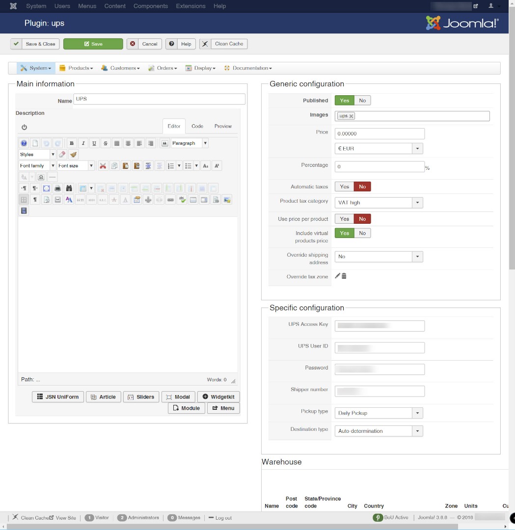

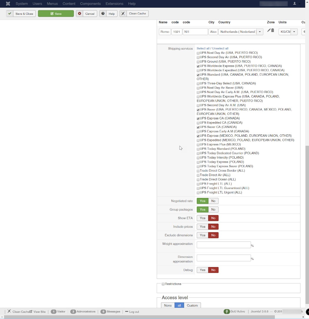

8 years 2 months ago #293733
I still wasn't able to reproduce it on my end, can you show us some screenshots of how you configured your UPS shipping method via "Hikashop->System->Shipping methods" ? Thank you.
Best regards,
Mohamed Thelji.
  • Posts: 637
8 years 2 months ago #293739
Kind regards,
Lumiga
