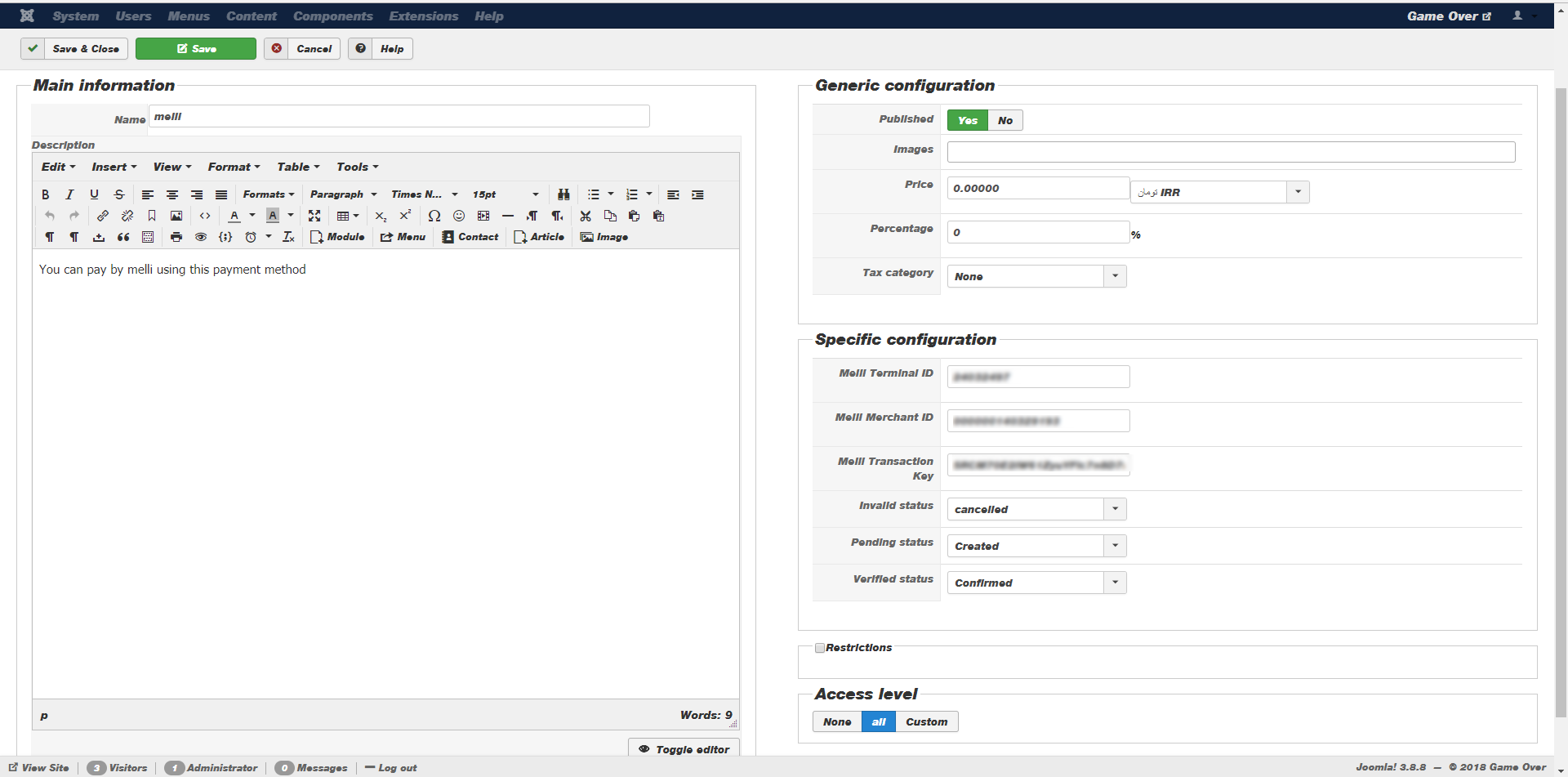

I ordered someone else to write the plugin to connect Hikashop to my bank. [Because my bank doesn't have plugin for connecting to the Hikashop]
I received the "Terminal ID", "Merchant ID" and "Transaction Key" from my bank. I've entered them into the Paymetnt Method. [screenshot attached]
I go to the front-end and add a product to card, after that I go to checkout to pay the meoney[Redirect to the bank page], but says "this page couldn't find".
Is anything that I missed it?! or the problem related to the plugin?!
