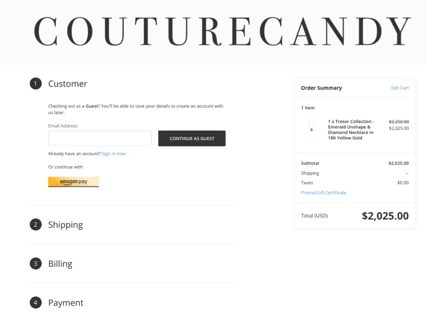

can you please guide me where i can modify the layout of the cart view in the checkout.
i would like to make it appear in the right side like my example.
thank you.

It will be simpler to remove the "cart" block from your checkout workflow and then configure and enable the HikaShop cart module via the Joomla modules manager to be positioned on the right side bar during the checkout.
That way, you won't have any coding.
If you want to edit the views of the checkout (or any other views), I would recommend reading this tutorial which explains how to find which view file to edit and how to edit it in HikaShop:

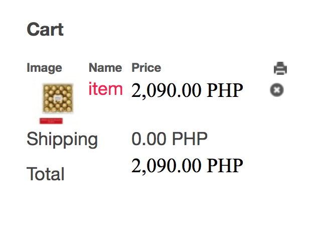

1. would it be totally ok if no cart view on the checkout process and only display it on the module? i mean no technical issue?
a. How can i remove the image, name and price or cart title in the module?
b. can increase the size of the image? i tried using css and the image is blurred

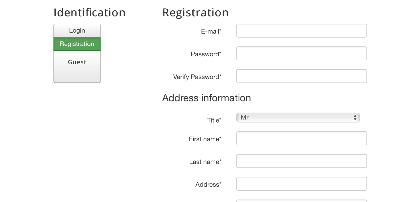

3. can you please tell me where to customise the selector? how can i make the content of the selector appear under the selector? just like the normal tabs.

a. Using options from the "Hikashop Options" tab of the cart Joomla module.
b. Using the "Thumbnail (width x height)" and "Force image size" options via "Hikashop->System->Configuration->Main"

this did not work, i already set the thumbnail to 200X300 force image size . just to clarify this is the one that i want to change. i want to change the image size to 200X300. Also how to remove the titles image, name and price.this is the cart module

i want to change the selector layout into tabs layout. How can i change this so that clicking one tab will display the fields below it and not on the right side. in the screen shot clicking a button will display the fields on the right. i want it below the buttons. CAn you tell me what to do? which file to edit?

b. You need to edit the file "cart" of the view "product" and change the height/width set there when calling the function to generate the thumbnail.

3. You'll have to customize the file "show_block_login" via the menu Display>Views. CSS will also help.
