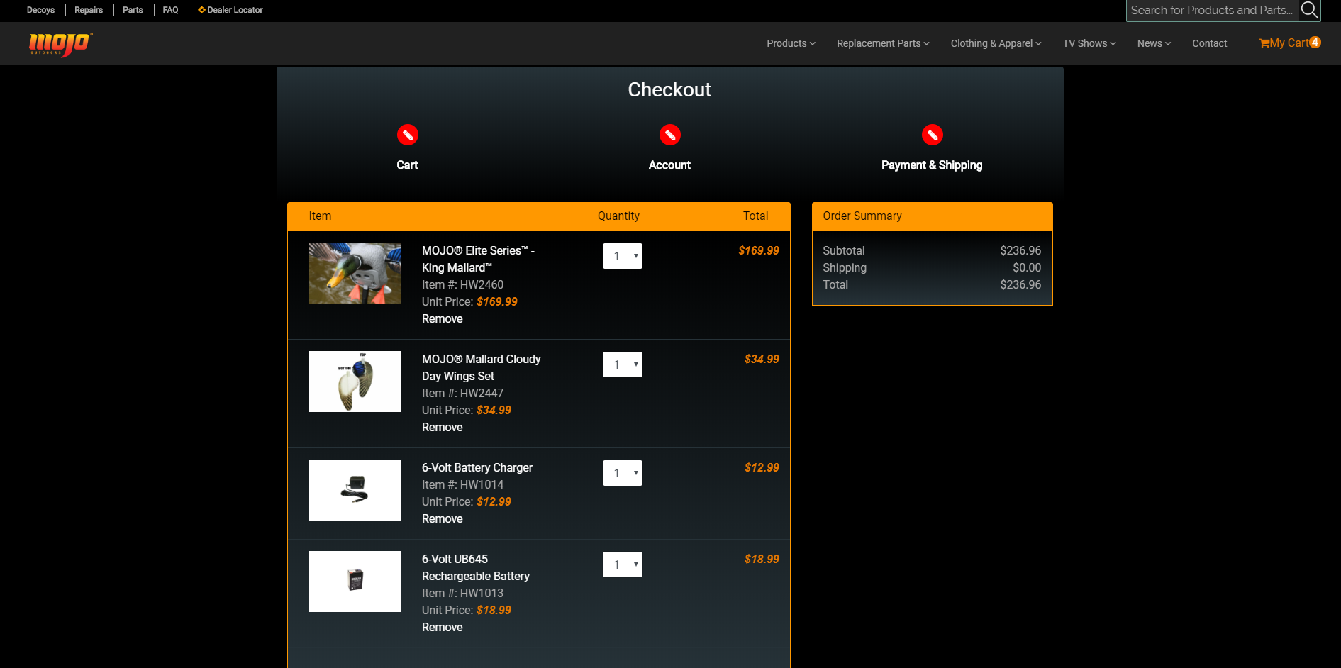

I created this little order summary view in the "checkout / show_block_cart.php" view that you can see in the screenshot below:
However, I am trying to figure out a way to display the order summary only (not the full cart) on every page of the checkout. I would assume I could accomplish this by adding it to the "checkout / show.php" file. I tried this and it displays the block, but not the cart information. How would i display the order information on any arbitrary view file?
Or rather, is there a better way of accomplishing this by maybe adding a new view to the checkout process? Any help or advice would be greatly appreciated!

I think the only way for you is to have cart view for each step which will be set to read only via checkout configurations. Then you would have to modify show_block_cart.php view and use such code inside:
As example this will add col-md-3 (if you are using bootstrap 3) class if cart is set to read only:
<?php if(!empty($this->options['status'])) echo 'col-md-3';?>
You also can wrap and hide content like this:
<?php if(empty($this->options['status'])) { ?>
..Your code here which you would like to hide...
<?php } ?>
I won't go into deeper explanations but this is easy job if you have some php/html skills.
Hope that helps.
The following user(s) said Thank You: nicolas, mojooutdoors-holden
  • Posts: 303
  • Thank you received: 18
8 years 1 month ago #295434
Exactly what I was initially thinking to do. However, I am not sure how to hide certain elements based on the current step. For example, if I wanted to hide a div on step 2 of the checkout, what is the php entry that corresponds to the current checkout step?
  • Posts: 303
8 years 1 month ago #295435
After playing around with it, I was able to get it working (at least the hide/unhide) with the read-only trick. I should be able to alter the display now to make it show on every page. Thank you!
